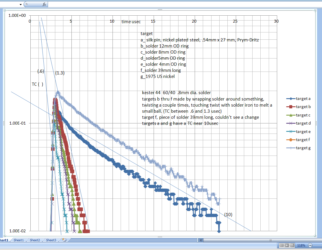

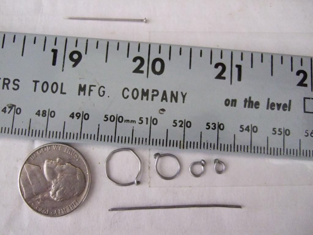

          Hi Dan
          I posted some solder targets awhile back. The solder targets have a short TC. I don't think a solder connection would effect detecting small nuggets. Try soldering two short pieces of your coil wire together and see if you can detect it. If you can tape it to your coil and see if it effects the detection distance of your gold targets. I'm with you, if you put enough stuff near the coil it will.

                  Hi Dan
                  Hi Green,
                  I just ran a test using two 3/4" pieces of scrap 24 AWG 600 volt PTFE coil wire soldered together using 1/4" of their length for the clean and minimal solder joint. This target is in the shape of a 'T' with the 1/4" solder junction as the midpoint or vertical part of the 'T' and is not a closed loop. My modified CHANCE PI detector set at 8us delay sees this sample repeatedly
                  at 1 1/4" for first detection and at 7/8" for repeatable full tone lockup. This is using my 4" X 12.5" 3:1 fast spider wound oval coil. This target response/distance is significantly stronger than the response I recently posted for some placer flakes (largest one 0.95 grain) I documented in the CHANCE PI COIL thread. Granted this is just an air test and results may be much reduced over actual soil. As far as taping the sample target to the coil it was not done because the coil would not operate at the 8us delay setting if the sample was any closer than 1 1/4".

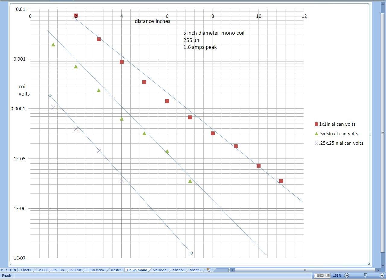

                          • Originally posted by baum7154 View Post
                            Hi Tinkerer,
                            After reading the 'Rule of Thumb' above I did a bit of calculating on the smallest target detectable with my round 8" fast spider coil. The actual diameter to the centerline of the coil is 7.7" and this gives an included area of 46.56 square inches within the coil perimeter.
                            Using a 1/4" X 1/4" (1/16 of a square inch) square target cut from a 0.004" thick aluminum soda can this target is repeatably detected at the coil center with solid tone lockup at a distance of 2.75" in air presented flat to the coil. The detector used in this test is a modified Chance PI detector with a 2 stage amp in the front end.
                            The 1/4" X 1/4" target is 46.56/ 1/16 =745 or 1/745th (.134%) of the coil area.
                            1% of the 46.56 area would be 0.4656 sq. in. and the most similar target I have tested is a .5" X 1" in piece of 0.004 soda can aluminum. This target is easily detected at coil center with full tone lockup at 7" in air.
                            Target thickness definitely affects detection too so perhaps the rule of thumb only applies to extremely thin sub .001" thick foil targets.
                            Dan
                            Dan, thank you for the feedback.
                            The rule of thumb mentioned above, is at least 10 years old, but seems to be the only information publicly available. This shows that detectors have evolved a lot and that your modified Chance PI is a very good detector.
                            It would be interesting to do a bit more calculations.
                            For example: with a 1/4" square target, at 2.75" from the coil, what is the field or flux density inciding on the target? What I mean to say, you have 46.56 square inches of coil area.
                            What is the peak coil current?
                            How many turns?
                            ...Amps x ...turns is your field strength.
                            Divide this field strength by the TX coil area 46.56, is your field density per square inch, divide by 16 is the field incidence on the 1/4" square target.
                            At the distance of about half coil diameter, the field strength is about 15 less, so the target should have about 15 times more surface area for the same response.
                            These are just "ball-park" figures off the top of my head, of course there are proper formulas to calculate all this.
                            Thickness of the target: There is something of a corner response where the target thickness is up to one skin depth, governed by the Skin effect. Thinner targets behave one way, thicker targets behave an other way. This could be the subject of another interesting discussion.
                            All the best
                            Tinkerer

                                Was looking at a chart I posted awhile back. The .5in x .5in target has an area of about 1.25 percent of the coil area. Maybe the general rule is for the center of the coil at a distance of the coil diameter.
