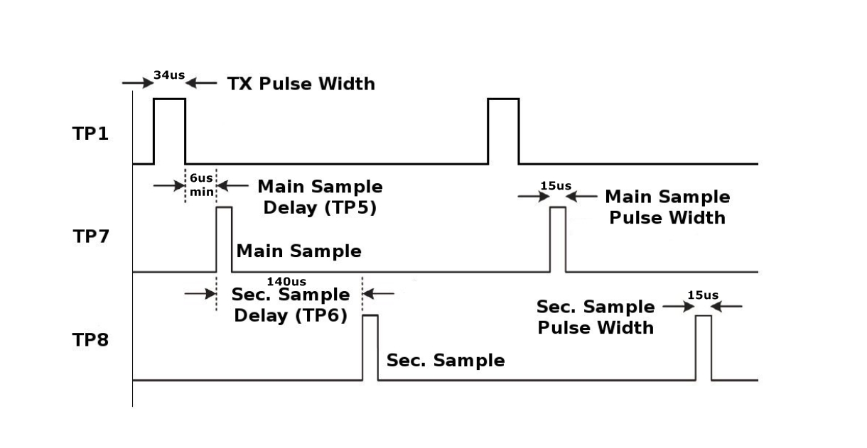

                Thanks for the reply. Changing the sample time effects the integrator response time. Somewhere I think I saw a schematic with a pot across U8B pins 6 to 7 to adjust response time. Does your MPP have one or isn't it needed?
                  You can change the TC of the integrator by changing 56K resistor value, 56K-300K.
                  The trimmer you probably have seen in the Superscan schematic which is almost identical.
                    Not sure of U8B, I only see U8. But, as far as trimmers go, I did mod R7/R8 with trimmers and also R10/R11 so I can adjust the main tx pulse along with freq and sample pulse widths as well as delays. Also added the sensitivity pot with a series resistor as well as changed resistors on the volume/PL6. All of the mods from Kyles (KRinAZ) thread.
                    The final settings on the board being tested here I used 34us on the main tx pulse, sample delay is adjustable from min 6us to 28us max (or there about's on the max), sample widths are set to 15us with the frequency set to 3250 pps.
                    Depending on which coil I plug in (after hours and hours of testing, adjusting and readjusting) using my 3dss 250/46 litz or my razorback 5x9 shielded coil, the final results were exactly what I wanted with either coil. It detects my .45 gram (8 grain) nugget at 3.75 inches, a 1.2 gram nugget at 6", a 14k ladies gold ring at just over 11".
                    I had to take my gear away from my house up to the hills to get these readings, to much interference and chatter around my home and in my garage. Once I was in the woods, this thing detects and works exactly as I had hoped.
                    Its best delay setting is around 7-1/2 to 8us, it doesn't like anything under 7us at all, to much chatter. I am super pleased with the results of all 3 MPP boards I have built, 2 are in working units ready to roll when the weather breaks and the other is almost cased and ready to be mounted.
                    Hope that helps answer your question, my health hasn't been so good lately and I haven't been able to do much more than walk down my driveway and back (about 60ft total) without feeling like I just ran a marathon, chemo is taking its toll and tomorrow is another round for 3 days.
                    I'll try to answer any questions as best I can.
                    Geo

                        here is my settings on a graph from the build doc.
Name:	MPP build 2 & 3.jpg
