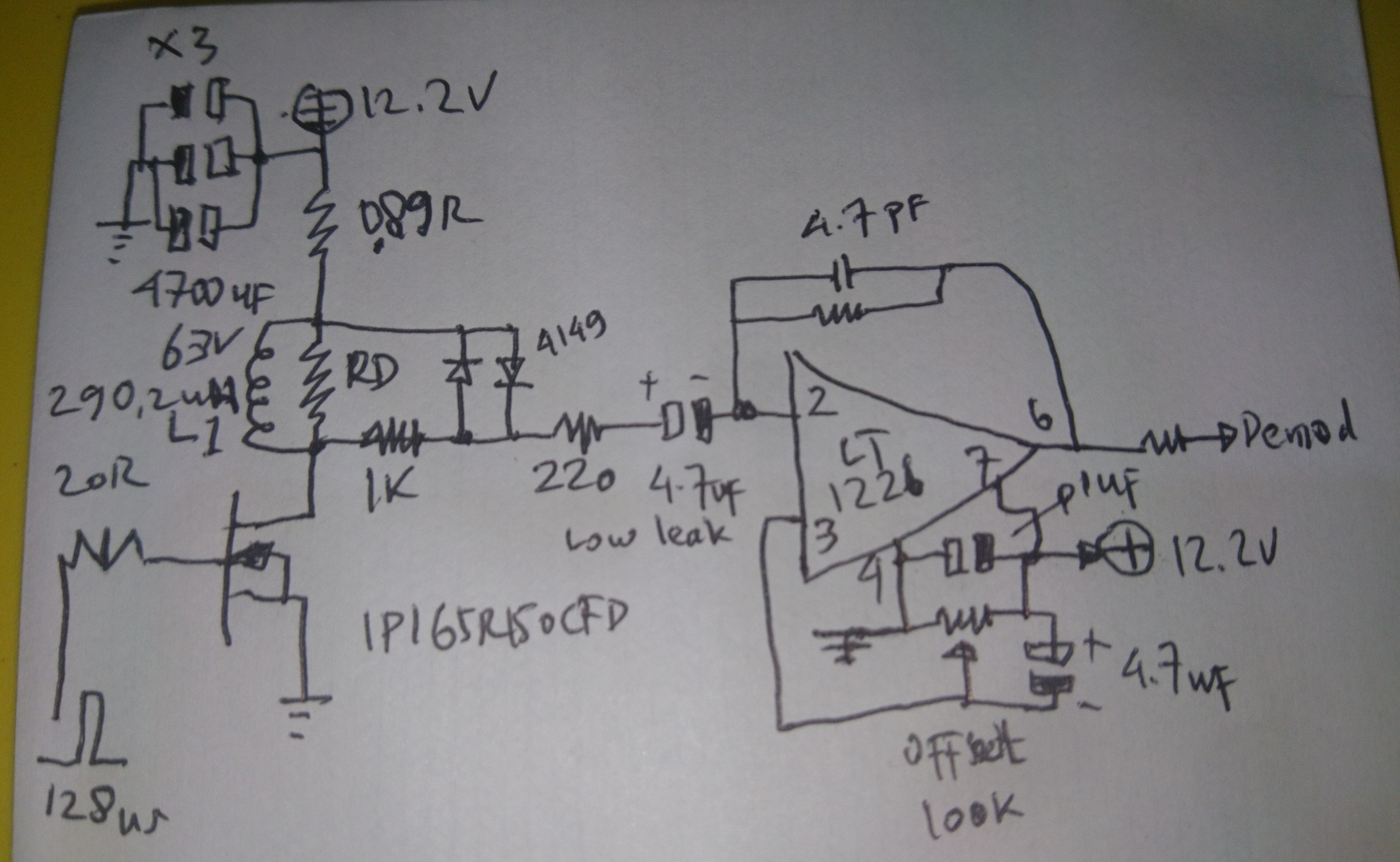

      Ok, my setup is 12.2V 2.5A dc 5x4700f/63V 290.2uH 3Khz 128us PW 0.89R (100W) series with mosfet R damp was 184R (20W mox its hot) it was good! but I need faster so I put 289R damp but the mosfet is freezed within 1 minute. I was plan to gradually achieve to 3.2khz but I assume I can use 600V fast diode with it to get sample more soon, what happens if diode is lower than the mosfet breakdown?

            Thank you for the answer Sir Carl. Now I have to find better FET. About damping is low It's because I put a rheostat and switched parallel resistor jig to see the best respond to target (some sort mix copper / bronz / brass) from 100R-700R selector jig, turn slowly at184R it does not avalanche, but detection was good, but I trying to see how better respond, until somehere in 333R it start to avalanche near 800V when I put lower than 700V it stay in 289R I was satisfy. And I put real parallel resistor with no jig, it can only stay a minute or two and it freezed

              Sorry. After look at the notes again I'm put wrong value in above statement, also forgot to mention, the R input was 1k then connected to 220R and 4.7uf cap before opamp. I also gradually increase the DC volt from 8V to 12.2V. The right value is DC at 12.2V with R damp at 184V at 540V flyb, at 333R at 950V and 289R avalanche in 833V
                I don't understand. A drawing would help.

                With such a low damping R it is surely overdamped. It sounds like you do not need an aggressive sample delay, if that's the case then there are other options. You could simply add some capacitance in parallel with the coil to reduce the flyback. You could add a snubber circuit which slows down the rising part of the flyback but not the falling part. You could also use a higher inductance coil which will be slower and probably more sensitive.

                  That's the word I was looking for thanks! Slow down the rising part of fb,,, but I like this if it can survive (fet) the machine like the target I intend to search. Ok I will try to add capacitance with the coil, what value it should be?

                    OK, now I understand. I would try adding a snubber. Here is how to calculate C:
                    The energy in the coil at turn-off is 0.5*L*I2 = 0.5*290uH*2.5A2 = 906uJ
                    Suppose you want a maximum flyback of 650V so the FET does not avalanche. The cap energy stored is 0.5*C*V2 and this will be equal to the coil energy above. So
                    0.5*C*650V2 = 906uJ or C = 4.3nF
                    Using the nearest common value of 4.7nF results in a flyback of 620V. Make sure the cap is rated for that much voltage.

                        Amazing thank you so much for this. The DC supply for this I also using very clean volt and current, I think you have solve my problem, hope the parts come soon. Again Thank you Chief!
