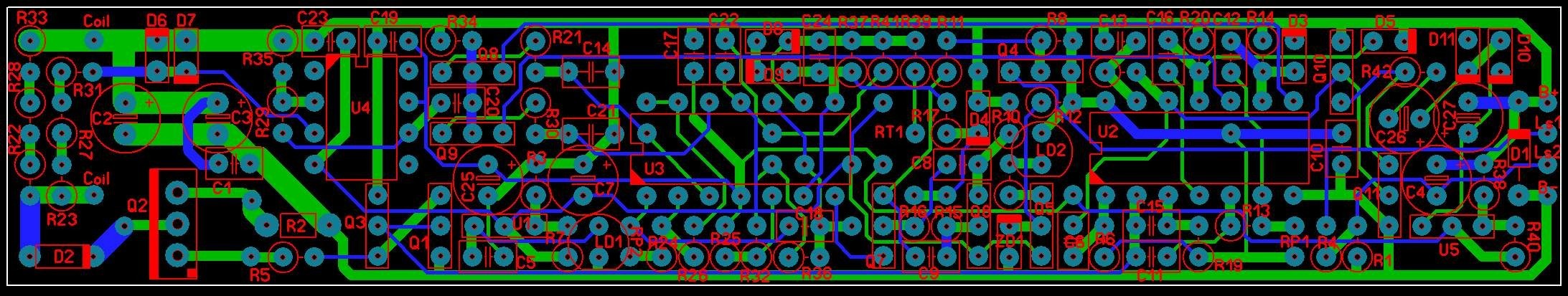

      Attached is the schematic of these PI detector optimized to work as pinpointer for grain size objects.
          Coss is 16pF. There's probably no benefit in using a series diode.
          • Hi Teleno,
            According datasheet page 5, Coss is 16pF at Uds=400V !!! See please diagram 14 on page 10. Coss is 2000pF at Uds=9V (power is 9V). The real result of min delay without diode is catastrophic !!!

                        • Hi Carl,
                          You are right. It is important to place the cap very close to TX FET. In this project, the pulse TX current is 8A and using of cap with very low ESR is important especially with simple 9V battery.
                          Attached is the file with PCB assembly information in more clear variant by Ivconic.
