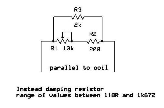

                    Damping tool components?
                    Hi all,,,,If I make this Damping tool to set the Damping resistor of my MMP Rev D and E, can I use ordinary 1% or 5% 1/4 watt resistors with an ordinary 10k Potentiometer? Thanks in advance. Marty
                    • #70

                      • #71
                        Since there is a pot that varies the resistance precision resistors are not needed so 5% or even 10% work just fine.
                        Once you adjust this to find best damping R value you remove this circuit and measure its resistance. Then pick fixed resistors to solder into the PI circuit.
                        You may need a combination on parallel R's to get the needed resistance.
                        I also use 1/4W R's and standard trimmer pot without issues.

                          • #73
                            @Homefire,,KT315 and Waltr,,,,Thanks a lot guys for your advice,,,really appreciate. I think I'll make the Damping tool (in the image I posted) from what I have available, 1/4 watt and some 1/2 watt resistors etc, then I'll probably order some better parts to make a dedicated Damping tool for future use,,,,I've got plenty of different value 1w-2w resistors to put in the MPP when I know what value it needs for my coil. Thanks again guys. Marty
