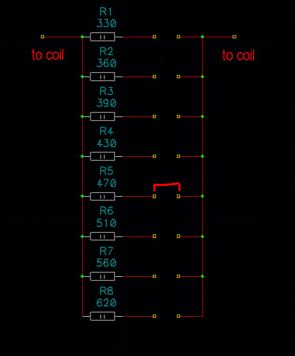

        interesting but you have a choice only b/w values 330 360 390 430 470 510 that is not hard to test by simply connecting.
        • #79
          @KT315,,,, I will add those value Resistors to next shopping list and try what you advise,,,Thanks. Marty
          • #80
            @Marty. i can do a special test board with all those resistors and with pin connector so anybody could set a jumper
            choosing needed value. not so hard.

              Hiya KT315,,,What is this special board?,,,Would I be able to make it? My MPP Rev D is ready to be put in an enclosure now,,,I only have to set the damping resistor for my MPP Rev E for the coil I will be using then I can seal that one up too. How do I make this special damping resistor tool/board? Also, do you have any blank boards left for sale?,,,I am after collecting some new projects in advance for next Winter time projects. If you have any, could you list the boards you have please?,,,Thanks. Marty
              • #82
                my plan. this is a simple board with row of 2W resistors and double row of pins. you choice a value by shifting of a jumper -
                you see here is not switches, no something hard to find out. you connect this board to your MPP in two points.

                        Hiya KT315,,,,,Thank you for the schematic,,I appreciate it very much. I have ordered the necessary 2W resistors to build it. I am very interested in purchasing the GMT pcb from you but my pay check doesn't go to the bank till Friday so would I be able purchase it from you after Friday please? I have been looking round for more projects to build during the next winter months if you know of any interesting ones? Thank you again for the schematic, it's very kind of you to help me. Marty
