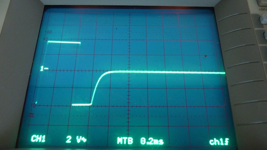

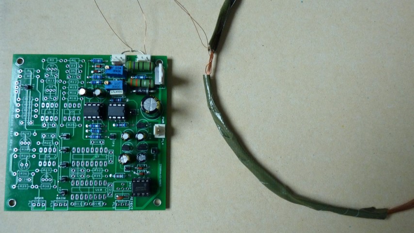

                Just started making the Revision E board. All OK up to step 5, but not seeing much action from the very basic 'test' coil (25 turns around 190mm dia former, 0.22mm enamelled wire, not screened ). Does anyone have 'scope photos from the various test points so that I have some idea what I should be seeing?

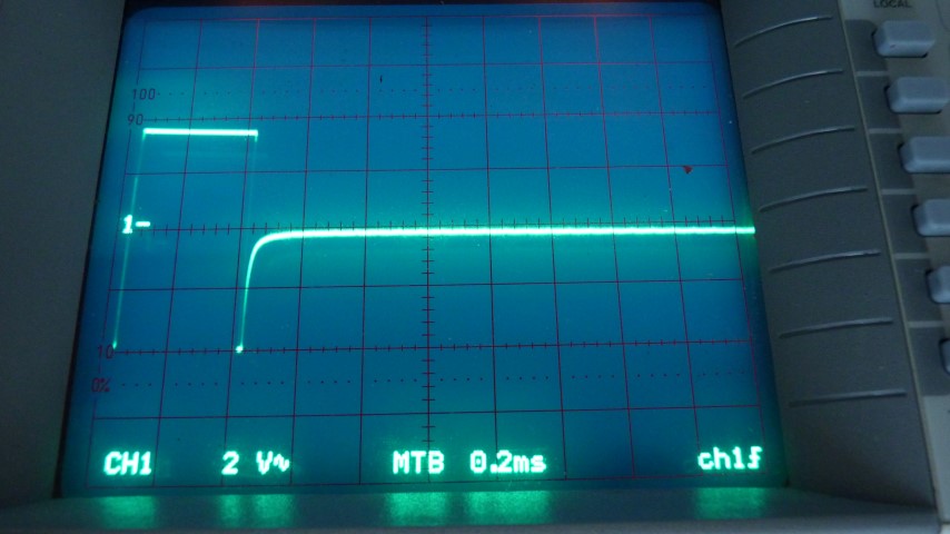

                    Yes Rx and Tx pins linked, coil between link and ground. TP3 Scope pulse changes when a can is near, but not amplitude?
                    or is this OK for a very 'crude' coil?

                      That looks fine to me. If the pulse moves along to the right when metal is near the coil, then it's working correctly.
                      The preamp output shows the last part of the decay curve as it approaches 0V. Initially the preamp is saturated due to the huge input signal. But, as the signal exponentially decays away, it comes out of saturation. When metal is near the coil, the decay takes longer, and hence the curve moves to the right.

                          Yep, the scope traces look perfect.
                          Remember that the first sampling will be just as the decay curve approaches zero without a target. With a target the Voltage during the first sample is much lower thus producing a change on the output of the integrator stage.

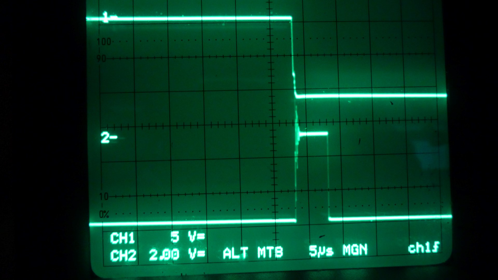

                                I read about the benefits of a 'fast coil'....in Step 6, Adjusting the sample delay on TP6, instructions state 10uS, I can adjust for a minimum of 5uS before it cuts out.... is this a measure of how fast the coil is? and better for detecting than 10uS?
