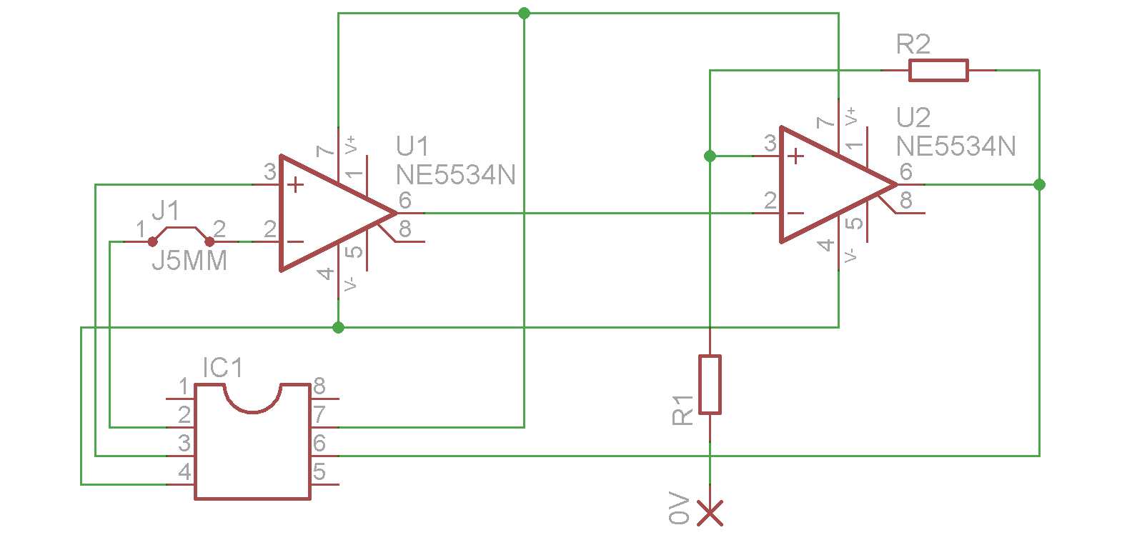

            George here is a thought:IS it possible to modify the CB with 2 stage pre amp using NE5534 (i have a lot originals from TI and having trouble to order 5532 THT version) ??
            Im thinking a small addon "card" ,the I/O of this card will be placed on the U5 (i hane installed an ic socket so i can change the opamp if needed) according to this schematic i made only based on how it is connected on the MPP.Dont know what values of R1 and R2 of this card and if i should change the values of R31-C13 and R25-V47 possibly...It should need 1 extra 0V from pcb.
Name:	CB Pre-Amp Addon.jpg

                The first 2 diodes for first 5534 are on the CB pcb..Should I add 2 more?As I see from MPP preamp there are diodes only on first opamp input..

                  You can use two 5532s in place of a single 5534, but each stage needs to have a gain of 33k. Look at the schematic for the MPP and copy that.
                      Ok,lets break it down and please show mercy
                      At the MPP there is one NE5532 ic that contains 2 seperate amps.As i understand they are in connected as inverting amp the first stage and non inverting the second :
                      First stage (U2a) has a gain of: Gain=Rfeedback/Rinput --> Gain=R1/R8 --> Gain is 33.
                      Second stage (U2b) has a gain of: Gain=1+Rfeedback/Rinput --> Gain=1+R27/R26 --> Gain is 34.
                      What is the total gain of the 5532 on the MPP??
                      At the CB Gain=Rfeedback/Rinput --> Gain=R32/R8 --> Gain is 1000????

                      You say that you have a card like that for the HH but will not work for the 5534?For sure because they are different ic's.32 has 2 opamps inside and 34 has one,totally different pinout.
                      I asked George if i could implement this stage with the 5534 because i have 12 original TI ic's,i have trouble to source (from europe) 5532 in THT package.
                      Just dont know how much gain we need at the output
                      • Originally posted by mushaba View Post
                        Correct.
                        The gain is 33 * 34 = 1122
                        Yes, the gain is 1000, but it will work fine with 1122.
