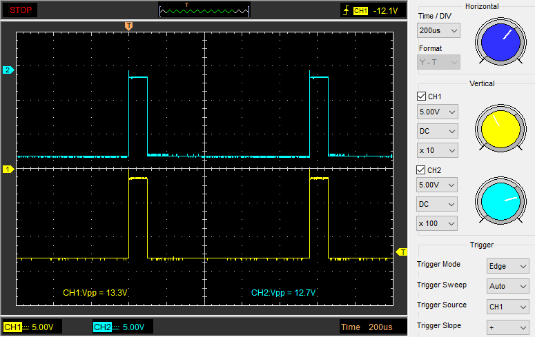

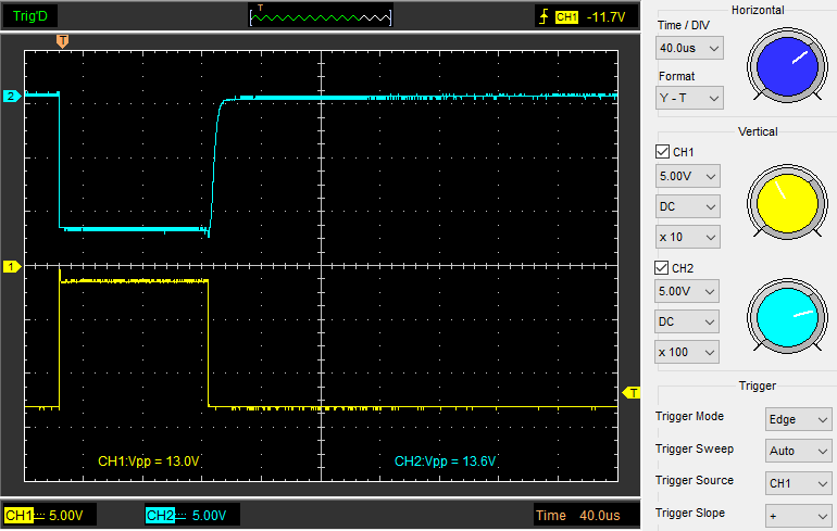

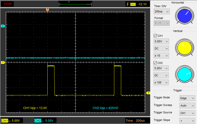

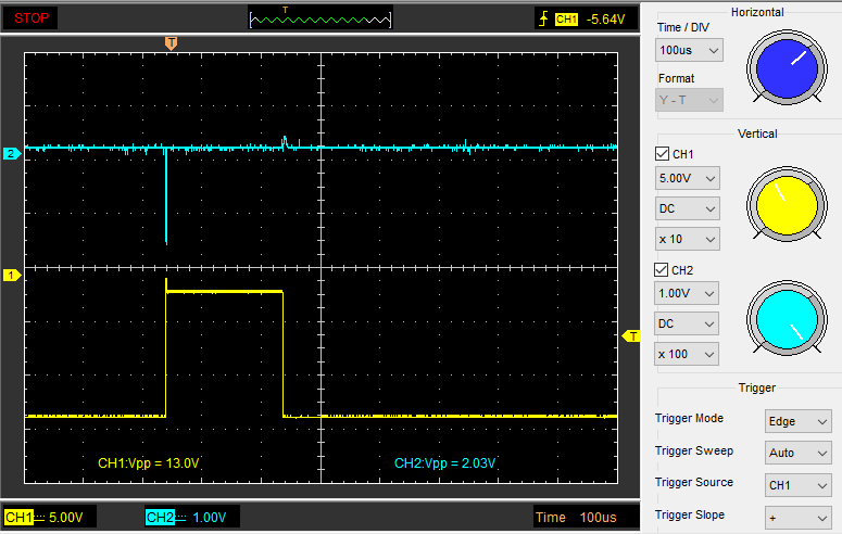

            IRF840 pins scope measurement here :
ID:	357315 Click image for larger version
ID:	357316 Click image for larger version
            I took several videos on R10 with analog and digital scopes on MUR460 too.
            The only flyback voltage I can see is a more or less 400mv peak.......
            • #96
              The scope pic of IRF840 Drain looks like the Coil is NOT connected.
              If coil is not connected or has an open or is connected to wrong place then there will be no flyback.
              Carefully recheck coil connections.

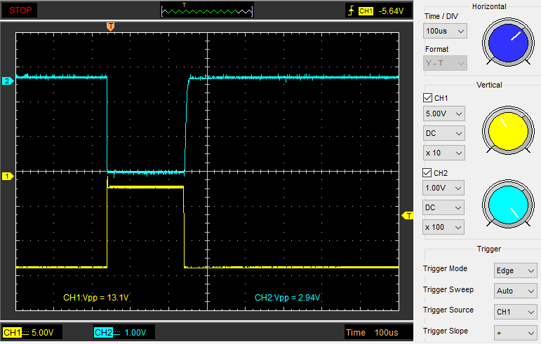

                          • I did some tests :
                            With the coplanar coil :
                            With a multistrand electric wire 0.200mh 0.7ohm nothing : Click image for larger version
Name:	200uH 0.7ohm multistrand electric wire.PNG
                            With a litle coil under the tx coil there is nothing too(probe connected to a side and ground of the probe on the other side).
                            I get this on the damping resistor tool when no coil is connected. Click image for larger version
                            • Originally posted by Albdelafar View Post
                              I did some tests :
                              If you have no signal from the secondary small coil it would seem that your detector is not transmitting a signal via its coil.
