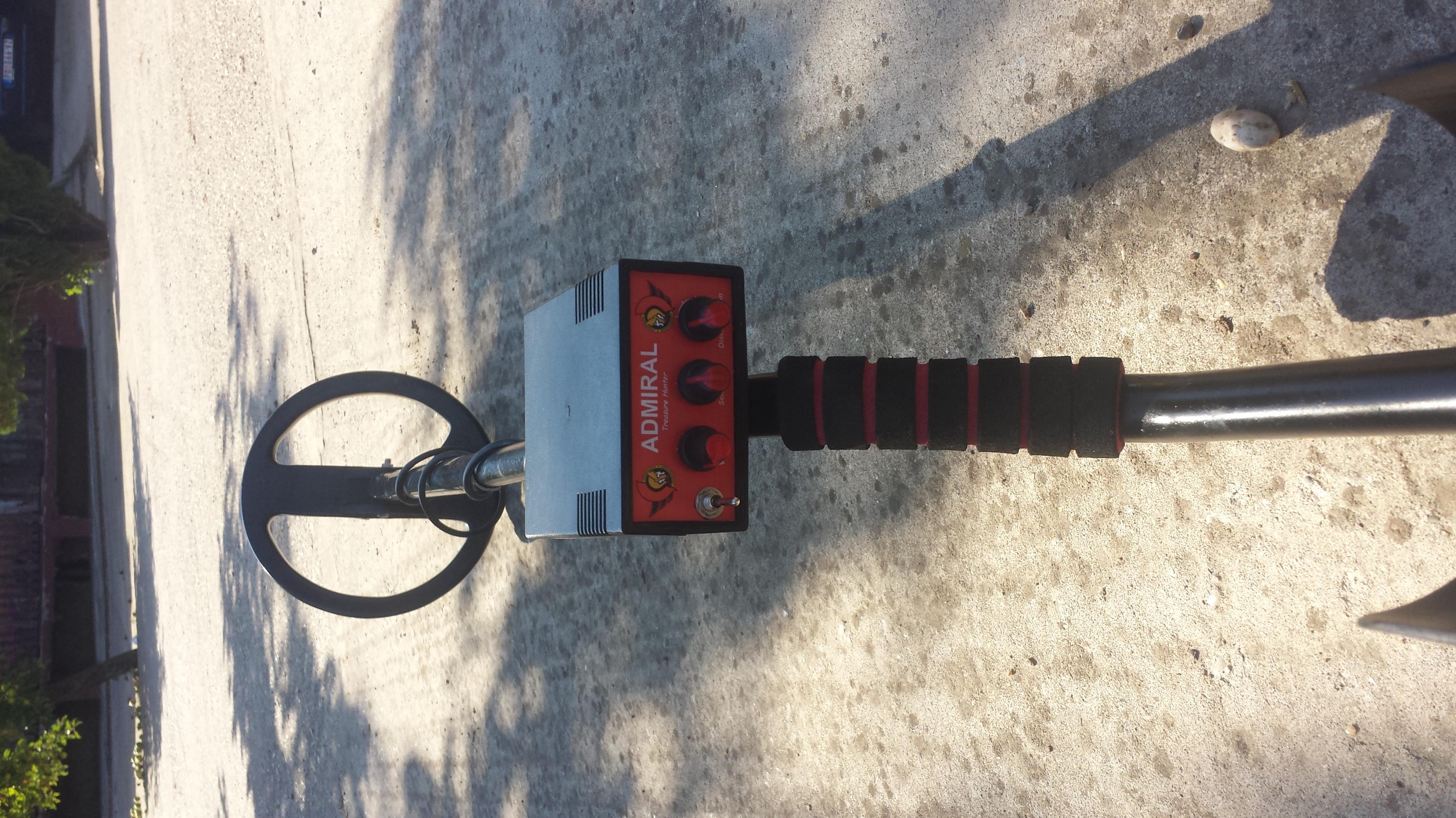

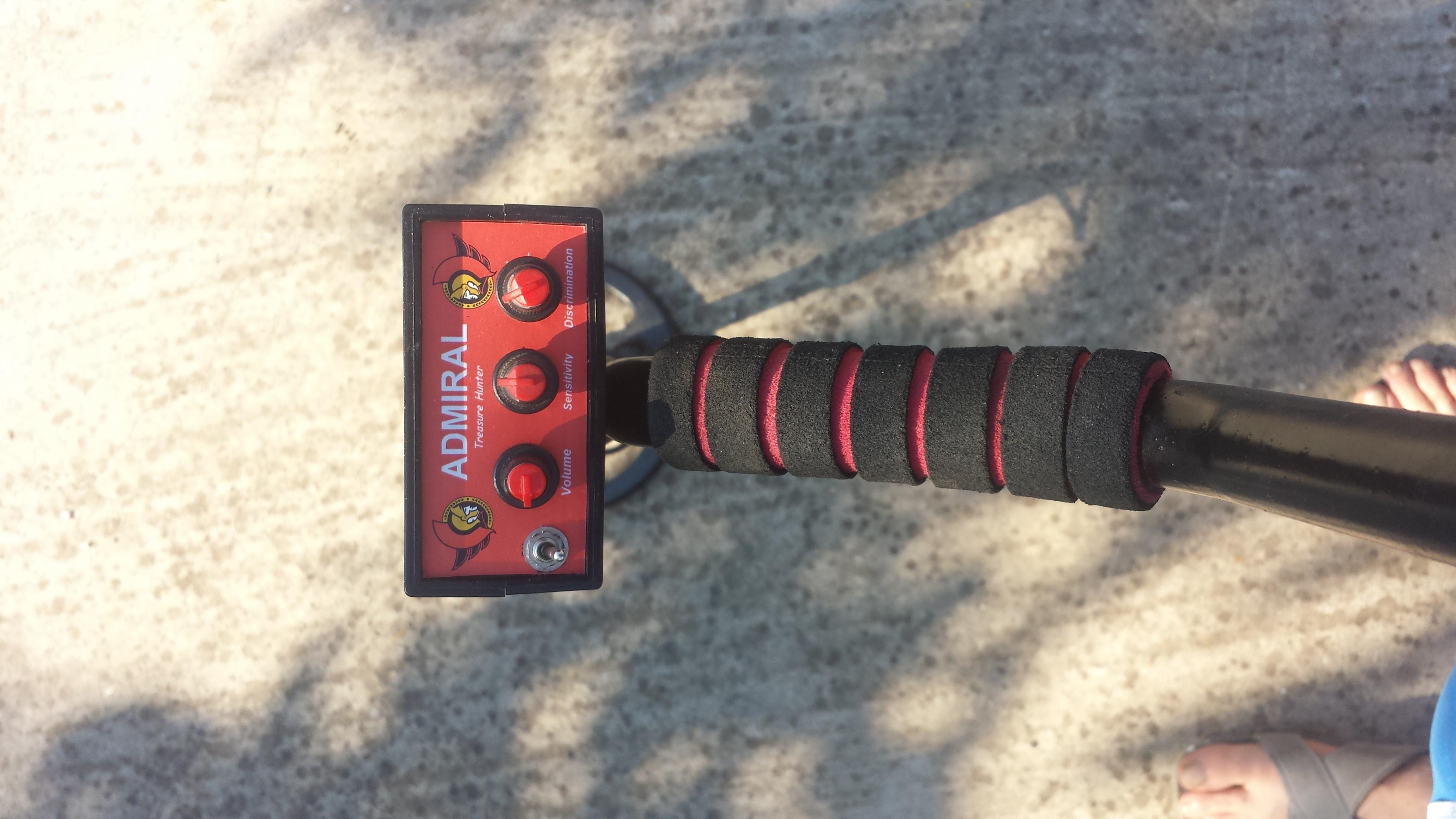

                      My Admiral build with 8.5 inch DD coil.
                      Coil specs is a little bit changed cause i used rx coil from TGSL...
                      Really good on coin shooting, like it. Also, in video is shown test with mineralised ceramic, brick and hotrock.
                      TX 1mh
                      RX 6.5mh

                        i got an Admiral pcb from user bandito
                        seems all work ok, but i have to test different coil
                        as i remind i get good results with
                        0,4mm 1mH / 0,2mm 12mH
                        fine Tuning by combining capacitor on rx / tx stage
                        around 8khz for TX side
