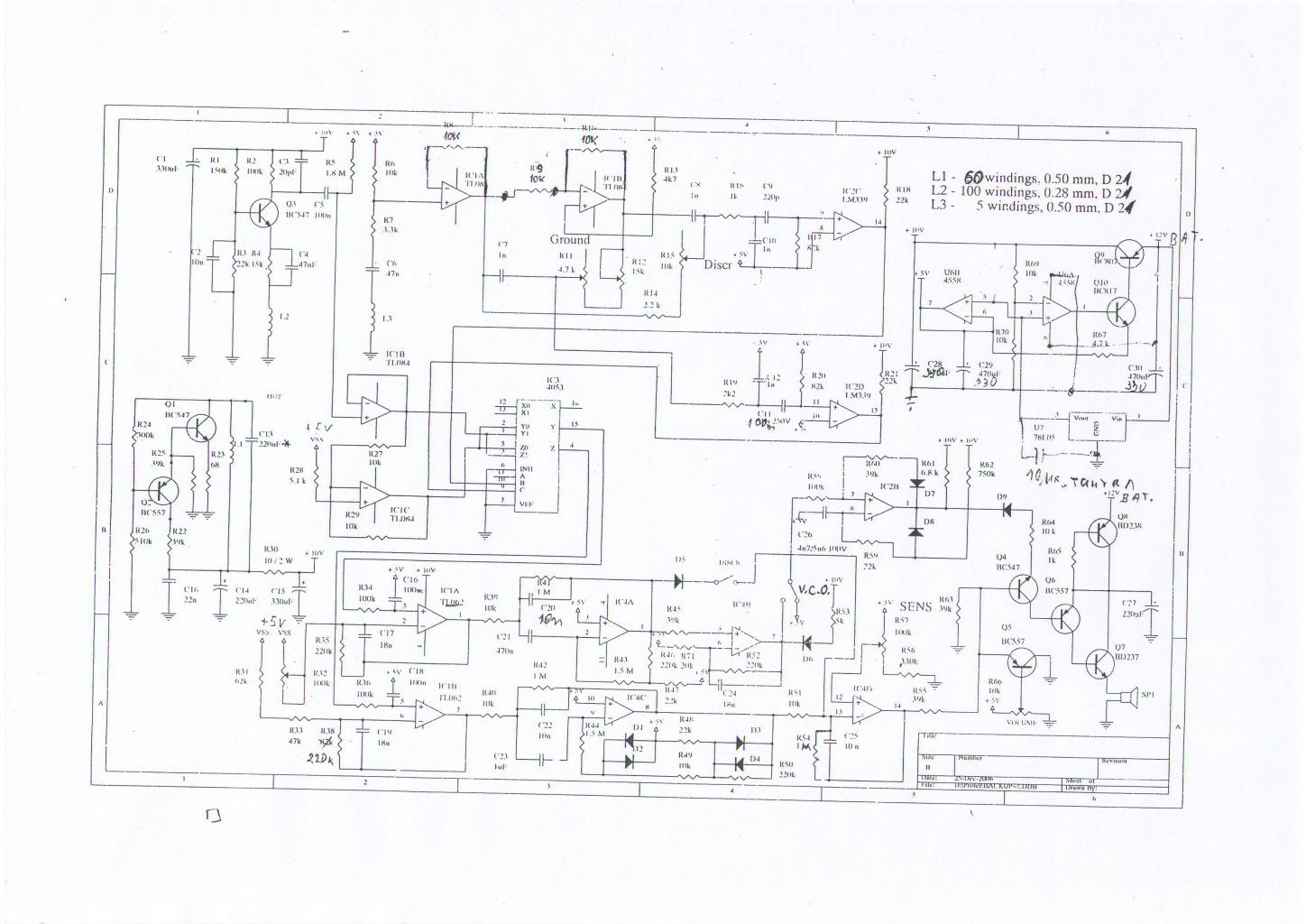

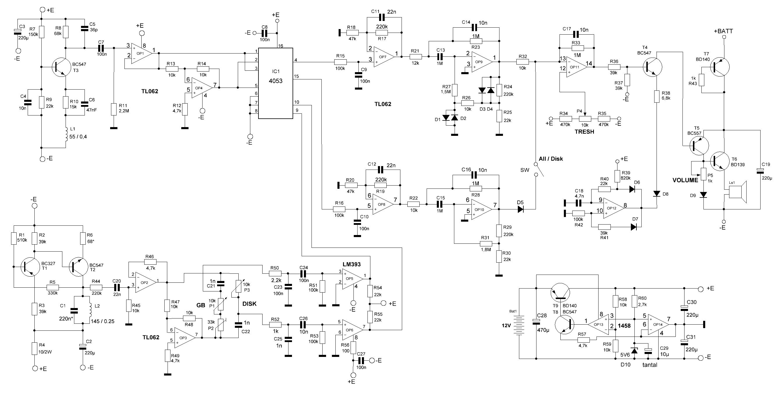

                  This is Cscope design
                    Could you please tell the name of this Cscope design?

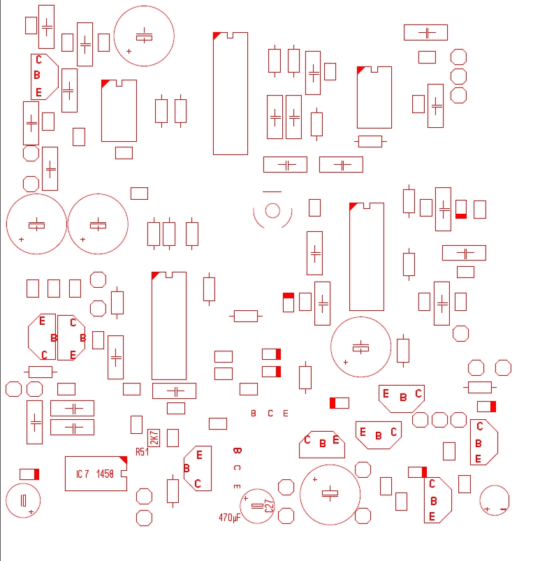

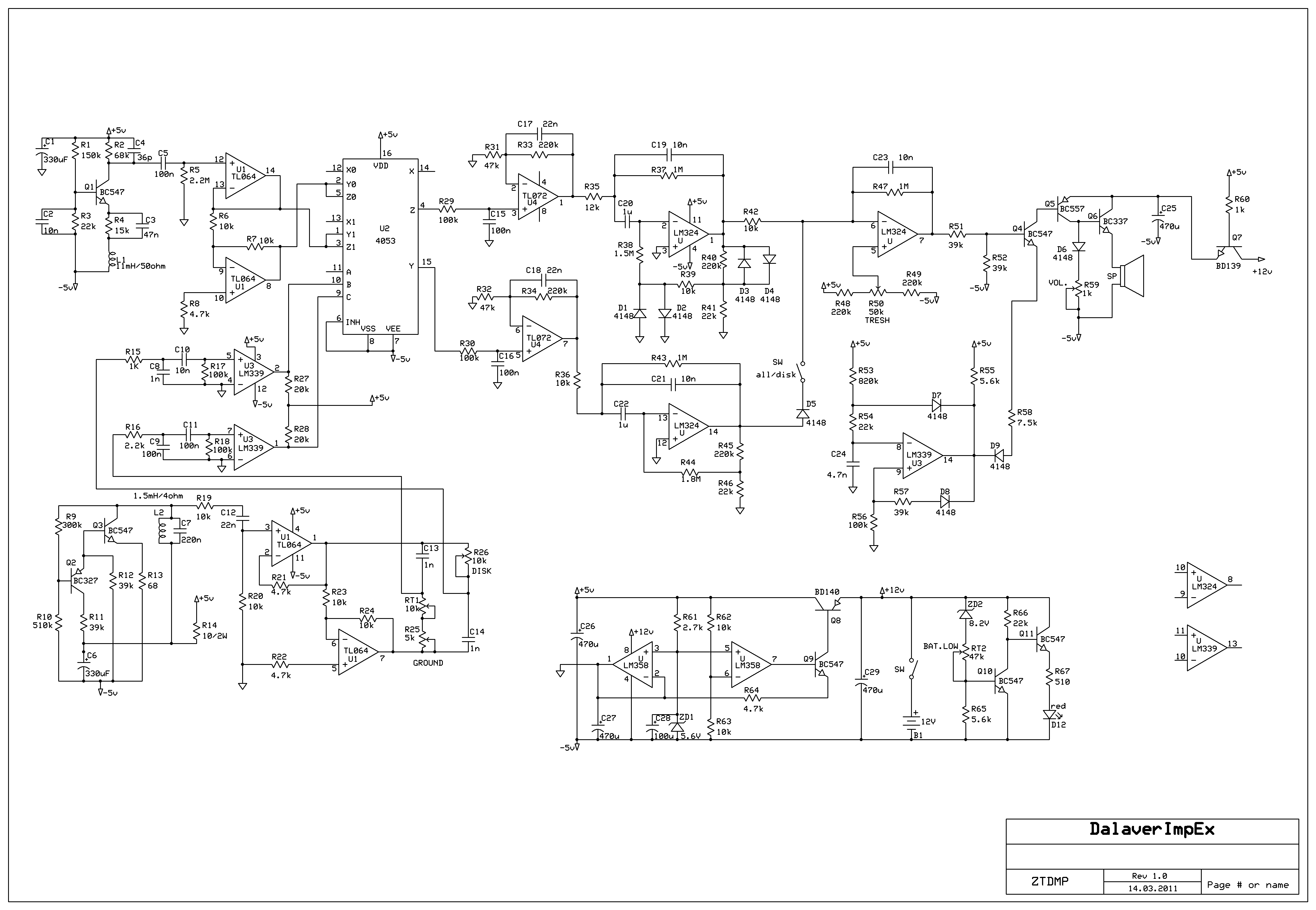

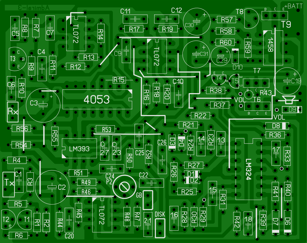

                      Here is another schematic that's the same as the two I posted above. I noticed they were the same while looking through my schematics archive. I Can't remember which cscope but maybe the cs2 pro. And here's a very compact layout for Wave/Admiral which is the same circuit.
                      I have a Sprint file of the pcb if you want it, no problem.

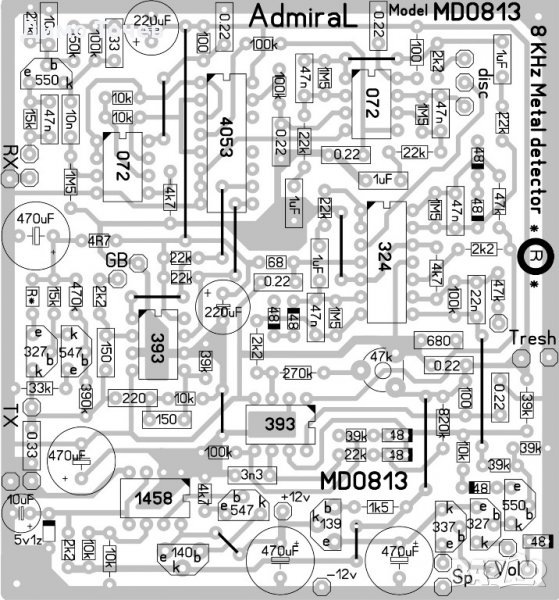

                      • #41
                        just curious

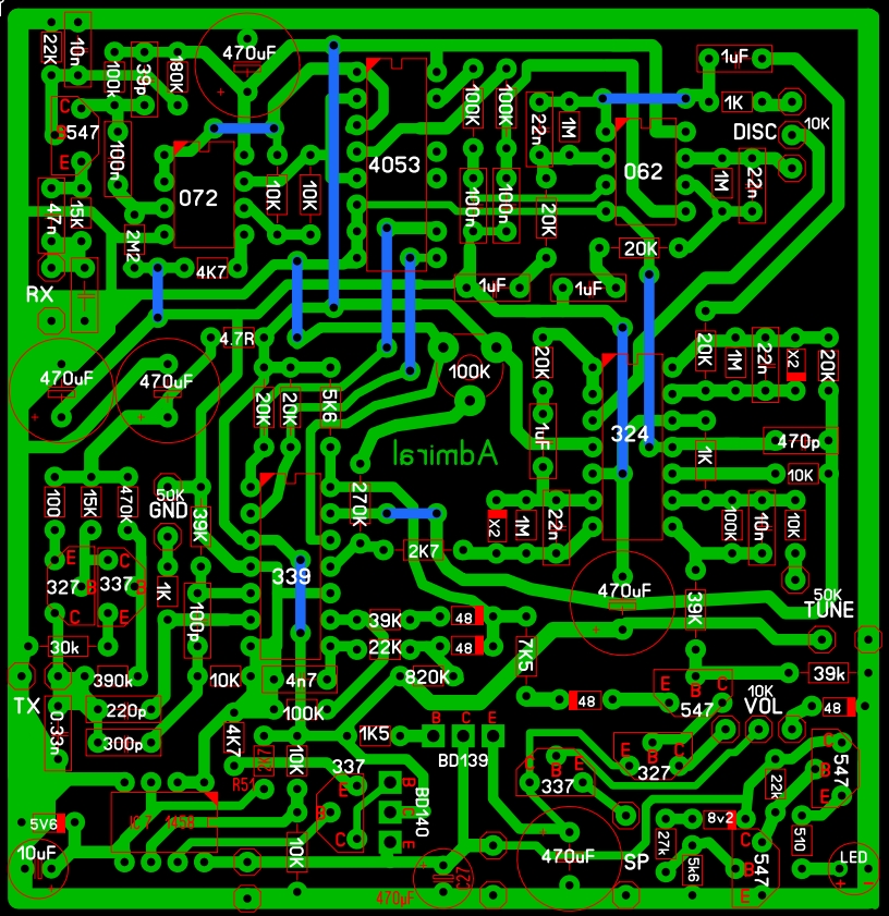

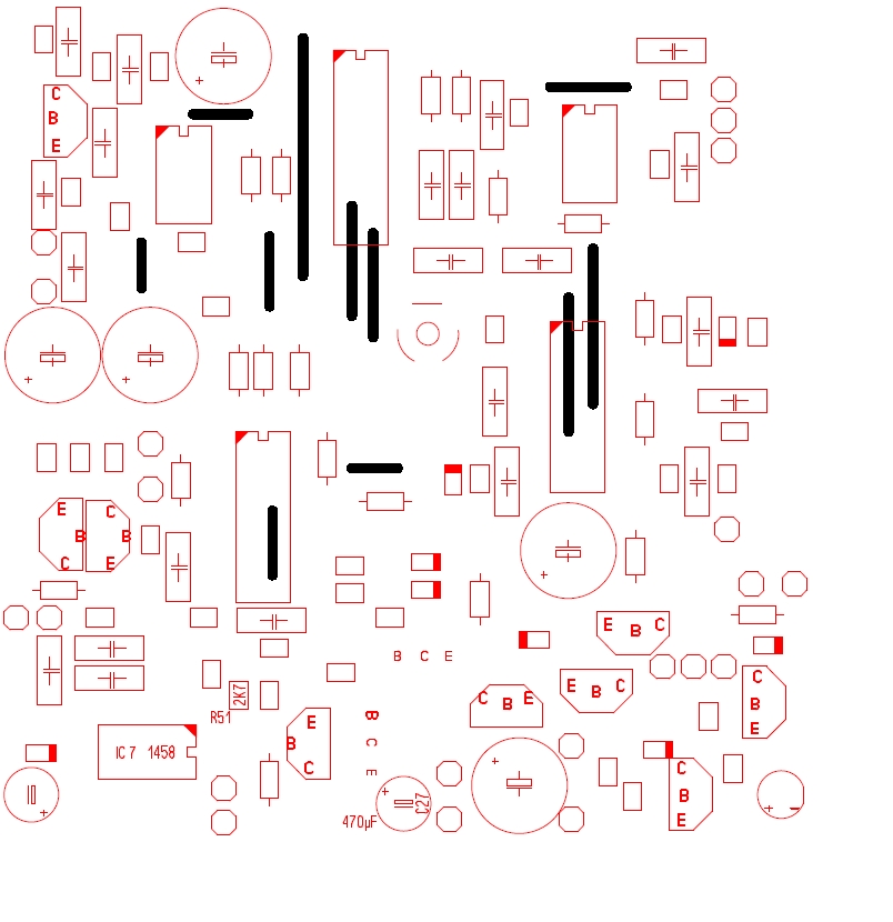

                        but here look
                        i hope it is enough info

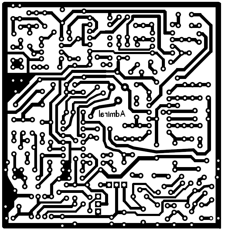

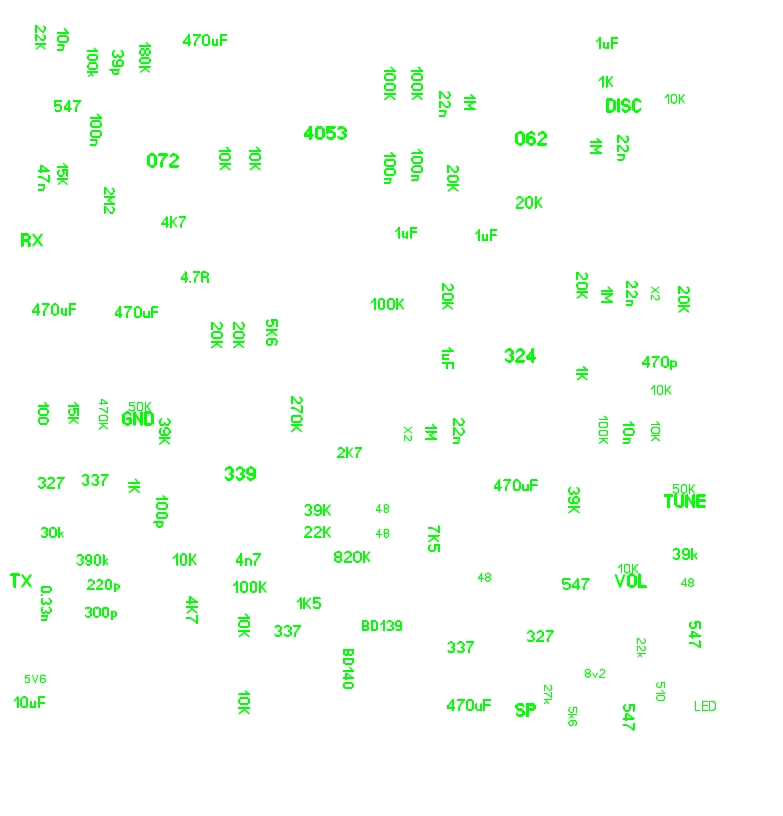

                        i optimized all for toner transfer method

                          guys i need a layout file of ADMIRAL (C-SCOPE CS2 pro, i believe).
                          a version with two 393.
                          • #43
                            I NEED IT TOO SIR.
                            • #44
                              Enjoy it
