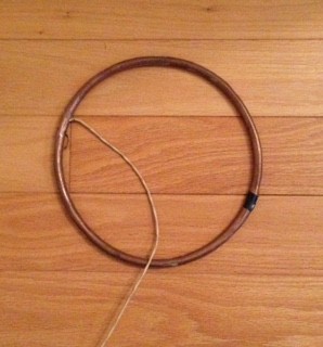

                    • I tested both, not much different, I suspect that bad shield is causing more ground influence, so I make coil inside copper tubing = 100% shield.
                      testing results = The influence of the soil is the same for all 3 of them​.
                      coil inside copper tubing.
                      Click image for larger version  Name:	cu rx.jpg Views:	0 Size:	23.6 KB ID:	420601
                      to check quality of shielding spray some water on finished coil, no signal changes = good shielding
