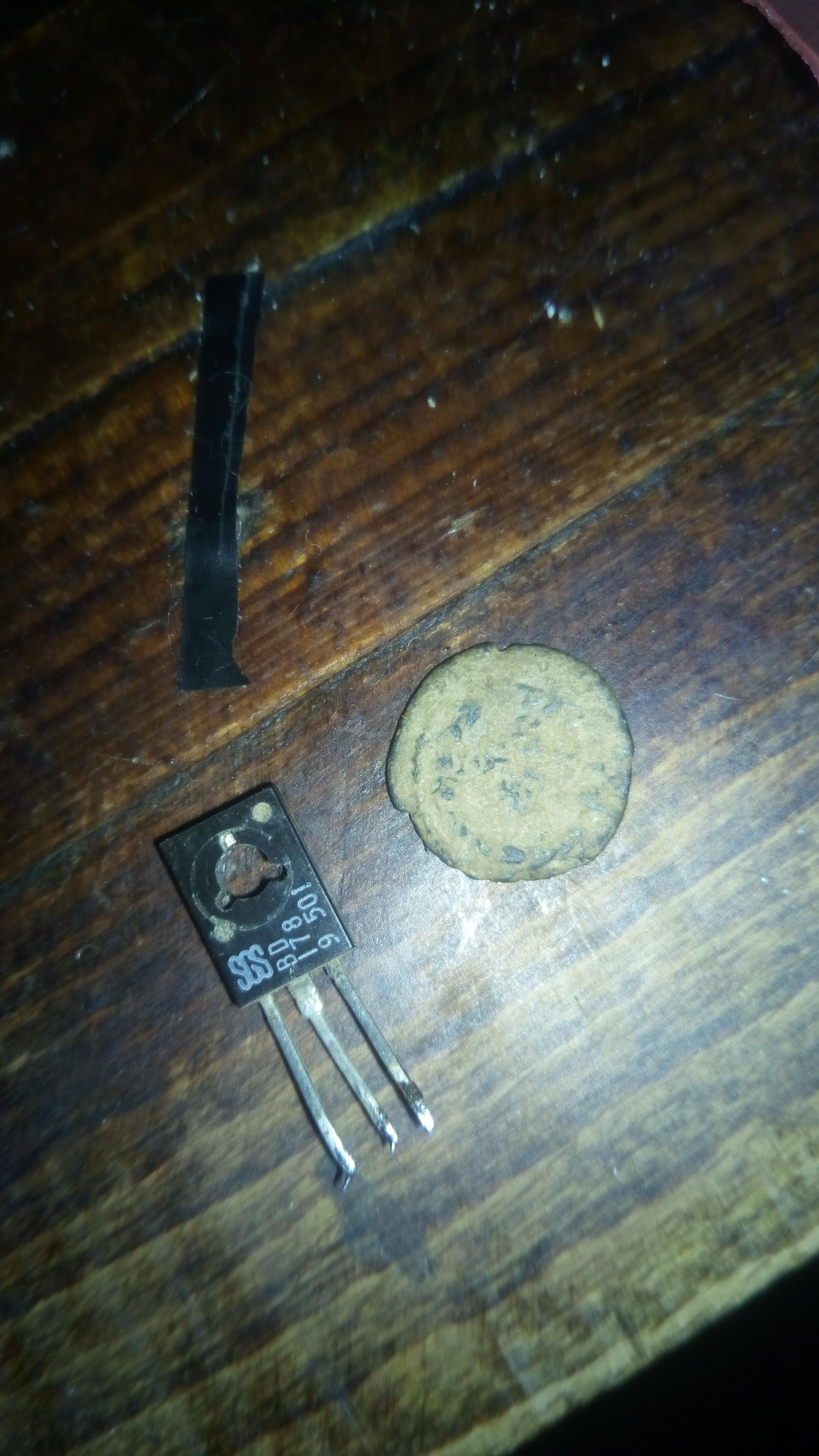

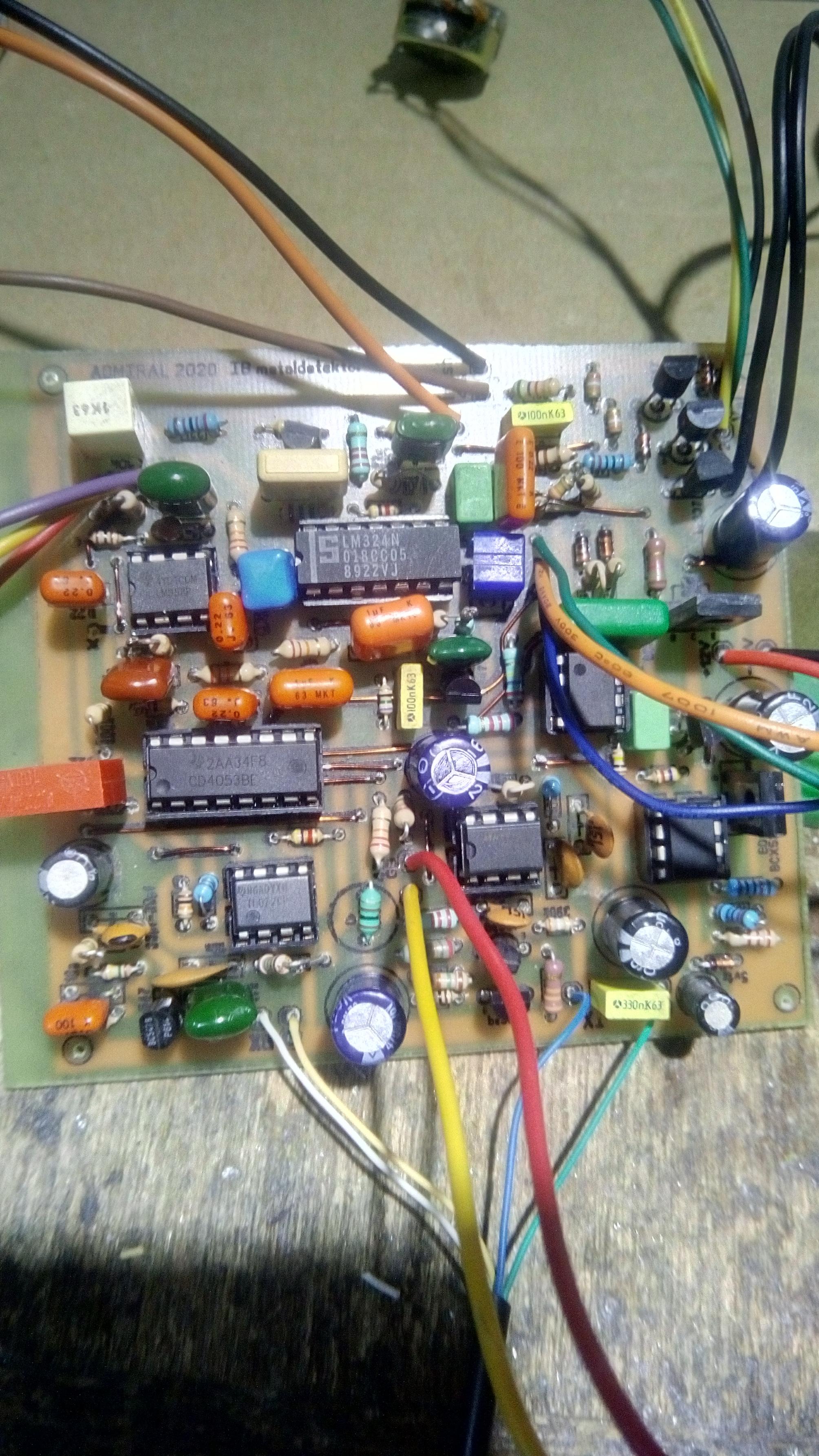

            I build this one in the picture it is 2 tone by nikko i guess
            In air test i catch a coin 14mm between 15 and 17cm look picture . Is it good or bad?
            My language is arabic if you understand it will be good
            Maybe i will try to change some things

                  You should be able to hear that coin at 24-25 centimeters.

                      Good distance but hard to do it
                      • Try to select ICs(opamps). Based on my previous experience there were situations achieving different results during experiment different opamps (pcb with sockets). Another suggestion is to experiment with different capacitors replaced paralel on Tx coil. The distance and threshold are changed sometimes significantly.
                        • Yes, you are right, especially about capacitors. I welded a socket to replace it. And in the crucial moment to discover the difference, the battery was depleted
                          • Hi Zotchin
                            Change the quad opamp LM324 to LMC6484 or LF347 and you will have a better detector.

                              Great. thank you for help
                              I'll tell you the what is the deference.
                              • I doubt that with LF347 the detector will work correctly.
