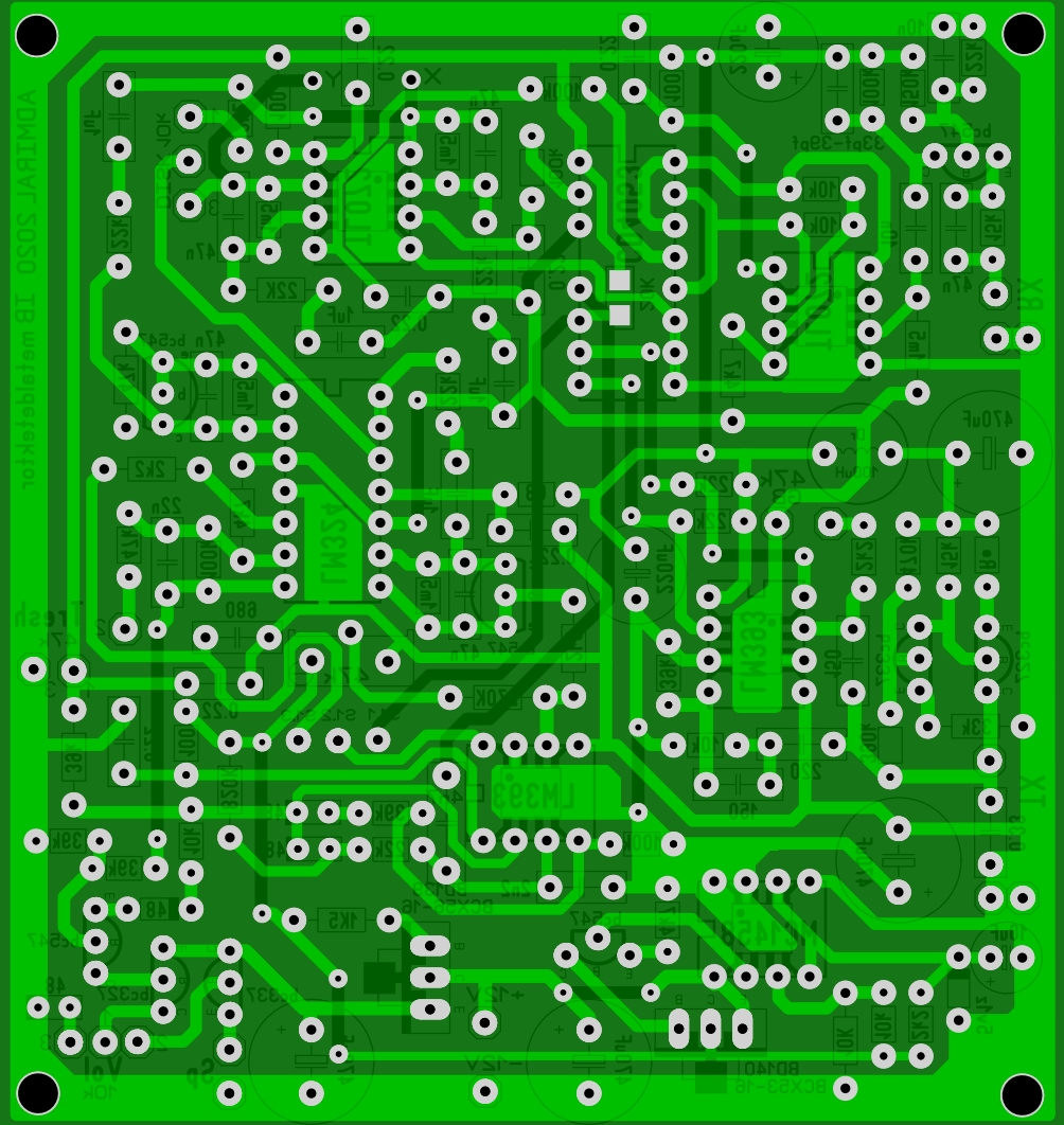

  • #76
    PCB top and bottom

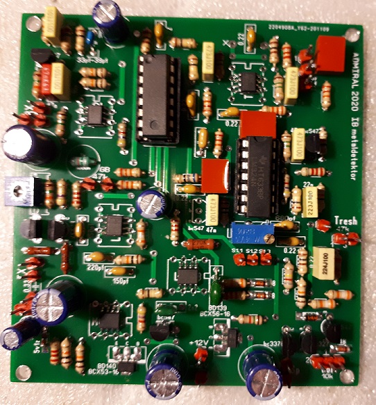

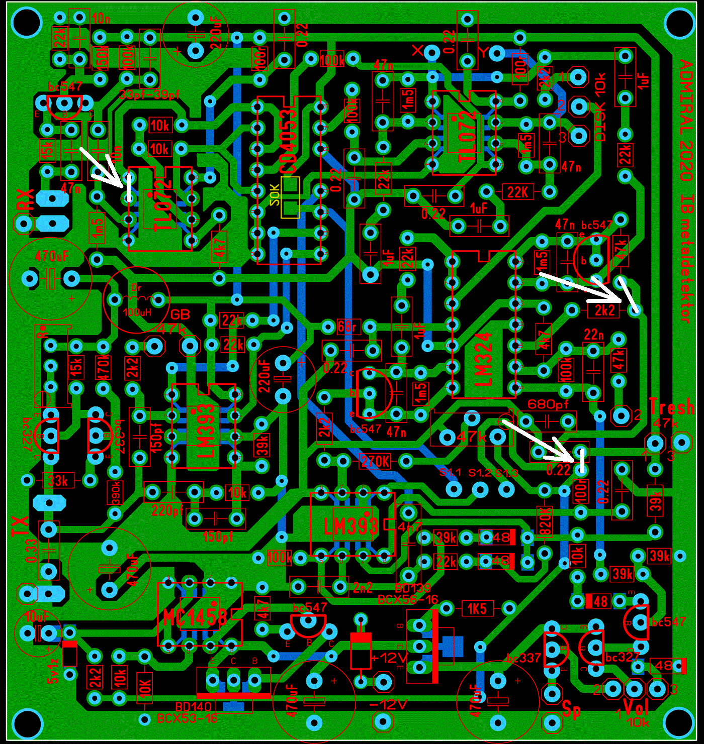

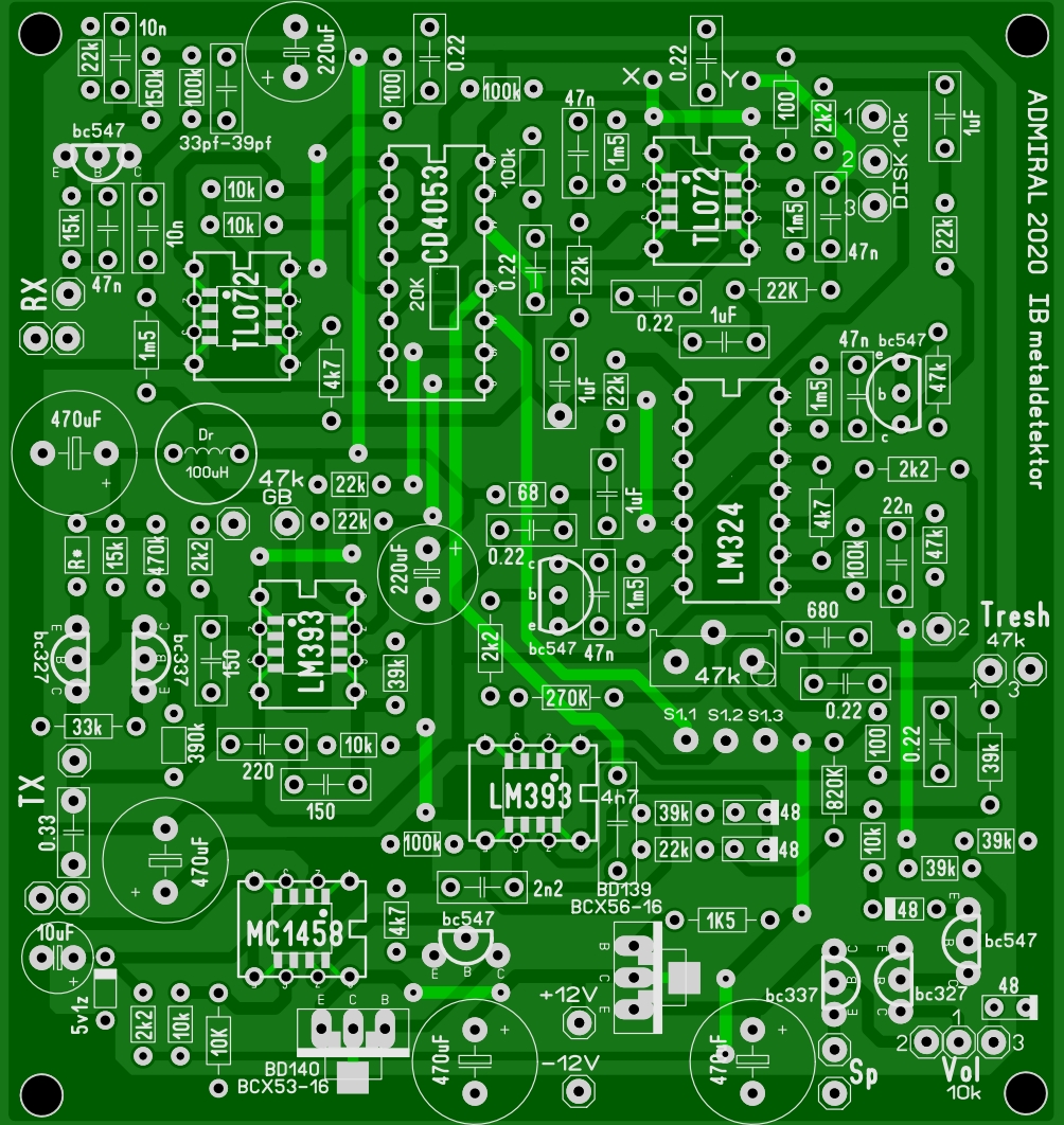

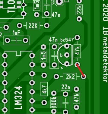

    • #77
      Guys, I'm sorry, I missed one track. Who has already assembled the device on this board?Click image for larger version

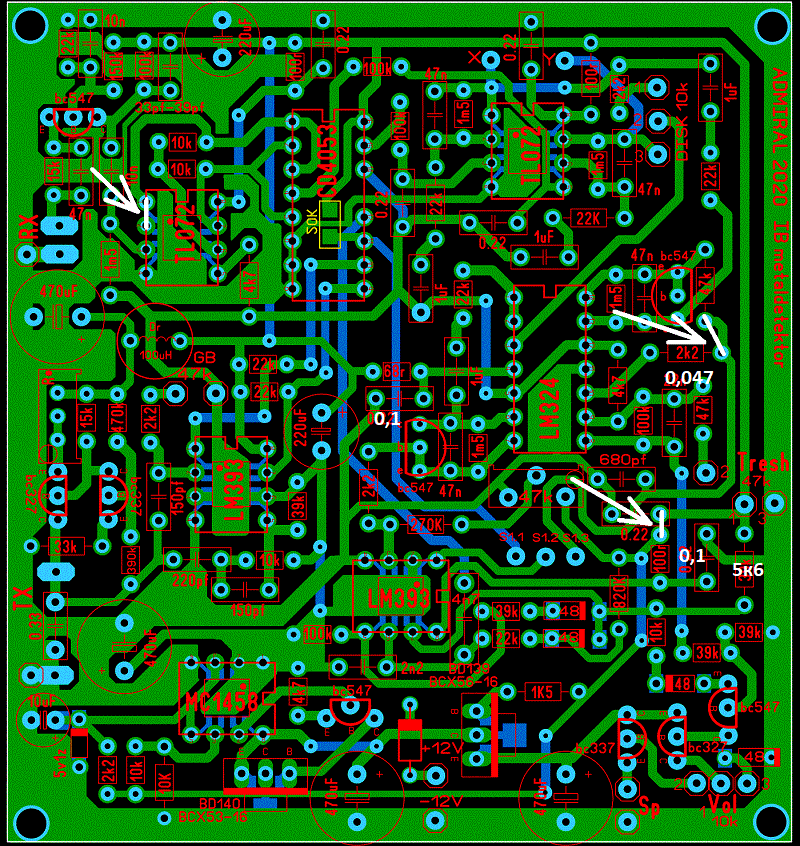

          • #80
            Replaced the denominations (the threshold tone became even, without disruption)Click image for larger version
