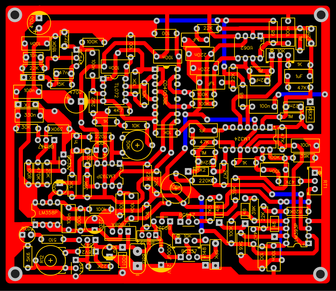

          • new PCB let's give it an other try

                  • Originally posted by getsa View Post
                    hi gesta i build new PCB little good things and a lot bad things it's PCB number 5
                    my problem is that GEB not working at all can't disc ferrite any help
                    • shield of the white cable is not connected with the ground.
                      • Originally posted by Deghbar613 View Post
                        show schematic
                        • Originally posted by pito View Post
                          show schematic
                          where you want me to check the schematic ?
                          • you build detector without schematic ?
                              You need to adjust the phase of reference signal applied to phase detector, it has to be 90 deg shifted compared to Rx signal.
                                Thanks for your help pito
                                unfortunately I am a beginner can you explain with Illustrative images
                                by the way my osciliscop is only one channel
