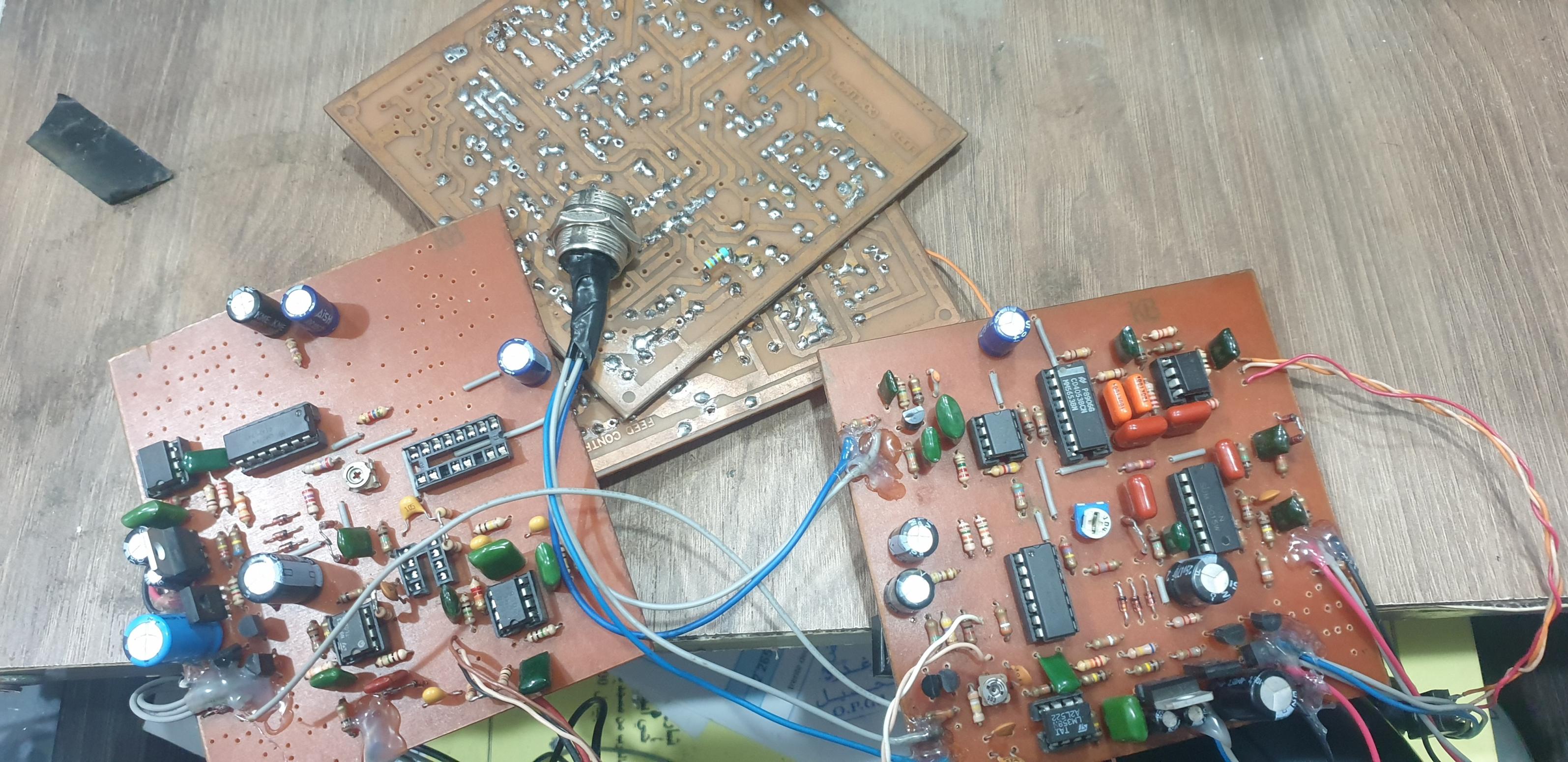

      hello gesta and guru
      All my attempts are in vain
      please share with us your pcb and data maybe some Tips from your experiences
      thx

          THX FOR REPLY GESTA
          this some information
          this is my pcb

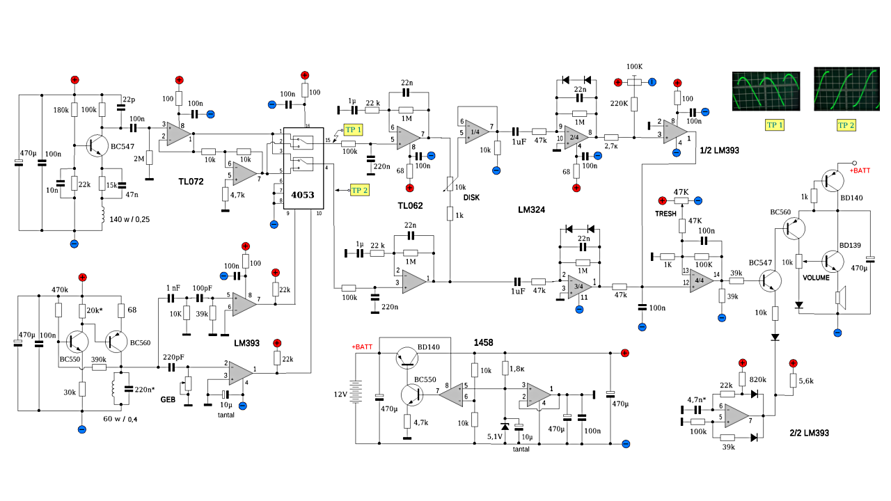

          • At first glance everithing seem ok, instead the signal on tl072_pin1. There you should have pure sine wave.
            Besides - what the signals on pins 4 and 15 /4053 look like? See what I mean on the schematic - TP1 and TP2.
            Do you have a constant tone with the threshold potentiometer turned to maximum? - it depends on 100k trim setting.

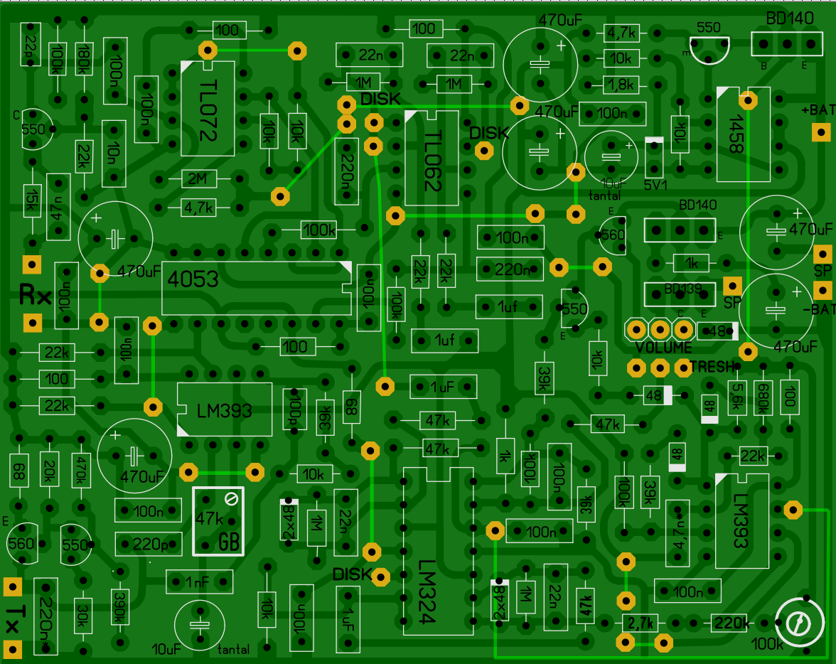

            My version of the board I'm currently playing with is different, but this is for experimentation...

                      • I intentionally depicted the signals on TP1 and TP2 on the schematic I posted above - if you missed these details just see for reference.
                        On tl072 pin1 you have to see repeated Tx sine wave, with less amplitude, as a result of the coils ballance.
                        140 turns are relevant for 28 sm coil plastic shell - it referred to the diameter of the circle/circumference, on which one wind the coils (both coils), and diameter encompassed by the nails you use for frame the windings (for example) need to be 20 sm, so the coil to be accomodated in the shell normally. I haven`t measured the inductance - it depends on several factors. You just need to wind 140 turns on 20 sm blank for winding (same applies to the Tx coil, only need to be wind 60 w), after that the coil need to be tightened with thick thread and tape, as well as to be covered with aluminium foil for shielding (leaving a gap at about 1 sm foil uncovered coil space, avoiding short). Humble, simple, practicle explanation - hope I`ve been of help...

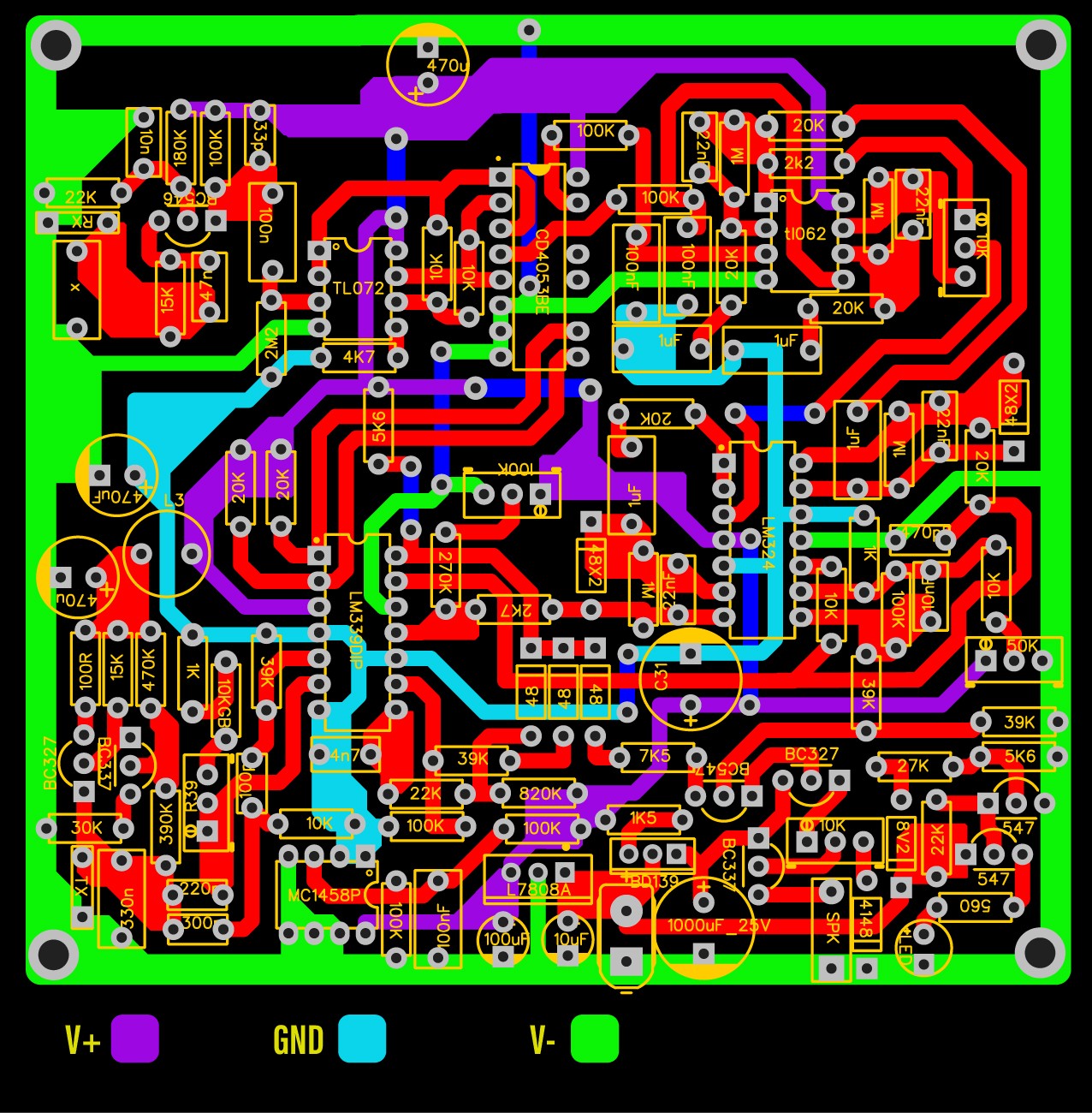

                          • Here you are - my custom PCB, who wants to repeat it and show results here.

                              • Originally posted by getsa View Post
                                Thank you
