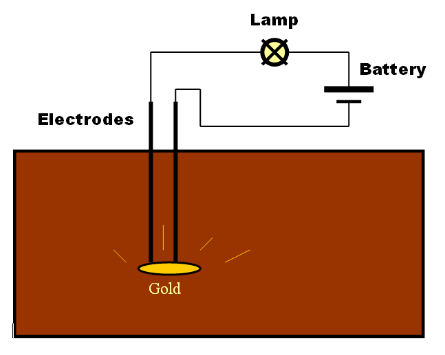

              • #82
                LOL! Click image for larger version

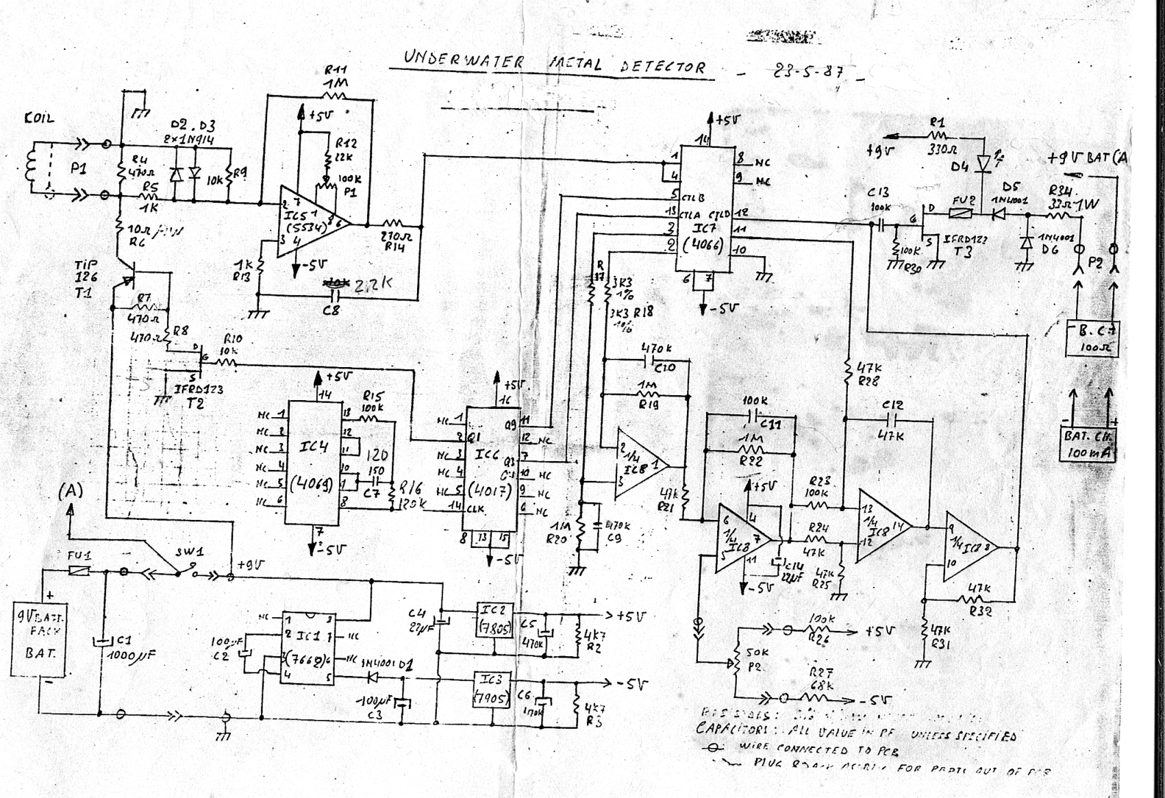

                          • #88
Name:	KW_1 Underwater Metal detector.png
ID:	417675 OK, here you have a simple non-motion PI. My first underwater detector. 1987. It used the NE5534 for the preamp, at that time something new and improved.

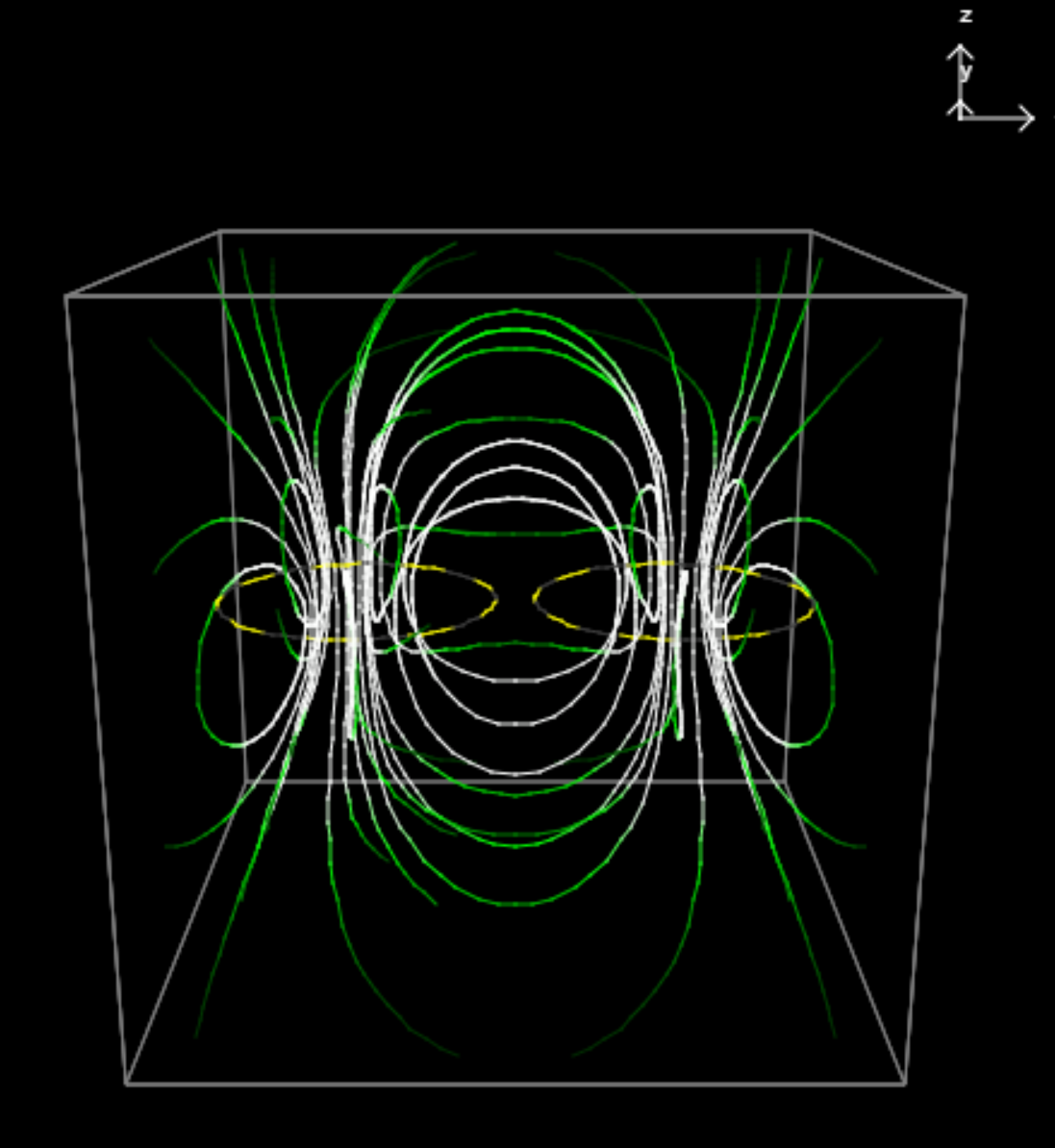

                            • #89
ID:	417674 Here you have a new coil idea for a PI. the picture shows the magnetic field lines. Note that the field lines "illuminate" the target from a different angle than usual.
                              • #90
                                Click image for larger version  Name:	KW_1 Underwater Metal detector.png Views:	0 Size:	2.29 MB ID:	417675 OK, here you have a simple non-motion PI. My first underwater detector. 1987. It used the NE5534 for the preamp, at that time something new and improved.
                                Thanks Tony!
                                Finally something interesting!
                                What was the name of that detector?
