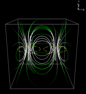

ID:	417674 Here you have a new coil idea for a PI. the picture shows the magnetic field lines. Note that the field lines "illuminate" the target from a different angle than usual.
    What's that?
    An "8" coil?

          What's that?
          An "8" coil?
          Any size coil really. An assembly of 2 TX coils with the windings such as to make the interaction of the coil fields "aiding".
          Now, if you add an RX coil over the center of the 2 TX coils, the fields of the TX coils would be cancelled in the RX coils, thus "balanced".
          I am sure you have observed that a coin seen in the "flat" position gives a strong response and a coin in the "vertical" position gives a weak response. Therefore, this coil assembly will enhance the response of a coin in the vertical position.
          Now, you probably have also noticed that a steel "crown cork" as they call the beer bottle tops, shows a resistive response in the "flat" position and a magnetic response in the "vertical" position. It is probable that this coil assembly will enhance the difference between magnetic and resistive response.
          You can also wind the 2 TX coils with the fields "opposing". The effects will be very different.

            I was thinking on "8" shape (twisted at center) and not on size like 8" (inches).
            "8" shape coil has it advantages as more immune to noise and interferences.
            But it is good that you explained.

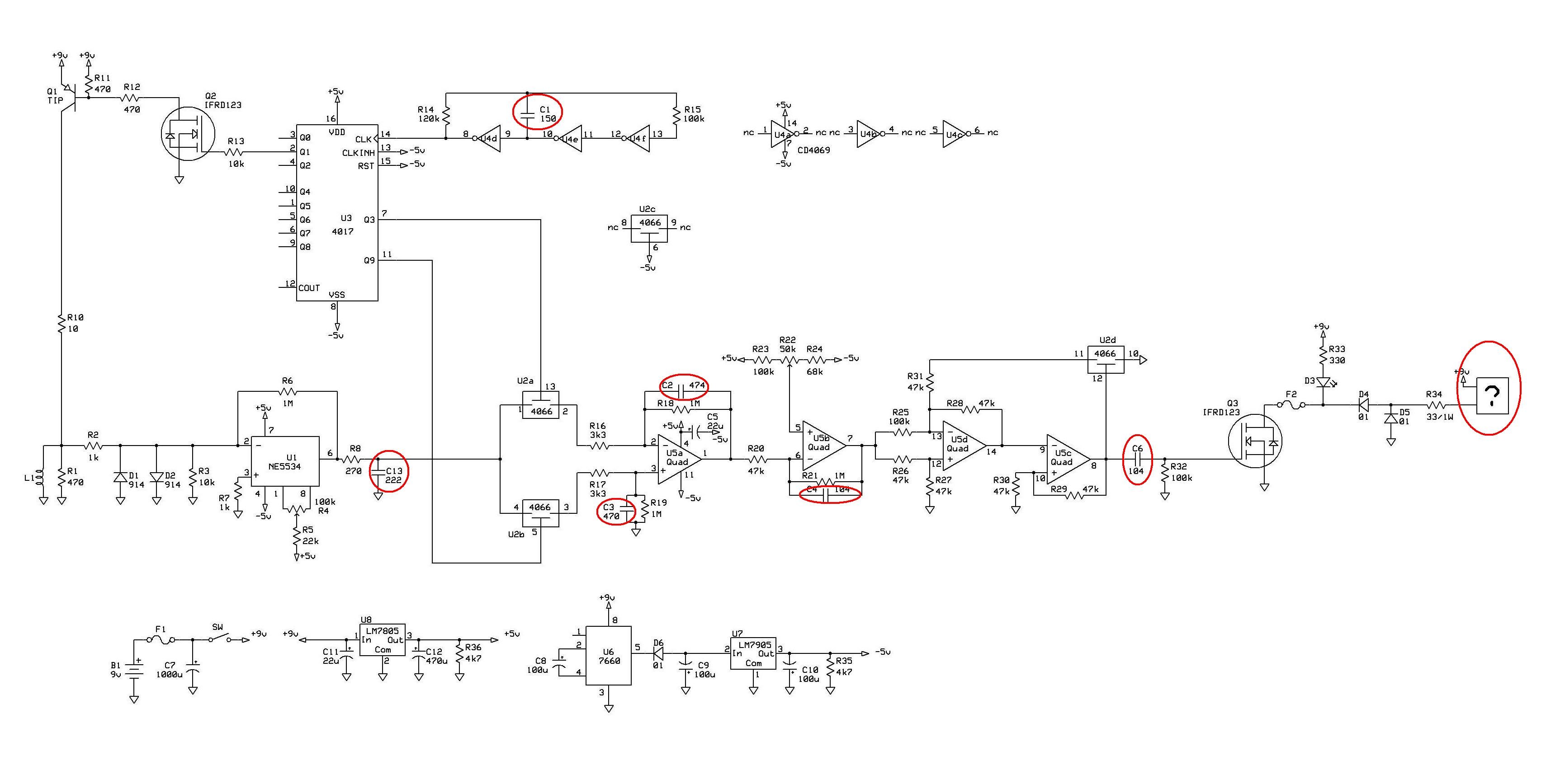

              Tony I tried to redraw your schematic in a way more suitable for my way of undrstandings.
              Though there are few things you can help me to understand.
              I put marks (circles, elipses) on the parts I would like to clarify, their values.
                OK, now I understand what you mean. A "Figure 8 coil".
                There are quite a few variations possible.
                Which variation is the best?
                The best variation is the one that best fits your purpose.
                Before deciding on what coil, we must decide on the purpose of the detector.
                The best electronics become useless with a bad or wrong coil.
                  ​​Click image for larger version  Name:	TonyDet.jpg Views:	0 Size:	392.1 KB ID:	417710​​
                  I will look it up. I actually still have one or 2 assembled PCBs.
                  Tentatively:
                  C1 - clock timer 120 to 150pico F
                  C2,3,4,6, = pico F, the last number being the number of zeros = 104 = 100,000pf = 100nF or 0.1mF
                  ? at the end = bone conductor clicker. Set at about 2 Hz for no target. Proportionally increases to about 120Hz with target saturation.
                  If I reember right, the detector was running at about 3000cycles per second.
                  • #99
                    Totally agree!

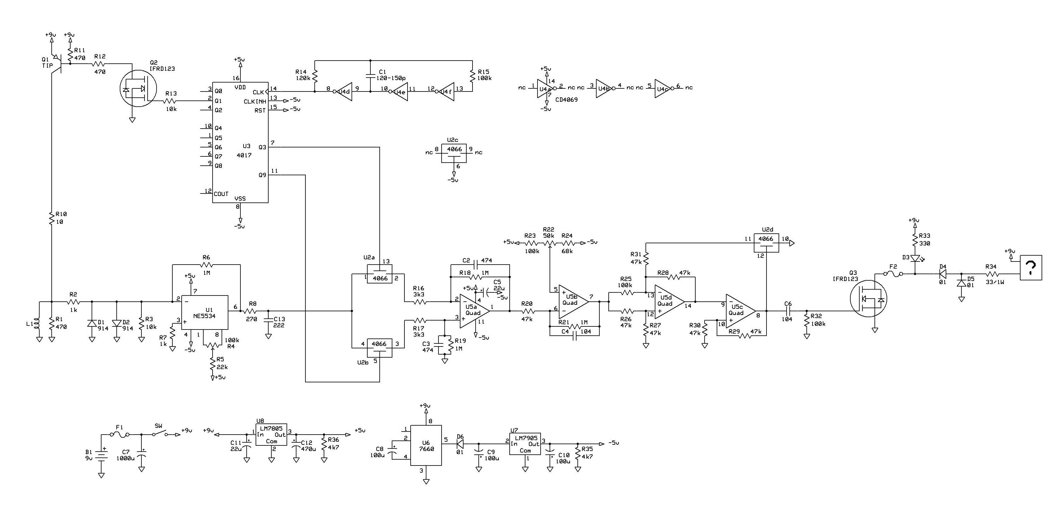

                    • Here is, I hope, finall schematic.
                      Guess what... I will make it.
                      I like such projects!
                      Just one more thing; bone conductor... kinda mechanical transducer right?
                      I would like there speaker instead it.
                      Would not be a problem to rearrange that part.
                      Thanks!

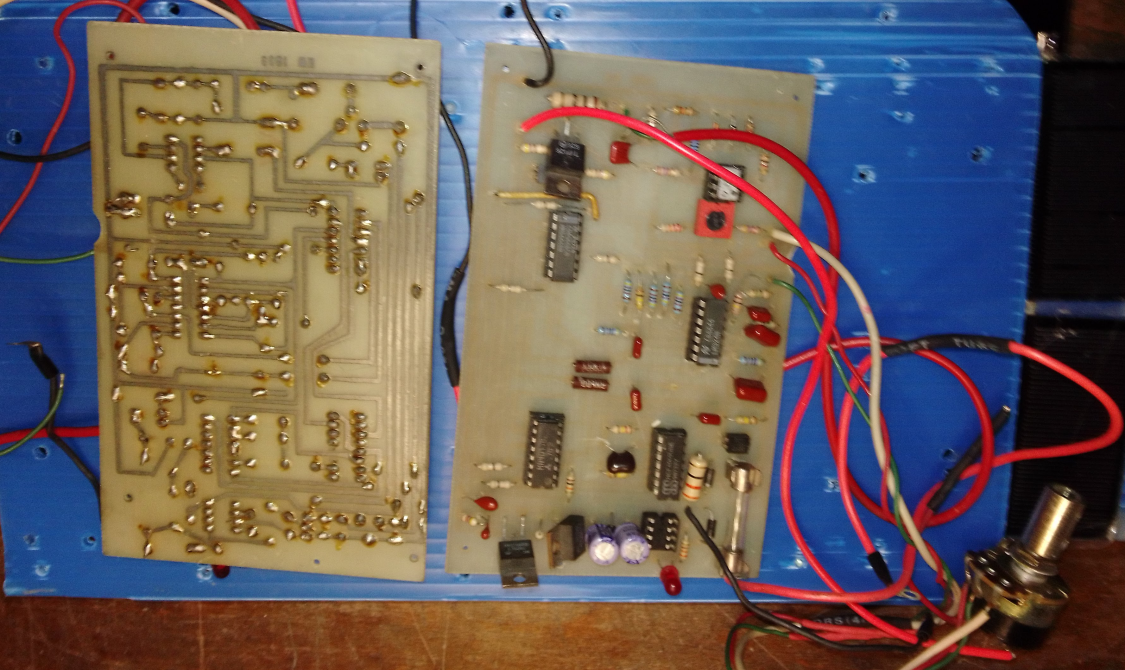

                      • Hi Thinkerer,
                        thanks for posting this great PI. Would be interesting to see some pictures of the actual detector and/or assembled PCB as well.
                          Totally agree!

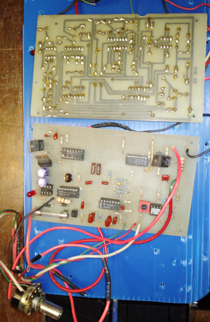

                            Hi Thinkerer,
                            It is amazing that these PCBs have survived all these years. Click image for larger version
Name:	KW_1_back and front_!.png
ID:	417728 Click image for larger version
Name:	KW_1_back and front_2.png
ID:	417729 I guess you could slap this circuit together on a breadboard and learn the basic functions of PI.
                            However, simple as it is, it was doing it's job at the time, so long ago.
                            After that, we can see how we can improve it.
                            Lots and lots of improvements possible.
