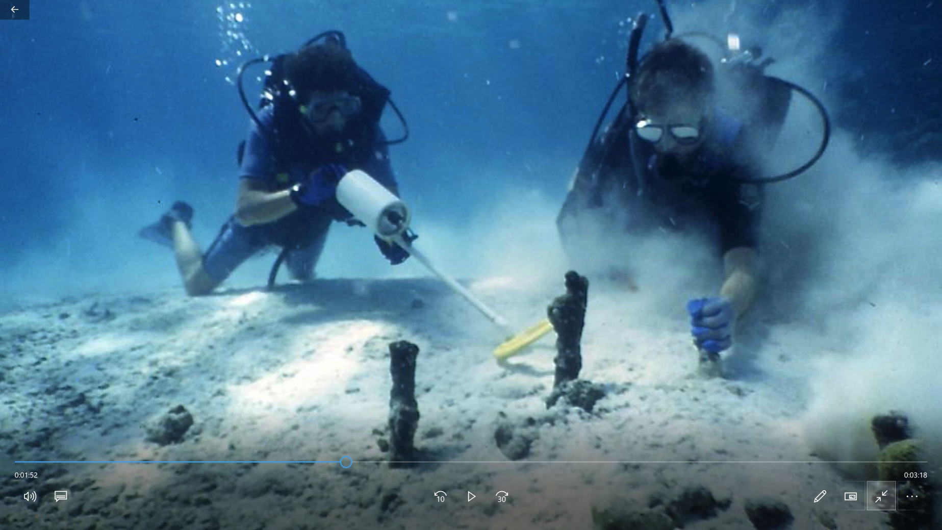

ID:	417747 Here is the KW_1 detector on a shipwreck. If I remember right, it was about 1996 on the wreck of a French galeon that wrecked in 1678 on the reefs of Aves Islands, off the coast of Venezuela.
          This is the small coil, about 20 cm diameter. I could also change to a 32cm diameter coil for deeper targets.

            • Originally posted by Tinkerer View Post
Name:	KW_metaldetector_on shipwreck.png
              Nice to see the actual device in use!!! I like it. Thanks again for posting the picture(s)

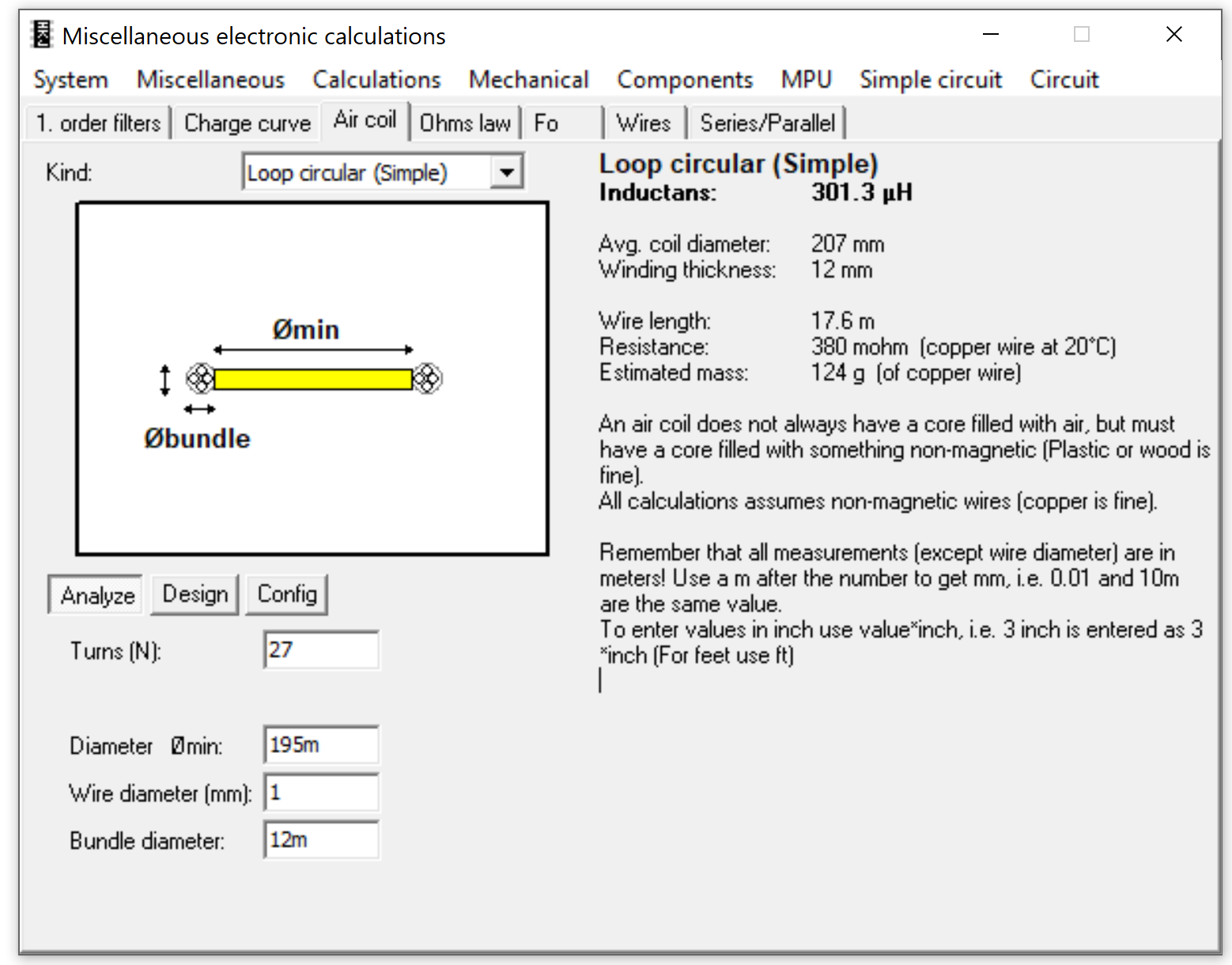

              • Hi Thinkerer,
                I have a question in regards to the coil of the KW-1. From the circuitry, I would guess the search coil has about 200-220uH. What coil inductance/specification has the actual search coil of the KW-1?
                Can you still remember?
                  Hi Thinkerer,
                  The small coil had about 300uH and 20cm diameter. 20AWG wire. Best to use 300V or 600V plastic insulated, tinned, 1x19 or even finer stranded wire, but for a cheap quick and dirty trial, magnet wire will work.
                  This detector was for underwater use, so it did not need shielding on the coil. For use on land, shielding will reduce EMI noise.
                  This circuit ran at about 3000 cycles per second. I think about 30us TX on - 30us delay to first sample- 30us sample time - second sample same 30us just before TX on again.
                  If you change the clock capacitor to a smaller value, the clock will run faster and all timings will be shorter, but remain relative.
ID:	417772 [ATTACH]n417773[/ATTACH] The MiscEl app is a good tool to calculate almost everything on a PI detector. It is old and I can not open the homepage, but the app in the Zip file should work. It does here. It starts giving some error messages, but just ignore these.
