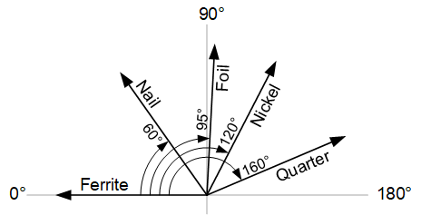

        I should have pointed out that this needs to work for the entire 180° of target space. I like to draw polar plots with 0° on the left and 180° on the right, opposite from normal trig, because that's how detector meters operate.
        So, for example, R/X goes to infinity for small foil. And X+R is negative for ferrous targets.

            1. So, for example, R/X goes to infinity for small foil.
            2. And X+R is negative for ferrous targets
            1. so put limit ( threshold ) if value is higher we know that is a foil.
            2. use abs( X+R )​,

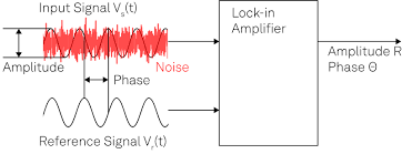

                    I think you are talking about: lock - in amplifier, which is not so good for metal detectors applications.
                      Can you explain your reasoning ? ( its not a lockin amplifier though )

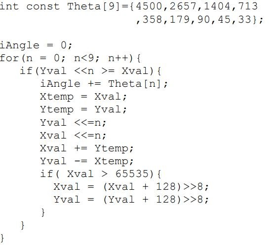

                        another solution ...
                        fast artan calculation using vector rotation.
ID:	417467Click image for larger version

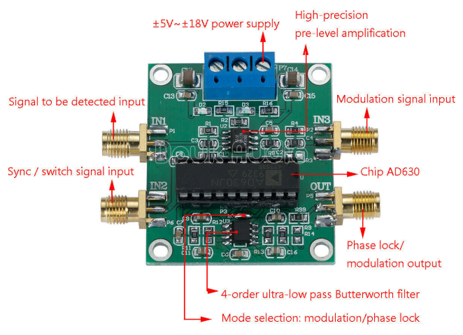

                          to big
                            hmm .. there are smaller ones on ebay etc ..

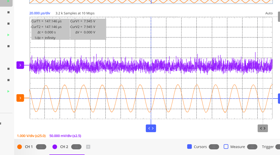

                              They are pricey ... or you can roll your own sig recovery and get results like this ...
