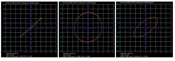

      well the human eye has the most powerful "DSP" in the brain behind it. What is needed is a signature analyser where the signals are represented as a shape / color maybe that changes with the target VDI / amplitude etc.
      eg the area and tilt of the circle changes with phase. Area changes with amplitude.
      Click image for larger version  Name:	image.png Views:	0 Size:	94.9 KB ID:	418644
