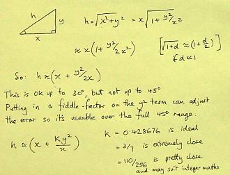

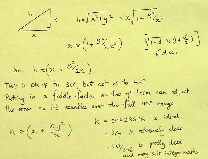

    To calculate the magnitude of your vector:
    Split the 0 to 180 degrees angle into 45 degree segments, and use an approximation that's good for 0 to 45 degrees.
    Swap the X and R values over for 45 to 90 degrees, for example.
    An approximation based on a parabola works well, amplitude errors of less than 1.03% can be achieved.
    Summary:
    Amplitude = x + 0.428676 * y2 / x
    Alternatives are A = x + (3/7) y2 / x ... very good
    and A = x + 110 y2 / ( 256 * x ) ... pretty good, maybe useful for computer maths.
    Attached explanation: Click image for larger version

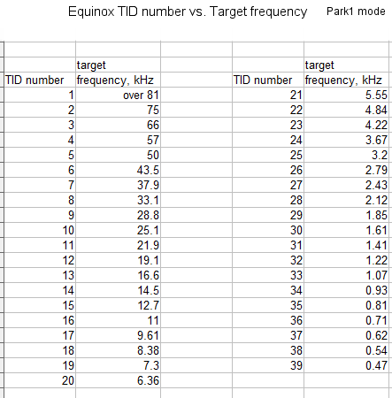

      Regarding the arctan function:
      Is arctan ideally what you want, or are you simply after a decent TID generator?
      I quite like what Minelab did with the Equinox 800 TID scale.
      I reverse-engineered it and posted my observations over on Steve's Detector Prospector Forum.
      They have made a very accurate logarithmic scale, so each ID value step represents a fixed ratio change of target frequency. This seems to get around the issues of stretching/squashing to get a practical useable scale.
      My analysis shows ML chose a mid-point "20" to represent a 25 microsecs / 6366 Hz target. The frequency step ratio is 1.147203 so that 8 numbers on the scale represents a 3:1 frequency change.
      The full "1" to "39" scale then covers about 80 kHz through to 500 Hz. This is targets about 13 times higher in freq than the 6366 Hz, and 13 times lower at the 'top' end.
      Mathematically, the TID value can be expressed as:
      TID = 20 + log10 ( fd / ft ) / 0.05964
      or 20 + 16.7673 * log10 ( fd / ft )
      where fd is target frequency and fd is detector frequency.
      The thread on Detector Prospector:
      https://www.detectorprospector.com/t...bration-table/
      The TID table is attached here.
      ​ Click image for larger version  Name:	EqxTID.png Views:	0 Size:	15.3 KB ID:	417658
      How to do a log scale?

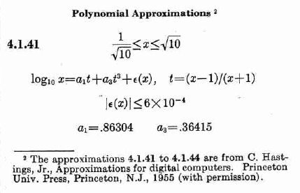

      Thanks to "Abramowitz & Stegun" , there is a simple and decently accurate log10 approximation, see attached image.
      Click image for larger version  Name:	logapprox1.png Views:	0 Size:	75.1 KB ID:	417656
      Source: ( see page 68 )
      Scanned Version of Abramowitz and Stegun, Version 1.1 (bham.ac.uk)​
      It's good for a full decade, from 0.316 to 3.16, and for our more practical purposes can be squeeked out to cover (1 / 3.5) to 3.5, a 1:12 range, and maybe a bit more.
      So it's ideal for covering the 0 to 45 degree range of the Equinox scale. Swapping the X and R components easily allows the 45 to 90 end of the range to be calculated.
      The practical details:
      Our x value we want to log covers the range 0 to 1.00, or more practically, 0.07 to 1.00.
      So pre-scaling this x up by a factor or 3.5 puts it in the log10 approximator's range. The resulting log10 then needs re-scaling back down, with a subtraction of log10 (3.5) = 0.54407
      because:
      log ( c * d ) = log (c) + log (d)
      So for example if we have x = 0.4; then 3.5 * x = 1.40.
      log10 (1.4) = 0.1461
      subtracting log10(3.5) gives ( 0.1461 - 0.54407 ) = - 0.3979
      which is the correct value for log10 (0.4)
      This can then be put into the TID formula above, to create a TID value.

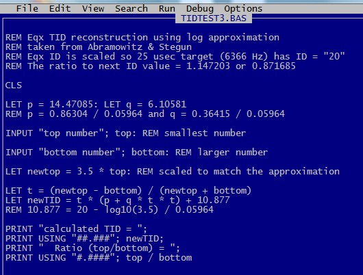

      I ran a simulation in QuickBasic, and it works impressively well, putting out TID values like "10.98" for a "11" target.
      The maths can also be simplified a lot to speed it up, only one division is needed.
      The log10 approximation takes in one number; we have a division of two numbers, ( m/n ) as our source.
      But it's not necessary to calculate ( m/n ) and then do a second division to find t.
      They can be combined:
      t = (m/n - 1 )/ ( m/n + 1 ) = ( m - n ) / ( m + n )
      Likewise, many of the scaling constants can be integrated / combined, reducing the maths complexity.
      See the attached screenshot of a QuickBasic routine for 0 to 45 degrees ( TID 1 to 20 )
      Example:
      A TID "10" target, 25.1 kHz frequency.
      Enter 'top' of the fraction as '33'; enter 'bottom' as '130'
      and the result is a "10" give or take a tiny bit.

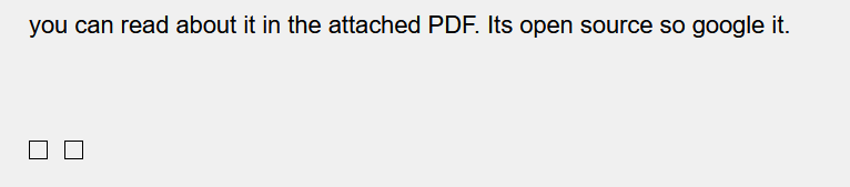

          What process do you use to attach files & pics? Because they occasionally don't show up. I need to chase this down.
          • #50
            ​Click image for larger version
            err the "usual" way from the post editor. Some where png format ... it seemed to work for me. I could see them but nobody else ??
            The last post I thought I attached a PDF also .. I cant see it.
            here it is.
            • #51
              There are different ways even from the editor. I simply drag-and-drop items right into the editor window. Or use Window's snip tool to do a screen capture, then paste in the editor window.

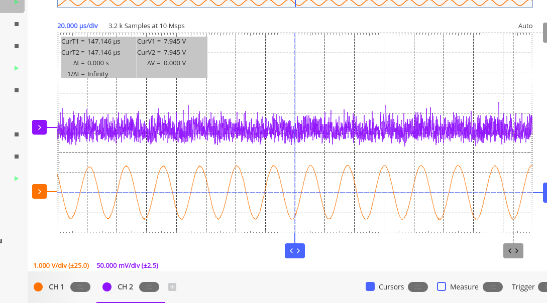

                The main blocks for an advanced VLF IB metal detector will require ...
                1. AIB ( Active Induction Balance )
                2. LLIA (Log Lock In Amplifier )
                3 PAD ( Phase Detector )
                AIB will largely counter magnetic grounds. Amplitude vs frequency ( khz )
                ​​​​​​​TX1 is the main TX coil. TX2 is the bucking coil.
                ARM radios software is rearranged
                to form a VDI detector ..
                ​​​​​​​and all we need is the MAGIC log amplifier for sine waves ​
                as we cant use an ordinary "LOG" amplifier as the phase information is lost ( must maintain phase and log of amplitude gain)
                We cant use this ... the phase info is lost and the log amplifier is wideband .... it will log all the input noise and as well.
                We need the response below ... The noise is removed. The phase is intact. The sine wave RMS value is a log value but the waveform is not log distorted.
                Click image for larger version  Name:	inout.png Views:	0 Size:	93.0 KB ID:	417803​
                ... should then have a motion / non motion hi spec detector ( adding batteries / cases / LCD bling etc etc etc ).
                ​​​​​​​moodz

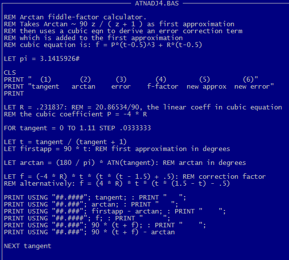

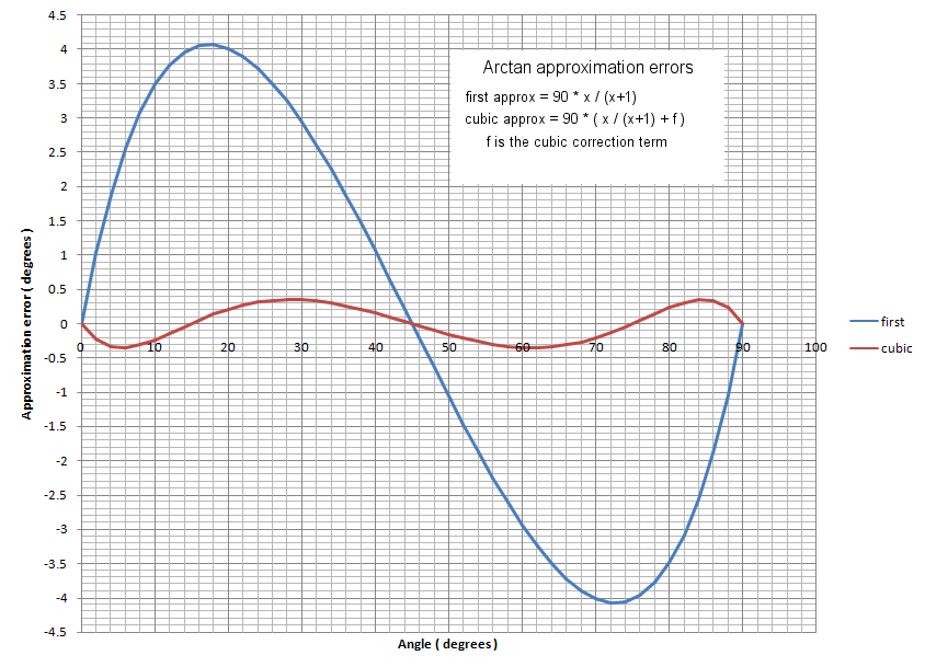

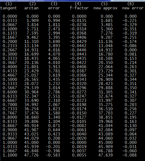

                          Seeing as this 'challenge' seems to still be open ( no response from Carl ) , I spent some time over the Christmas holiday working on an Arctan approximation. I'm quite pleased with the result.
                          I started with the simple approximation:
                          arctan (x) ~ 90 * x/(x+1)
                          This was discussed in the previous 'arctan' thread:
                          Arc tangent function - Geotech Forums (geotech1.com)
                          It's correct at 0, 45 and 90 degrees, but can be over 4 degrees in error elsewhere.
                          The error term resembles a cubic equation, so I worked out a cubic correction term and computer-optimised it.
                          The resulting new approximation has an error of only +/-0.35 degrees over the full 90 degree range.
                          In summary:
                          (1) calculate t = x/(x+1) ... or t = opposite/(opposite+adjacent) if you have I and Q values.
                          (2) calculate f = -0.92735 * t * (t * (t - 1.5) + 0.5)
                          (3) Revised arctan approximation = 90 * (t + f)
                          Attached is a pdf explaining my calculations. There's also an Excel file with a full example (when I work out how ..) and the resulting error plot for the simple approximation, and the revised 'cubic' version.
                          I originally did all the calculations in QuickBasic, so I've attached screengrabs of example code and results. The .XLS file is probably easier to play with, though.​
                          Click image for larger version  Name:	ArctanCubic3.png Views:	0 Size:	47.5 KB ID:	418631
                          Click image for larger version  Name:	AtnAdj1.png Views:	0 Size:	34.9 KB ID:	418632
                          Click image for larger version  Name:	AtnAdj2.png Views:	0 Size:	31.0 KB ID:	418633
                          IMG3_20240104_0001.pdf
