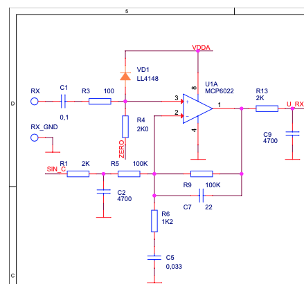

      All the time I think about the "auto-zero" circuit in non-motion detectors, whether it is IB or PI (probably a different morphology).
      Ok, let's go slowly, so we have a non motion detector. It usually has a button next to which it often says "tune" or "retune" or "reset"...
      When the detector starts to drift; you press that button and it calms down.
      What is the name of the circuit that does that?
      I remember the button you're talking about, as I used to have a old non-motion Tandy detector that had one. I found a lot of stuff with that detector.
      Are you wanting to replace it with a "Self-adjusting Threshold" (SAT)?
        It is done in Quasar Arm, look R1 SIN_ C
        So that we don't have to press that button often.

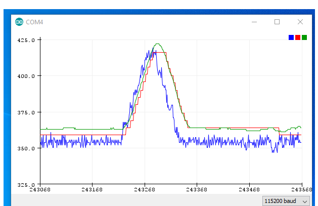

          I am using STM32F103 and do not observe problem with that, what is slowing down program is method of removing the noise, filters, averaging etc,
Name:	noise amplitude.png
          delay in amplitude filtering

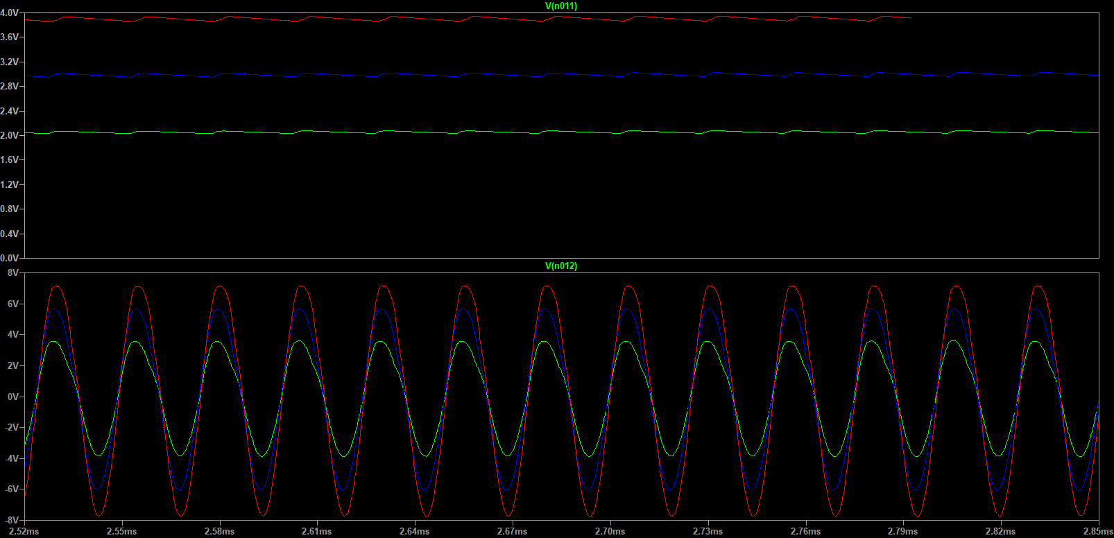

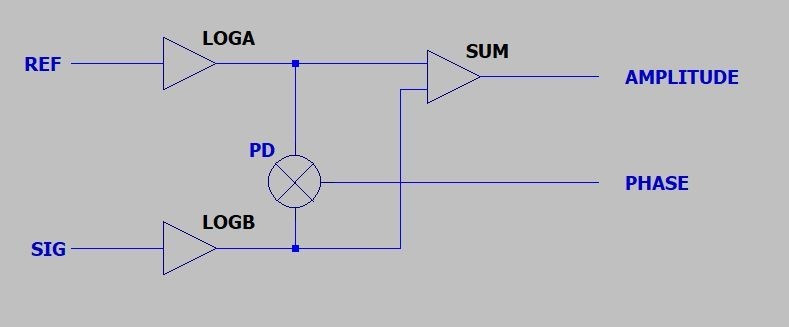

                I posted the solution in post #3 it is performing this extraction using logs .... can be achieved with very simple analogue hardware.
                The pic below shows the output from extraction of 30mV / 300mv / 3volt input waveform with 100 mv peak peak noise to give a log recovery output with noise removed.
                The top trace is the log level recovery.
                The bottom trace is the waveform phase recovery.
                I would probably need a high spec ADC to perform the same in DSP.

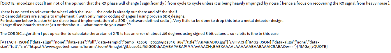

                          I am not of the opinion that the RX phase will change ( significantly ) from cycle to cycle unless it is being heavily impinged by noise ( hence a focus on recovering the RX signal from heavy noise ).
                          There is no need to reinvent the wheel with the DSP .... the code is already out there and off the shelf.
                          IQ demodulators are simple to implement. ( with only minor coding changes ) using proven SDR designs.
                          Ferinstance below is a stm32f4xx disco board implementation of a SDR ( software defined radio ). Very little to be done to drop this into a metal detector design.
                          STM32 disco boards start at $20 or therabout ... what more do you want.??
                          The CORDIC algorithm I put up earlier to calculate the arctan of X/R is has an error of about .06 degrees using signed 8 bit values ... so 12 bits is fine in this case
