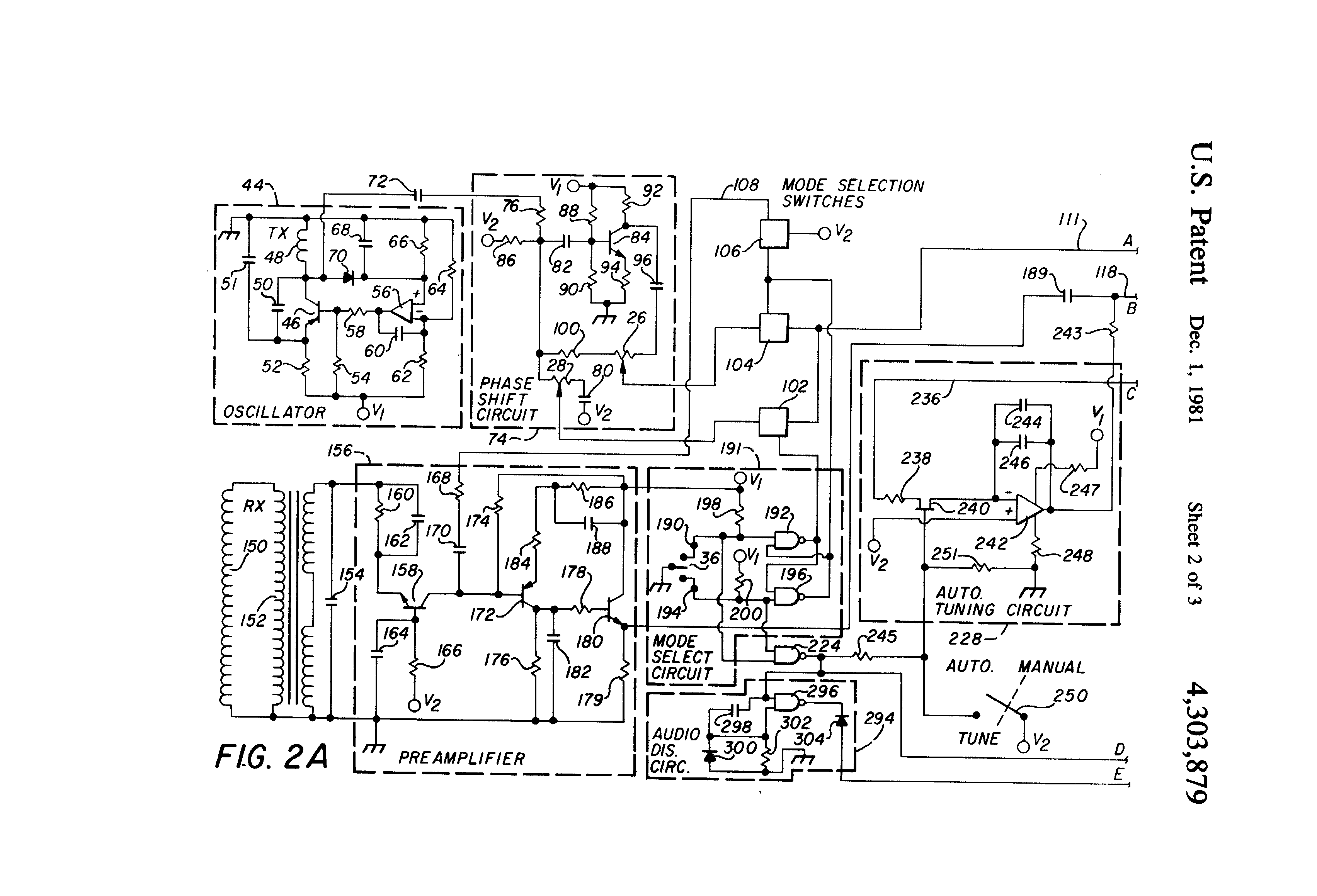

                    All the time I think about the "auto-zero" circuit in non-motion detectors, whether it is IB or PI (probably a different morphology).
                    Ok, let's go slowly, so we have a non motion detector. It usually has a button next to which it often says "tune" or "retune" or "reset"...
                    When the detector starts to drift; you press that button and it calms down.
                    What is the name of the circuit that does that?
                    I'm interested in that circuit, to design it better, to be more perfect, to constantly keep the detector in "balance", whenever it drifts; for that circuit to return it.
                    So that we don't have to press that button often.
                    It would be cool to make a concept of such a circuit for both PI and IB detectors. Let's say Delta Pulse knows to drift and PS2 as well,
                    I remember that Cscope 1220B was drifting so I often pressed that button. And there are countless other examples.
                    Every time I say "auto-zero"; I mean that, to such a stage in the detector, ok.

                        I was hoping for analog solutions... but somehow everything slipped back into the domain of programming.
                        Ok, that's what you called the topic.
                        Is there anyone interested in analog solutions?
                        If this all boils down to software solutions; it's not my cup of tea.
                        I am exclusively interested in an auto zero solution with analog circuits.
                        But to be advanced and efficient.
                        I won't bother you anymore, feel free to continue.

                            There are auto tune implementations ... heres one from Garrett again ( patent expired ).
                              I know that, not good enough!
                              There is slightly better one in White's Eagle series, forgot the exact schmatic, but I am sure I have it... also not good enough!
