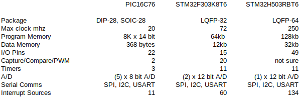

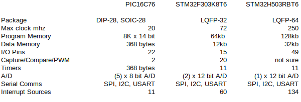

                  2) On the STM32 selection - the criteria I came up with:
                  a) Only LQFP packages - to make hand soldering realistic, preferrably LQFP32
                  b) There is a Nucleo board with the selected processor - so that breadboarding can be done on sections of the MXT instead of having to build the whole control board first, and then chunks of the firmware developed.
                  c) Select the highest end version of each of these
                  With these criteria there are two choices:
                  STM32F303K8T6 as LQFP32 - and it's NUCLEO-F303K8 dev board - in the NUCLEO-32 family.
                  STM32H503RBT6 as LQFP64 - and it's NUCLEO-H503RB dev board - in the NUCLEO-64 family.
                  Since the STM32F303K8T6 / LQFP32 will be much easier to hand solder I'm trying this first. My NUCLEO-F303K8 arrived today, and I rummaged around and found I have a LCD 4x80 I2C display, and a color touch screen I2C TFT display, so will begin with these (the LCD 4x80 first) as I breadboard bits of the circuit.
                  Processor comparison:
                  Click image for larger version  Name:	image.png Views:	0 Size:	29.2 KB ID:	447970​

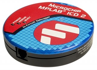

                  • You Will Need MPLAB InCircuit Debuger 2 who has exclusive option to download and debug firmware a developer mode programmer:
                    https://www.microchip.com/en-us/deve...-tool/dv164005
                    Click image for larger version  Name:	MICD2.jpg Views:	0 Size:	26.0 KB ID:	447981
                    It only 2 has a unique feature to download firmware from PIC and dissansembler in IDE MPLAB

                      Ok many thanks for that.
                      The ICD2 requires MPLAB IDE v6 or higher, I'm running v5.7.4, I'll have to see if the firmware in my PICStart Plus programmer will work with MPLab v6 or higher (hope so). If so I'll look into getting an ICD2. I see there are some ICD2's on eBay...
                      I'll make another Win10x32 To Go drive and install MPLab IDE v6 and see what support looks like. One problem may be PIC16C76 support - I already saw an ICD2 overview doc stating the ICD2 does not support the PIC16F76 (and therefore PIC16C76 also?), but maybe it was an early version doc?...Best way to know is to install the newer IDE to get the readme's and check the support...I'll do that this weekend...

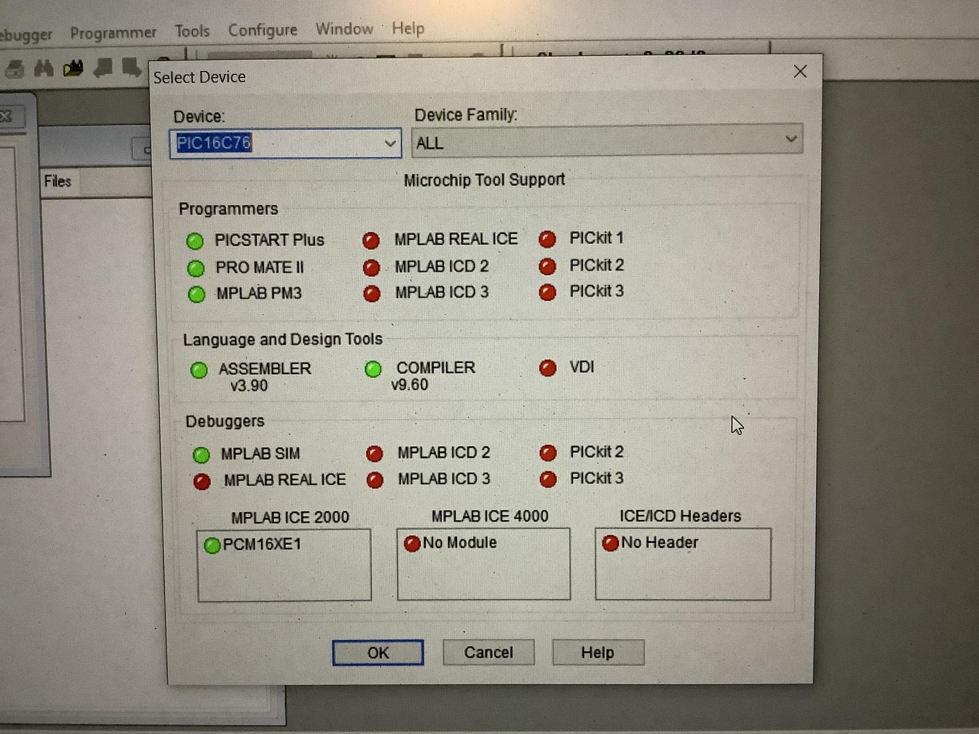

                          • Well the better news is that since I upgraded the firmware in my PICStert Plus I can now run the latest (and last, before MPLab X IDE) version of MPLab IDE - v8.9.2
                            The less than better news is that the PIC16C76 appears to not have any debugging capability designed into it's silicon, and therefore is not supported by any of Microchip's debuggers as seen in the attached screenshot. Just the same I'll take a shot at my PIC and see what I can do...
                            Click image for larger version  Name:	IMG_2586.jpg Views:	0 Size:	493.0 KB ID:	448025
