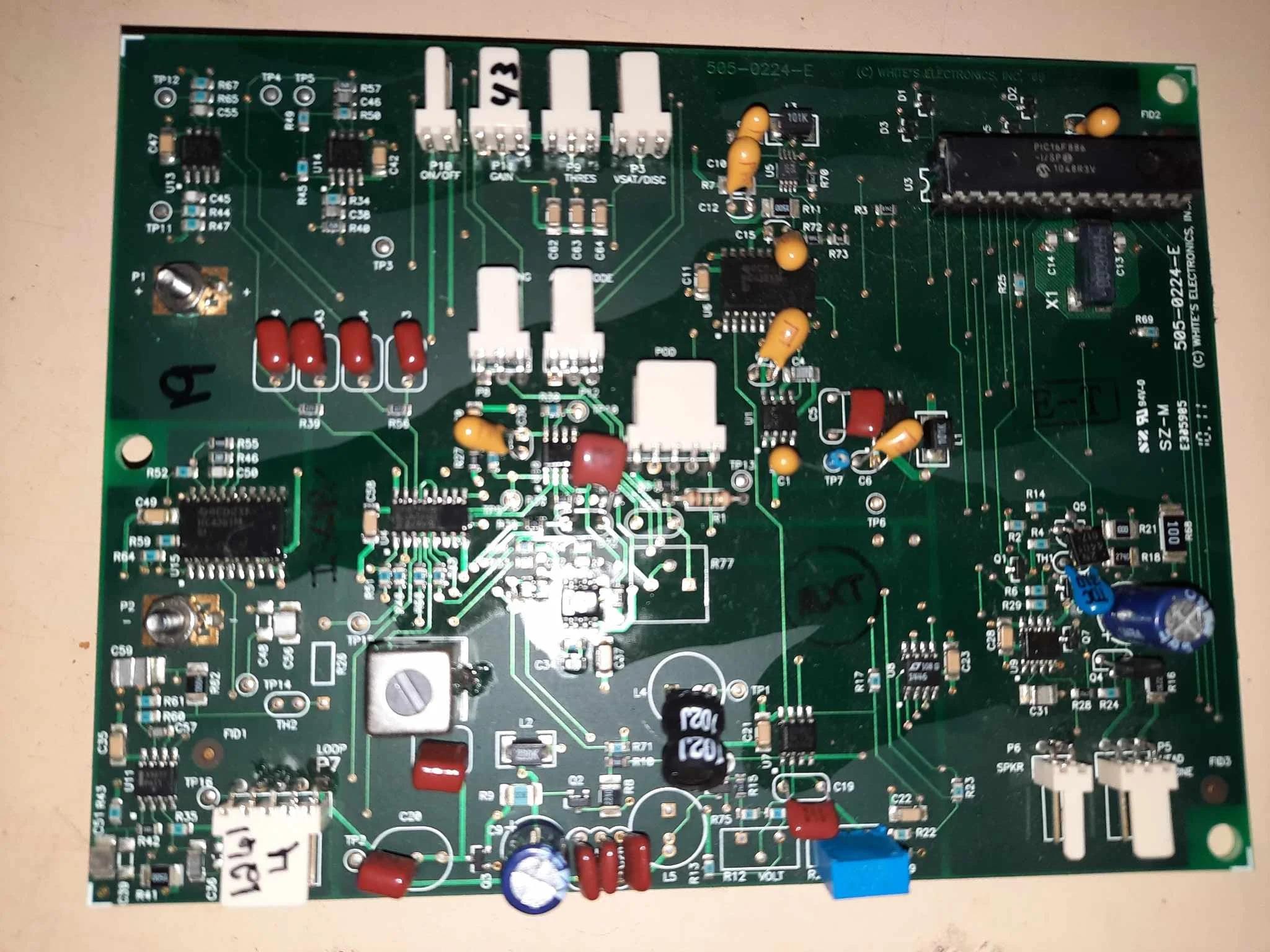

      The focus should be shifted to the electronics of the detector itself, to the design, other mechanical and cosmetic things are less important.
      How realistic is it to get to the original schematic?

              Click image for larger version  Name:	Whites MXT E series pcb.jpg Views:	0 Size:	456.9 KB ID:	446916​
              Nice pic, would this be the MXT control board? If so, wonder if it's possible to download the firmware from that PIC controller?...
                I believe this is the complete text of the MXT engineering report:
                          Thx again for this pic, I've started a couple searches to try to acquire one of these boards and/or a broken MXT for research.
                          I'm also searching for info on how to download the code from the Microchip PIC16C76 that the MXT uses. So far I see this is the One-Time-Programmable version of the chip, that the programmer and IDE can still be found, and so far I haven't seen any code protections covered in the datasheet, but also don't yet see a method to download the code. Per the datasheet the IDE is used to compile and upload code to the PIC, not clear if the IDE has read capability from the PIC, I'm still reading the datasheet though...
                          And of course this project could use a more modern controller, in which case the existing code wouldn't be of much use, unless the existing code could be reverse compiled - unlikely but maybe...back in the day my first and fav language was Assembly, then C as a shorthand for Assembly...but that was a long time ago...
                            The original MXT board used an OTP chip that was read-protected. It was updated when I worked there to use a later version chip (for the MXT Pro) that could be reprogrammed, but it was still read-protected. It is possible to defeat the read protection and extract the code but it's a complicated process. An easy solution is to send the board to China and one of the hacker houses will send you back the extracted binary, but it costs around $500. Might be able to find someone who will do it cheaper. The binary can be decompiled to assembly language and then maybe AI can clean it up and even convert to C.
                            The Chinese cloned the GMT which uses almost the exact same circuitry and mostly the same code as the MXT. It's possible the GMT clones are not protected. In any case, they are a lot cheaper to buy and cannabalize. But if you want to extract the code with them most features, it would be the MXT Pro or the MX Sport.
                            The original MXT was developed by Dave Johnson and all the code was written in assembly language. There were a lot of fudge factors in the code, often with the comment "this seems to work." I had a co-op student convert all the code to C and port it to an STM processor -- that was released as the MX5, and later used in the MX Sport and GM24K models.
                              I owned the GMT for more than 12 years before I even knew what GMT stood/stands for (Ground Measure Technology).
                              GoldMaster Tracking
