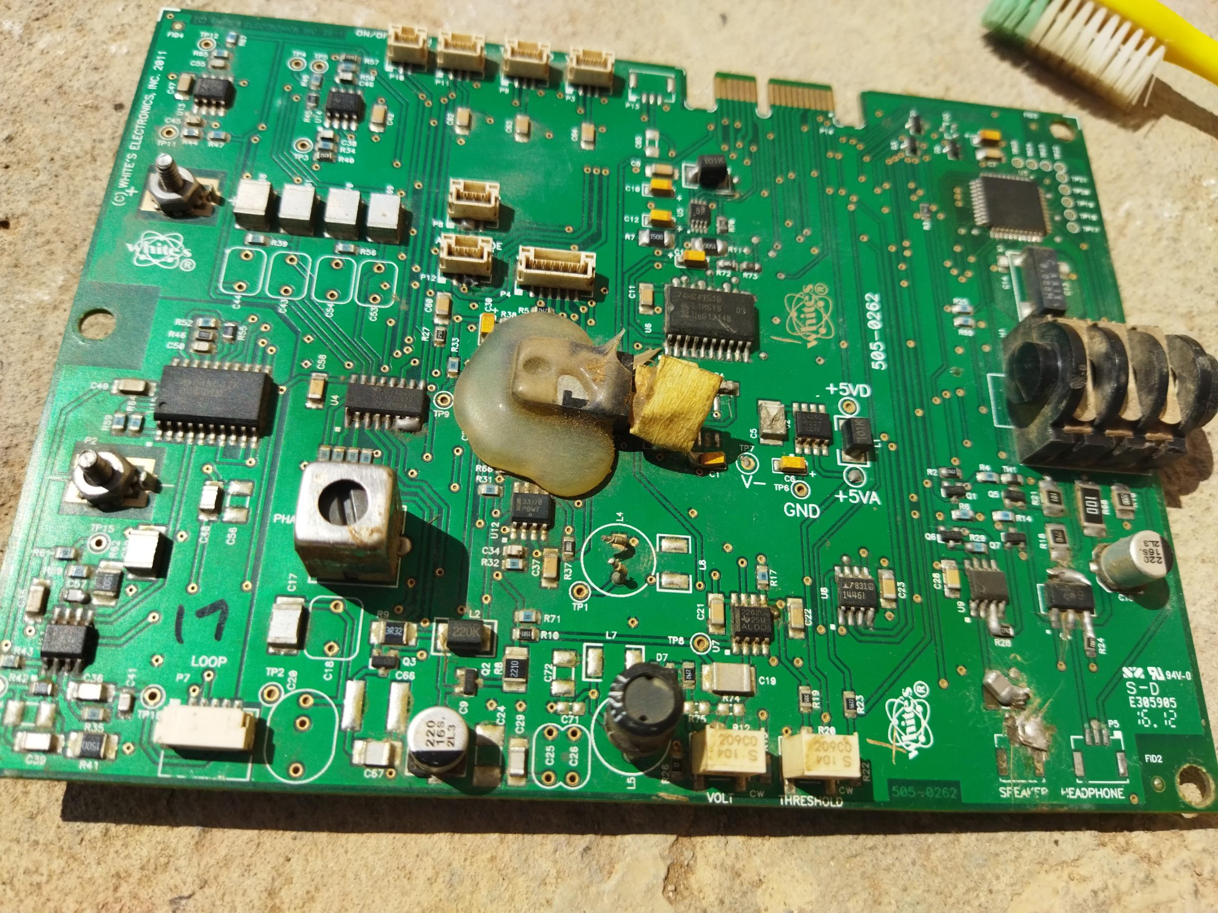

          If it helps any, in that pic that ivconic posted of a MXT PCB (probably a later revision PCB) I'm guessing it to have a 28 pin PDIP MicroChip PIC16F886 - but not sure as it's number stamp is not clear when zooming in...pretty sure ivconic found the pic on the web, and so probably doesn't have clearer pics...

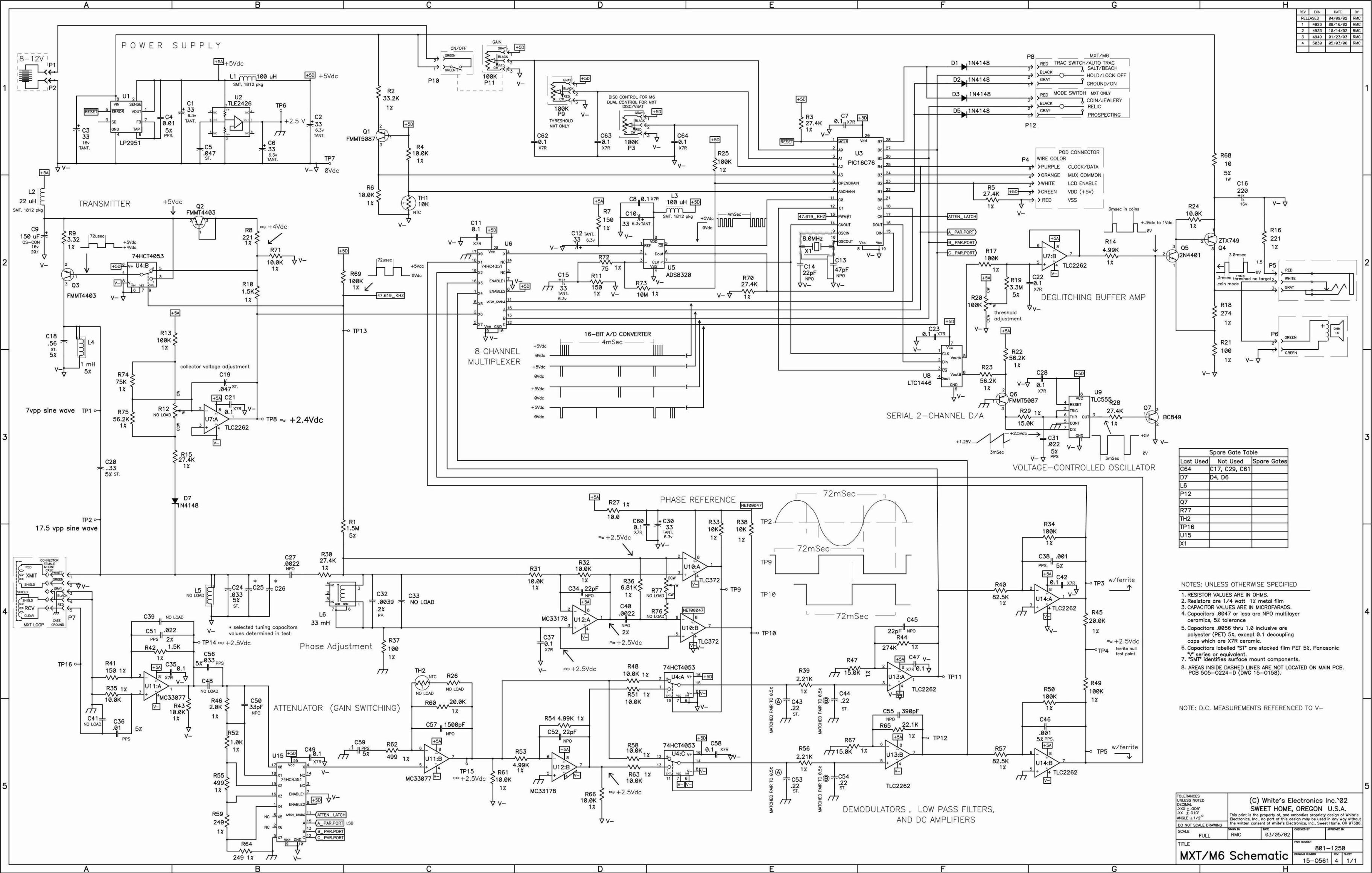

            I was surprised when I found a schematic in my archive! I don't remember where I got it from.
                  Wow, and I am beyond surprised - I didn't think we'd be so lucky as to have the schematic! Nice job, well done, thanks for posting to you and it's source. It's a wealth of information and ideas for this project. Now a zip of the C would make the complete set haha...

                    Interesting to compare the 2, also interesting the information present on the MXT board e.g. looks like the connector near the center marked P00 (I'm guessing) goes to the display, and if so that it's probably a SPI link, and that the toggle switch under the display probably also goes through that link (still guessing) - update - after looking at the schematic and PIC16C76 data sheet, looks like neither I2C nor SPI is used, but some unique coded serial method (still guessing though).
                      Here is a look at the pod. It uses a 74164 shift register for a serial to parallel convertor to drive the 16 x 2 LCD. You can also see a 555 timer and a CD4051 multiplexer.

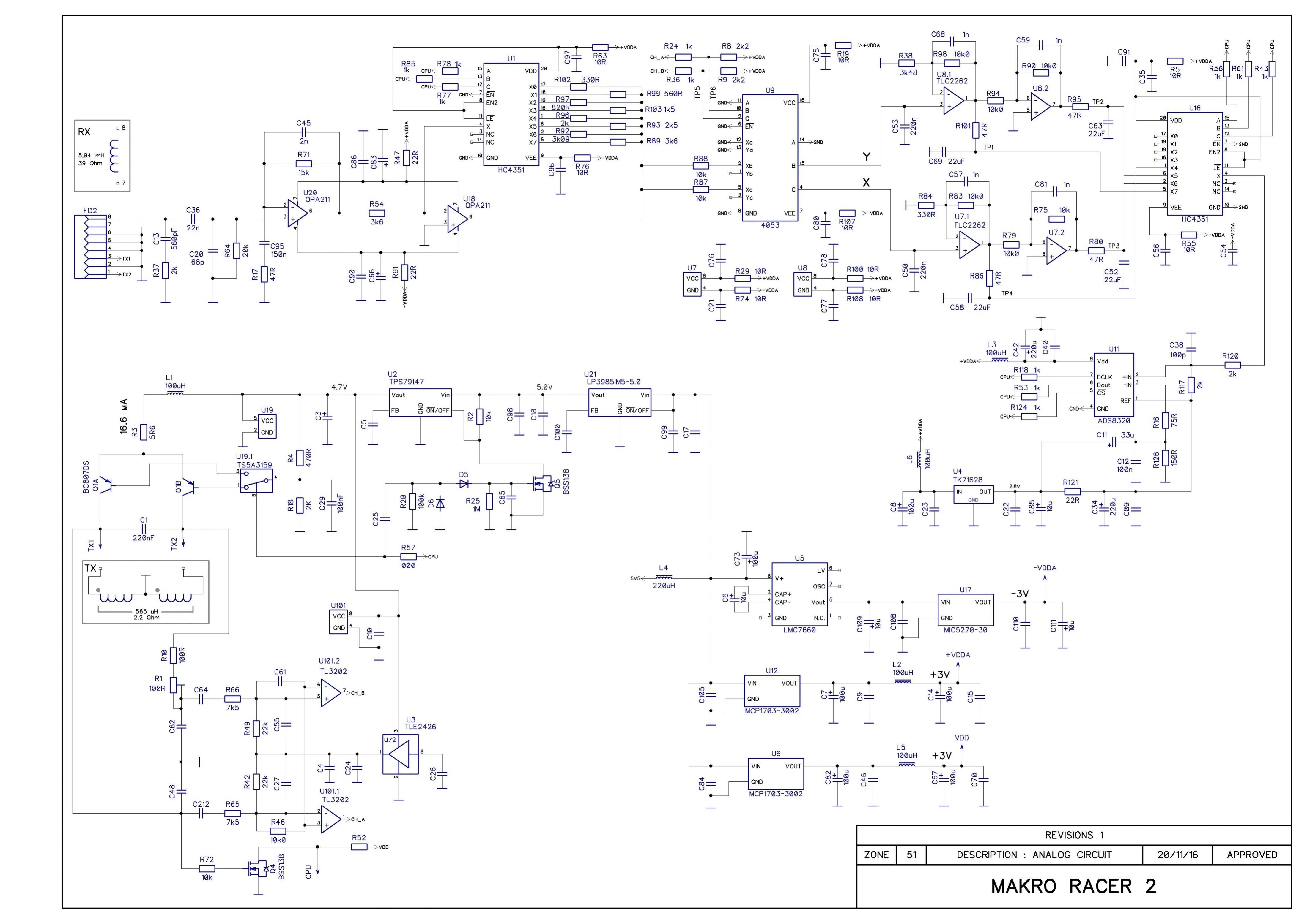

                          A partial schematic of the Makro Racer was posted here on the forum a while back. One of the members here claimed it was a copy of the MXT. Looking at the two schematics the Nokta engineer did duplicate many parts from the MXT.
                          Makro Racer

                            If it helps any, in that pic that ivconic posted of a MXT PCB (probably a later revision PCB) I'm guessing it to have a 28 pin PDIP MicroChip PIC16F886...
                            That was an interim replacement for the 16C76, I think prices were going up so we swapped out for another chip.
                            Post #22 shows the old-style MXT/GMT board on the left, and the new style MXT/MXT Pro/GMT on the right. I switched all the caps and connectors to SMT, the processor is a 44pin QFP, and there is a new PCI edge connector for manufacturing. Sorry, don't know which micro, still a 16F PIC though.
                              The Racer was a hardware clone of the Teknetics T2, except that the T2 used and MSP430 and the Racer has a PIC24. The T2 was designed by David Johnson after he did the MXT, so it was basically an "MXT-2". That's why the Racer looks a lot like the MXT.
                                That's interesting to know. Looking at the MXT schematic it shows a cycle time of 4ms for the adc. Would that be a single sample or for all the channels?
