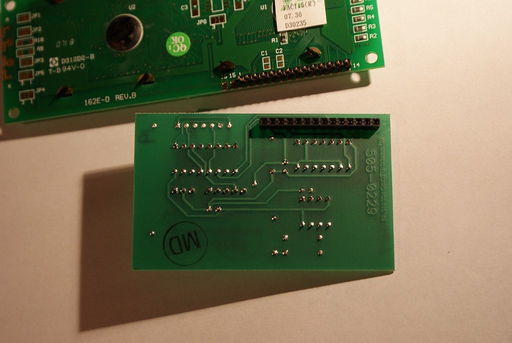

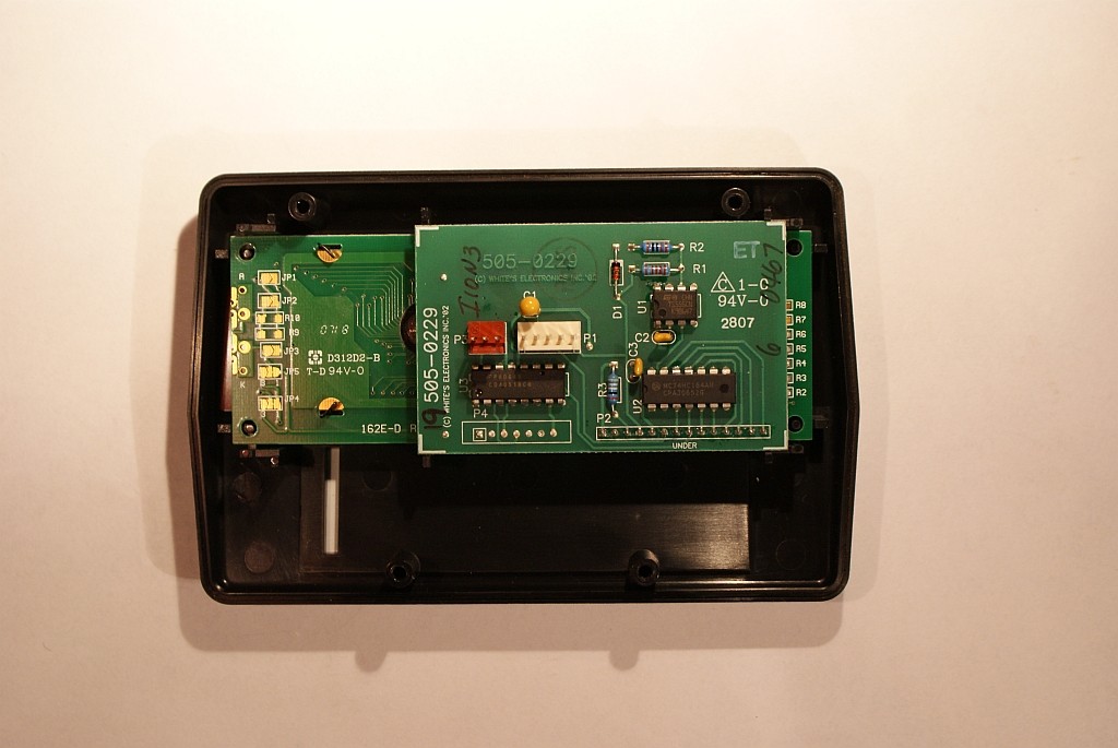

        Here is a look at the pod. It uses a 74164 shift register for a serial to parallel convertor to drive the 16 x 2 LCD. You can also see a 555 timer and a CD4051 multiplexer.
        Thanks for the schematic Ivica!
        Click image for larger version Name:	MXT_505_0229_top.jpg Views:	0 Size:	114.5 KB ID:	446993
        Click image for larger version Name:	MXT_505_0229_bottom.jpg Views:	0 Size:	125.5 KB ID:	446994
        Hmmm, and thanks for posting these, looks like a pretty simple display to repair or possibly mod (backlight for one mod), and with that thought in mind the RevD control boards vs the RevE to me seem more repairable, and since Micro PIC16Fxxx's are still available and pretty cheap - genuine MicroChip ones run something like $2.70 USD in single quantities - a PIC with our own code could be tested in a RevD board by just plugging it in, before testing in a newly designed control board as well.

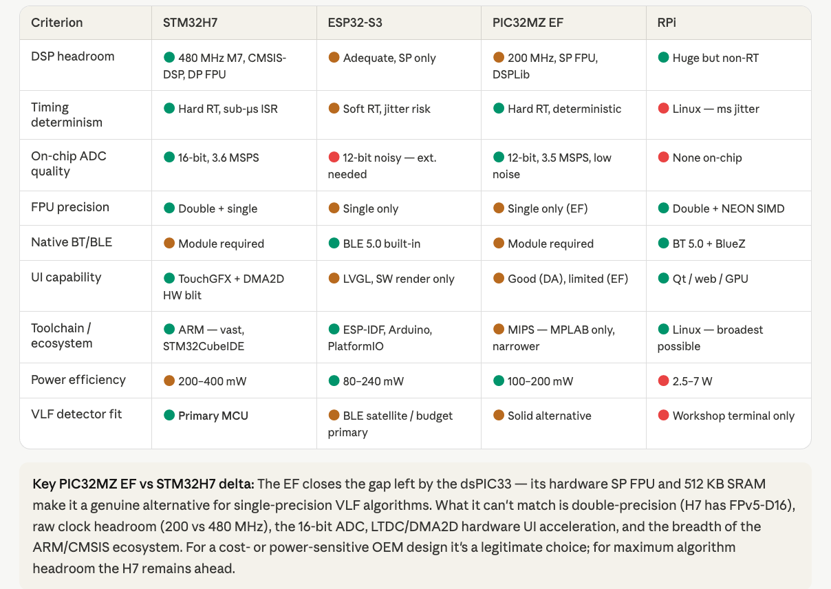

                      While searching for Bluetooth solutions I came across the ESP32 and the Raspberry Pi Pico WH. They each appear to have pretty capable dual core processors. I'm wondering if they could be the microprocessor instead of just a shield for the Nucleo. I'm kinda thinking out loud here as I haven't gone over their datasheets for their I/O ports, A/D capabilities, and such. I'm thinking if they are not a suitable standalone micorprocessor then the ESP32 on a Nucleo could be a nice core to build around. Have to spend some time determining which Nucleo would be best... To me Bluetooth is important - I pretty much always detect with headphones, and am so done with the headphone cord! Actually earbuds would be far better than over ear IMO.

                            I'm interested to hear thoughts on whether the ESP32 or Raspberry Pi Pico WH (the one that's just a shield/hat) could take the place of the Nucleo and be the processor...
                            open the attachment in a webrowser for a comparative view.
                            I am trying out the ESP32 on a VLF at the moment .. but that is with an external demod and ADC. If you go internal demod with a straight conversion ADC ( ext or internal ) then the STM32 wins handsdown.
                              Click image for larger version  Name:	image.png Views:	0 Size:	206.1 KB ID:	447028​​
                              Wow!, now that's a comprehensive evaluation, invaluable, thanks. So it seems clear the STM32 wins. On the RPi I was actually thinking about the newer RPi Pico WH with Bluetooth, but looking at it I don't think it has the peripheral support needed, and probably is less suited than the RPi5 in the chart.
