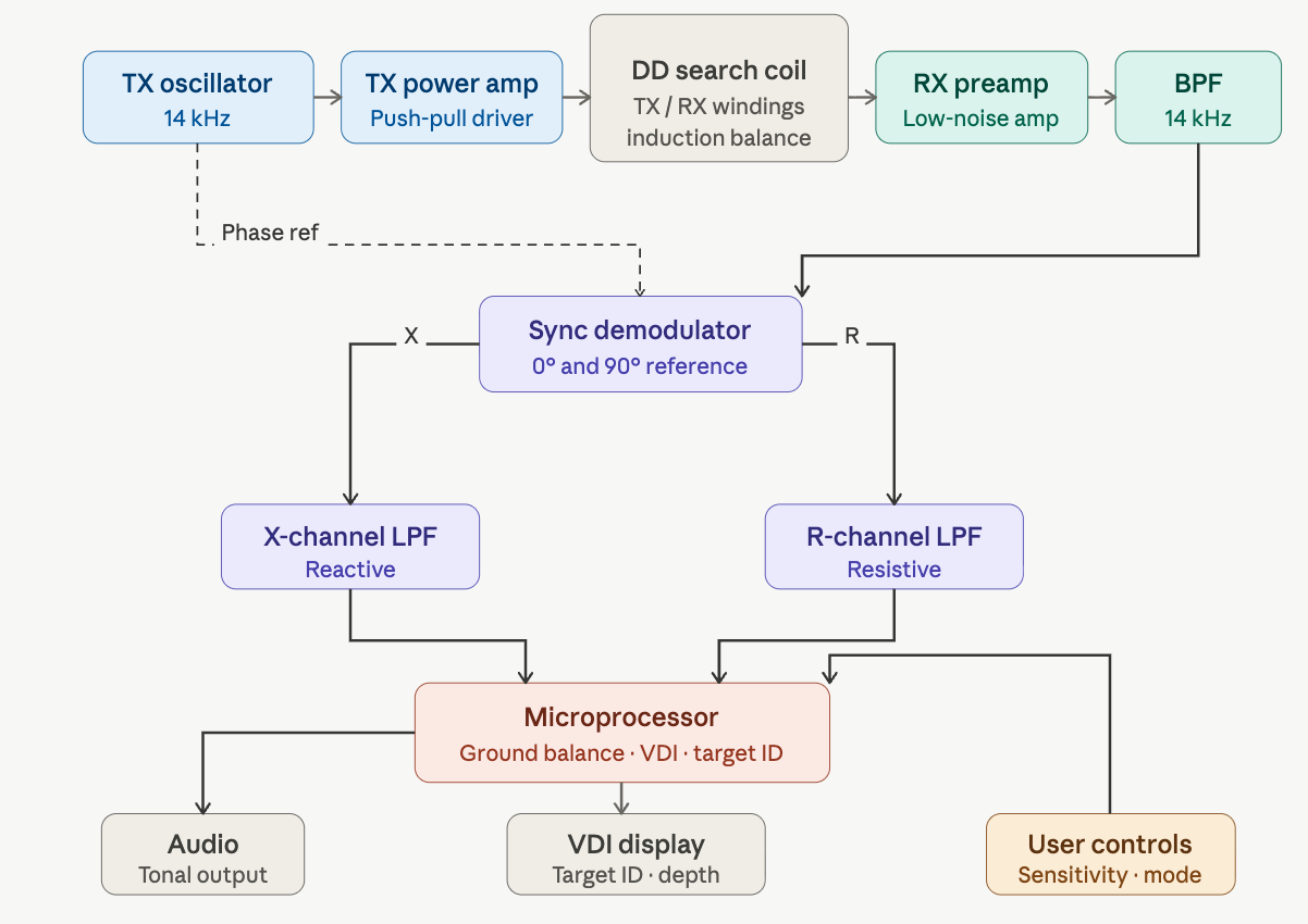

        • #49
          For prototypes you can most always find the CPU you want on some little board with 0.1 inch headers for everything. ( Alibaba :-). )
          Before you choose your CPU ... one plan is to determine what the signal flow / main blocks are and how much grunt ( code wise )
          is required to do the heavy lifting.
          There is nothing worse than choosing your CPU and finding down the track you are missing that extra PWM, or DMA, or the interrupts wont fit into your DSP cycles.
          Rule of thumb is go big or go home. If you find you oversized your CPU ... you can downsize it much more easily than upsizing it.

              • #52
                Click image for larger version  Name:	image.png Views:	0 Size:	99.7 KB ID:	447073​
                Nice block diagram, that could be the 60k foot view diagram for this project.
                Between you and Carl and everyone haha I'll just throw a huge micro at this project - that is mostly just spinning nops - but who cares if there's no price or power penalty. Back in the day, good design required disciplined product selection without waste or excess, but back then there were very much both power and price penalties. Anyway big horsepower and resources it shall be...not ready for a specific micro selection yet though.
                Will be continuing my discovery of the whole ST-M ecosystem in the background and will ocassionally bring up a specific micro or nucleo or dev kit for this project.
                I think, in the background for starters, I'm going to get a cheap Nucleo F or H and setup the ST CUBE system, and redo some projects on the Nucleo - just to get used to the STM tools.
                If I find there are socketable STM32s - can also see myself making a socketed nucleo board in KiCAD where I can plug in a range of STM32's and experiment.

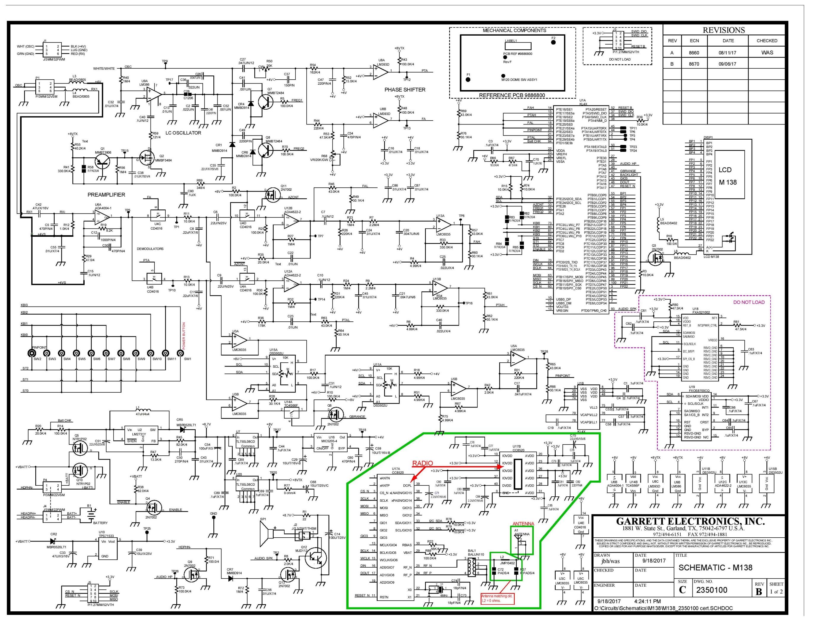

                              • #60
                                Also like to add to MXT circuit and MXT2 (makro2 circuit Technetic T2 hardware clone) for reference and compare Garrett AT Max original circuit from FCC ID: https://fccid.io/DBD the only one there who is official aviable free.
                                Click image for larger version  Name:	Garrett AT Max circuit.jpg Views:	0 Size:	791.4 KB ID:	447107
