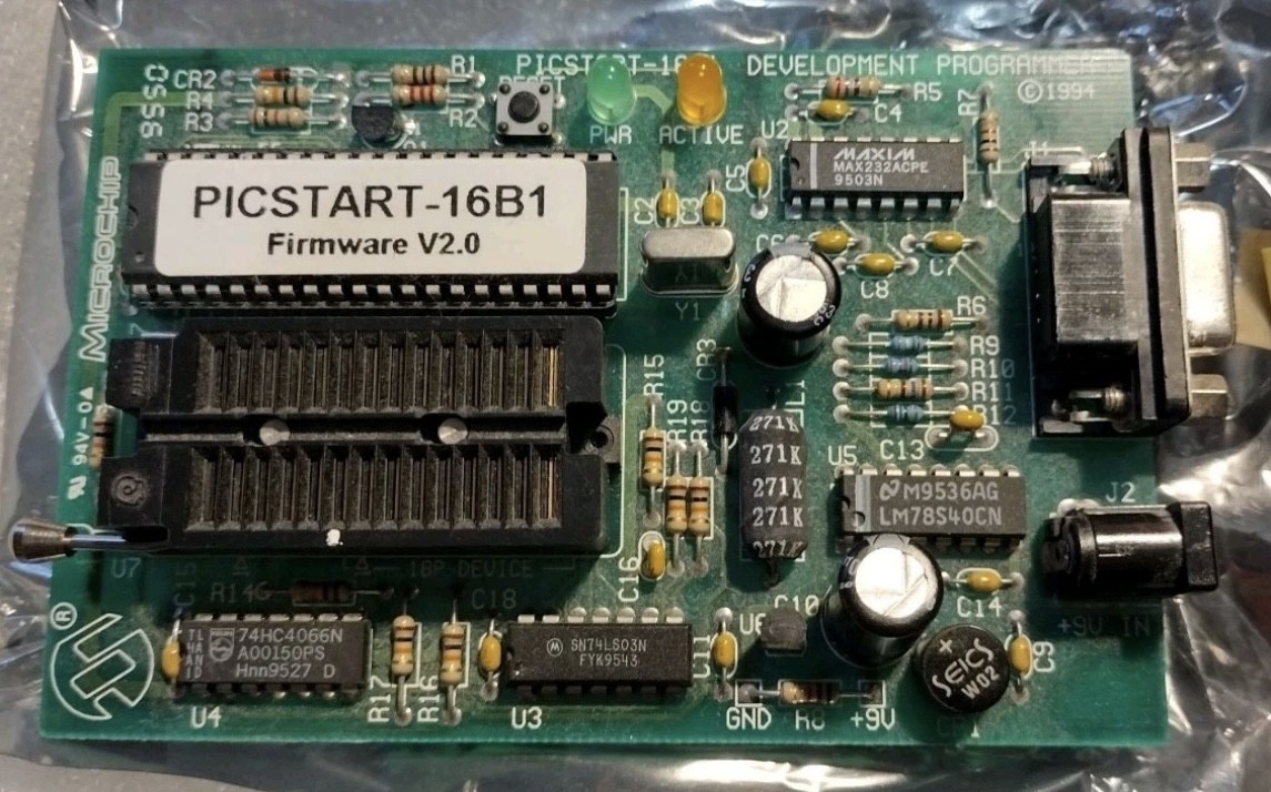

                    Hi KRinAZ, can you tell us what your "fun tools" are? I have an old cnc machine controller that uses a pic18f. The company that made the controller has been out of business for at least 15 years. I would like to build a back up controller if I can dump the hex. Thanks
                    Hey sure Altra - I can understand wanting to get a backup of that code!
                    Coming:
                    First off a Pro2X dock for one of my Dell laptops - so that I have a real 18650 based RS-232 port available.
                    Second an old PICSTART Plus PIC programmer, and an old PICSTART-16B PIC programmer - both DOS only based, both actual Microchip products, so old they aren't supported in the MPLab IDE (I'm told). I don't have the software (it's DOS software on floppy disk) and don't think I need it, but if anyone has this software I would really like a copy. I still have floppy drives to read the disks if needed. Pretty sure it (the software) won't allow pulling the code, but could be used to program PICs once the binary code is available. But I can use part of the programmers to:
                    Click image for larger version  Name:	image.jpg Views:	0 Size:	183.2 KB ID:	447170
                    Click image for larger version  Name:	image.jpg Views:	0 Size:	227.7 KB ID:	447171
                    Have:
                    Third is what's in my head - a very long time ago when I was in the US service (branch undisclosed) we used to (among other things) hack the code from certain military products from less than friendly nations (no further discussions on that will be entertained), and I intend to write some code - and to use part of the PICSTART programmers circuit, and the wonderful ZIF socket they have, to in effect get (or more properly recreate) the code from the PIC.
                    AI will not be involved here, as I will never allow AI to train on what I have in mind.
                    But assuming I'm successful I will make sure you know that yours can be backed up also.
                    EDIT - some CNC machines use controllers very similar to after market (upgrade) 3D printer controllers - as both do similar things - and there is a robust community of Open Source software (Marlin the best/most popular & robust) - where you could very well improve on what you have now - including higher quality stepper drivers, higher resolution code, etc. They usually have a STM32Fxxx or higher micro and aren't code protected - so you can update firmware at will. Watch out for boards with poor quality CN clone mosfets though, and watch out for boards with the very poor CN clone of the STM32 by GD - it would be called something like GDM32Fxxx - no good!
                    I have two 3D printers and compiled my own code for them, they've been running without a hitch for 3 years now.
                    You want TMC222x mosfet stepper drivers (the good stuff) not the HR49xx (the bad clone stuff), and the Marlin open source software source (must be configured and compiled) exceeds the capabilities of many of the 3D printer manufacturers - that's why I created my own code from the Marlin sources.​
                    CNC folks run it also...we're off topic now aren't we haha...
