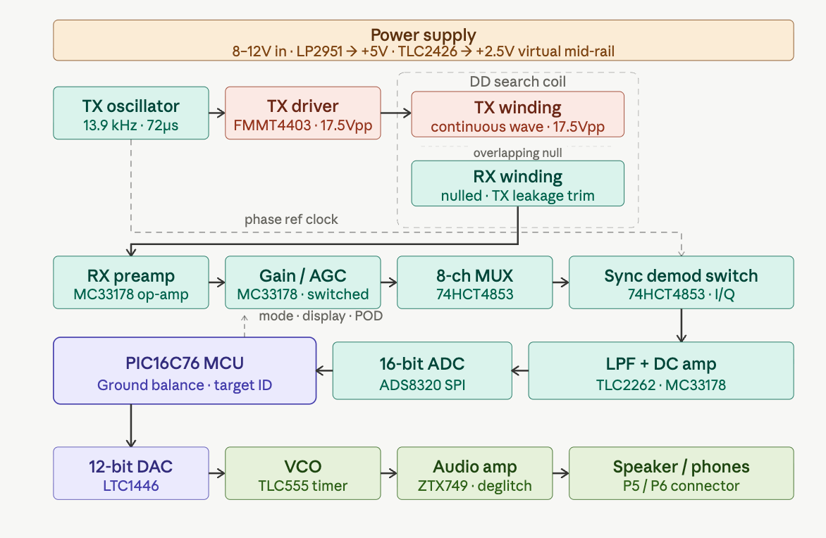

    Here is my suggestion ... I have breadboarded this schema and it works as well as any.
    The real win is to only use the simplest / minimal but best hardware that can be easily obtained and then do everything in software.
    Another thing about software is that it occupies no space and does not weigh anything.
    This is version 0.1 ... I would not build off it but should give you an idea what is possible.
    Anyway here it is ...

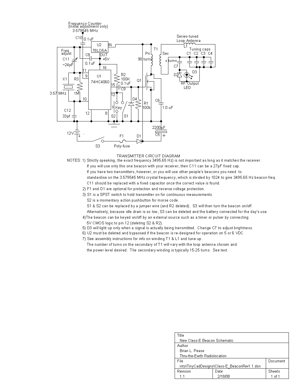

    • #62
      I like it Paul!
      Except that I don't understand the "T1"?
      • #63
        This module can implement two different operating modes:
        - pure resonant mode;
        - class "E" mode;​
        • #64
          My e class, not impress with it.
          Click image for larger version  Name:	image.png Views:	0 Size:	32.7 KB ID:	447126Click image for larger version  Name:	image.png Views:	0 Size:	20.9 KB ID:	447127Click image for larger version  Name:	image.png Views:	0 Size:	1.34 MB ID:	447128​

                • #68

                          • #73
                            this could be wrong ...
                            Another good block diagram and great starting point, couple changes to make but it's way late my time - so I'll be back.
                            I noticed the rail splitter (for the 2.5v) in the PS - U2 - should be TLE2426 instead of TLC2426, probably just a typo.
                            Curious, what software (and on what OS) you use to produce those diagrams?
                            On Friday I will produce a list of all the active components and their availability at legit sources like Mouser or DigiKey or wherever (I don't check CN sources as I make great efforts to avoid problematic clones of chips).
                            • #74

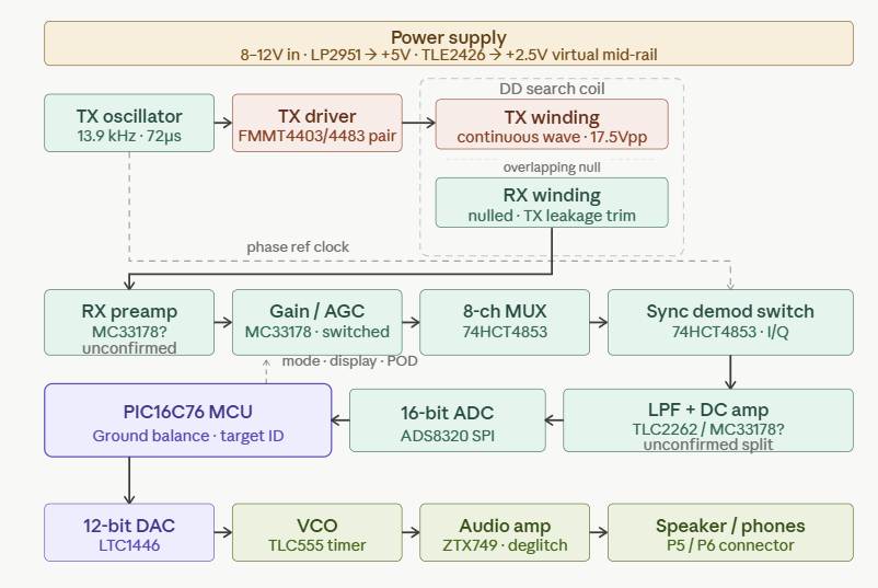

                              I have "trained" claude code as a metal detector expert engineer ... eye popping coding performance but reading schematics or making them is still a way to go. However it can produce these block diagrams in about 30 seconds .. I just tell it to go back and check the schematic again. If someone can dump the firmware from the PIC of an MXT I will show you something else it can do
                              Updated block diagram below.
                              Click image for larger version  Name:	image.png Views:	0 Size:	98.2 KB ID:	447154​

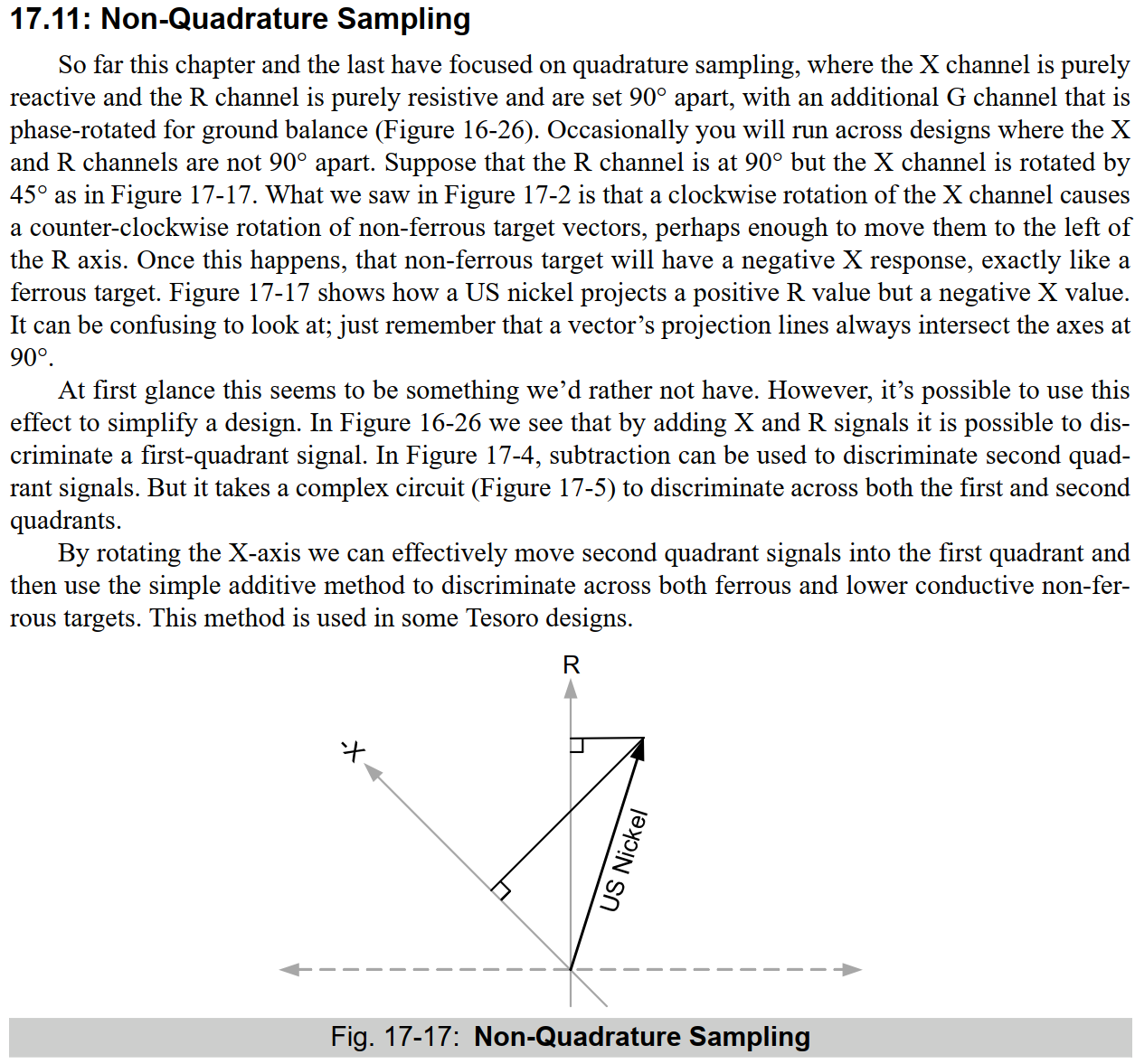

                                How critical are the "fudge factors" and the non quadrature relation of the X & R sampling ( which is usually critical to success ) ?
                                Going on memory here... as I recall it was mostly the GB code that had fudge factors, with comments like "this makes it work, not sure why." The MXT (and GMT) ground tracking was the best of its day, and is still probably one of the best out there. David told me that the Lobo ST tracking (which he designed before the MXT) was much simpler and worked almost as well, but he wrote all-new code for White's to avoid disclosure violations. Conceptually ground tracking isn't difficult but the devil is in the desire to not track out targets.
                                Here is the section in ITMD3 on non-quadrature demodulation:
                                ... and "Another example is the higher gain R channel -- since this is the ground-balanced targeting channel you can boost the gain and improve performance." that is another good one not obvious (to me anyway) in the schematic.
                                When you lower the coil to hot ground, the X channel sees a big signal but the R (or G) channel does not because they should be ground balanced. Therefore you are limited by ground as to how much gain the X channel can have, but the R channel can be boosted more. You'll see this done in designs by White's, Garrett, and Fisher, probably others. Typically the R channel has 8x the gain and then the X channel data is shifted 3 bits in code to get back to a vector circle. Or, leave the gains alone and do the phase math on a vector ellipse (harder).
