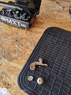

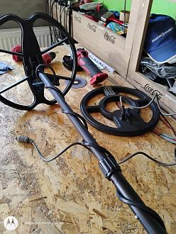

                        • Originally posted by KRinAZ View Post
                          Hello all, I've been away for a while, getting back to detecting as I have found a few remote old gold mines here in AZ with apparently untouched mine dumps :^>
                          So, since White's is sadly no more and the MXT no longer made, I propose a project to make a detector as close as possible to the original White's MXT - with the following few changes:
                          Essential
                          1) Highly water (rain) resistant if not waterproof
                          2) More ergonomic - the MXT's wide control box frequently hits my hip while in motion
                          3) Powered by Li Ion or Li Po batteries
                          4) Circuit to charge the batts
                          5) Bluetooth to output audio to Bluetooth earbuds​
                          Would be nice
                          2) Maybe a strange option, but option to switch between, or even blend, PI and VLF, both modes with ground balance
                          The VLF's I have experience with are the Tesoro Lobo SuperTraq (great detector), White's GMT (fantastic but fragile from my experience), White's IDX (good detector), Garrett AT Gold (OK but didn't compare to the MXT or GMT detection), Gold Bug (also great detector). Of all these if I had to pick only one (as I actually did) - the MXT wins.
                          Why this project?
                          I'm currently using my old White's MXT to detect the dumps - IMO the MXT the best detector for this and actually IMO the most versatile VLF detector that I have used.
                          But, I am terrified it will die as it's predecessor - a White's GMT did after getting - not rained on, but just sprinkled on, and White's could not repair it. If my MXT were to die I would try to repair it, but without schematics, firmware, and such...
                          Hoping there are other MXT fans that would also like to see this project happen, thoughts?
                          These changes would not infringe the patent rights of the manufacturer.

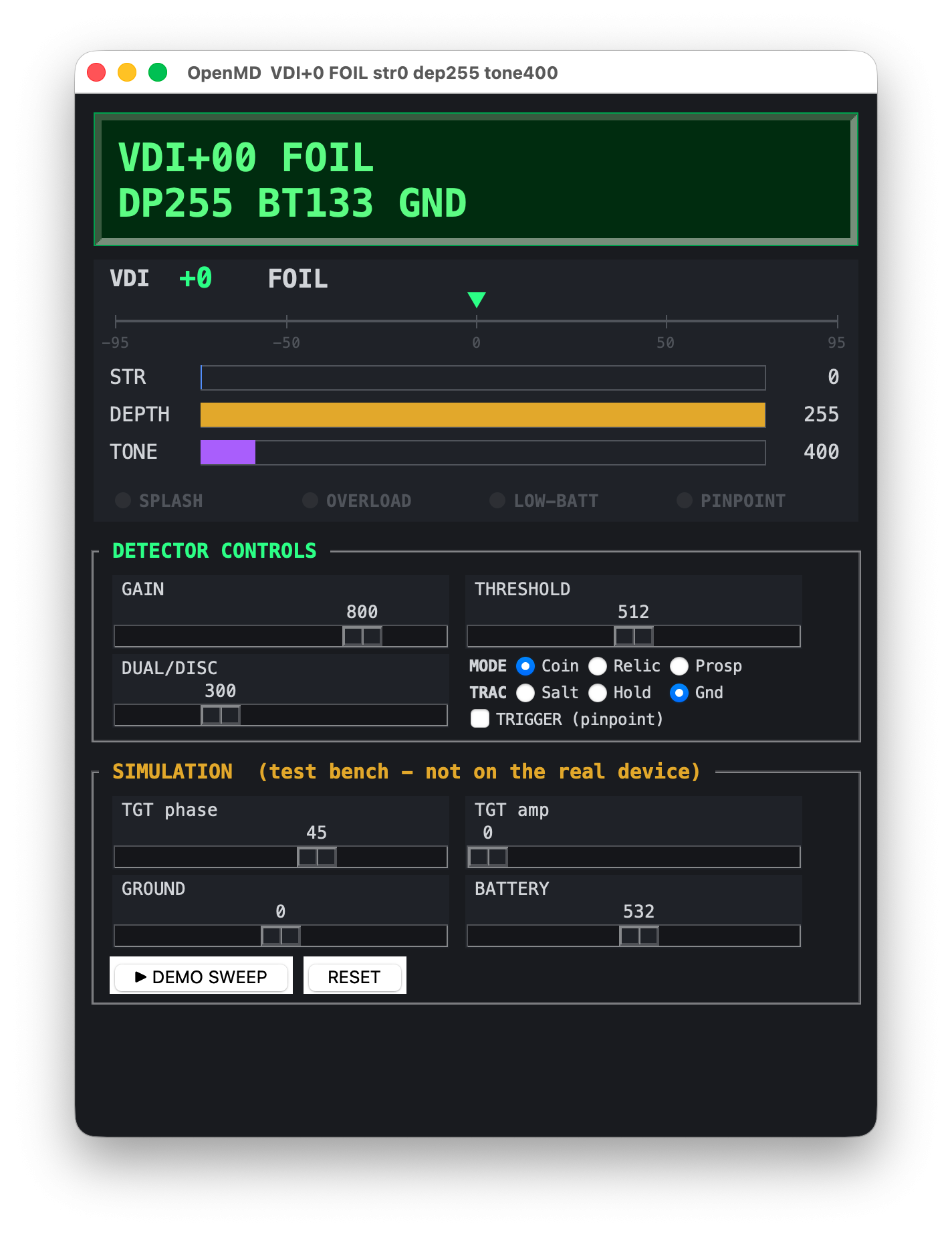

                            • Now here is a python harness that exercises the firmware and you can see if its working or not.
                              But its real power is that the AI can "see" this interface and debug the software in a loop without me having to flash and check it manually.
                              Files attached below openmd cref with python harness gui ... see the readme .... Its all clean room code.
