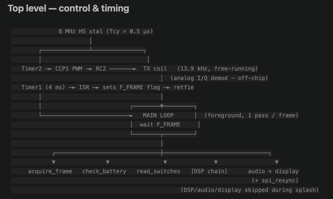

Let's make a closely MXT like detector!
  • This AI is a sly one.

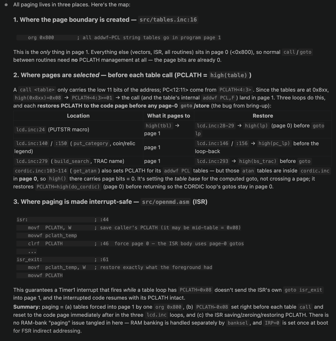

    Interestingly, there were no compilation inconsistencies due to the unspecified "paging" for the programs in the second page, called by the main program -
    call dsp_filter
    call dsp_ground
    call dsp_metrics ...
    But since everything works, there is obviously no problem.​
      The AI did all this whilst I was gardening ... its prepping the docs now.
      The gardener is always the murderer. In this case to the secrets of the source/binary code.

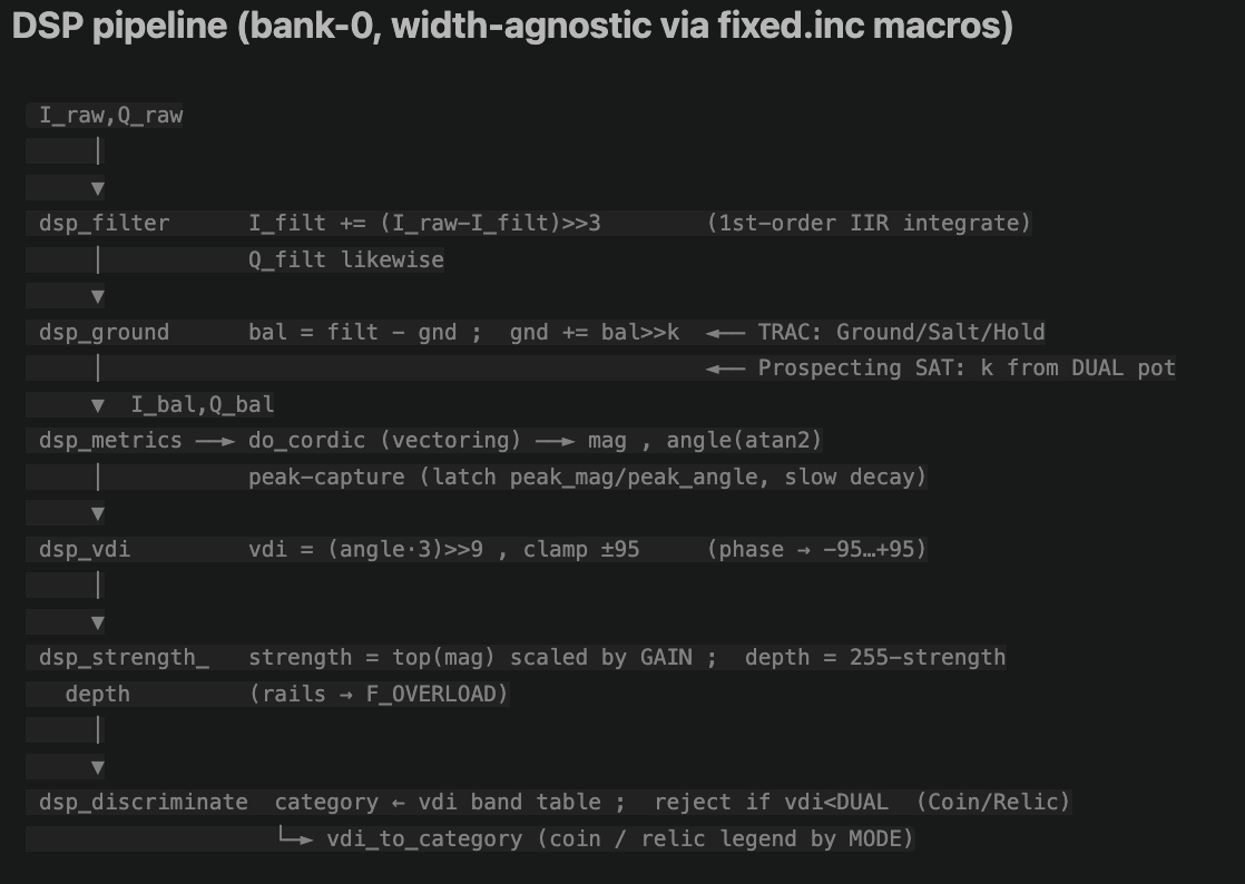

      BTW, regarding the averaging of the phases in the code.
      Never average the phase angles. Do it in the I/Q part and average the I and Q parts. Than calculate the phase, when it is required.

        this is what the AI said ...

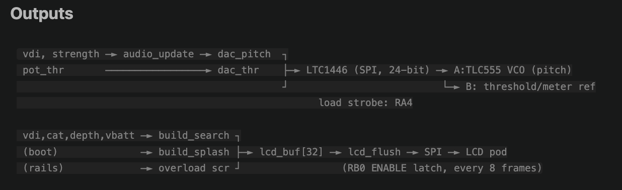

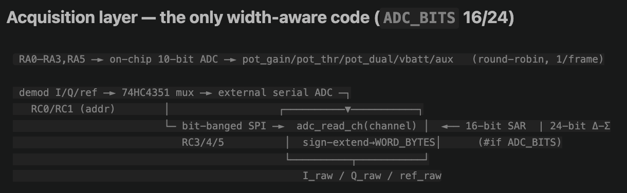

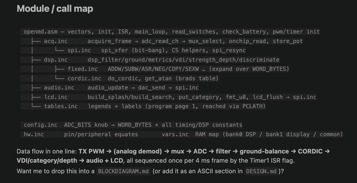

              The AI took maybe an hour to do this... I estimate a couple of months for an experienced engineer ( from scratch + debugging ).
              The chip utilisation shows one super power of assembly code ...
              The real question is: what exactly did the AI accomplish here? xDD

                Actually when I used to work ( LOL ) .... one of my engineering tasks was protecting intellectual property. If Garrett do own the whites IP rights then blatently putting up copies / reverse engineering the firmware is a violation of copyright and could result in a takedown notice to this forum at a minimum and something more threatening at worst. ( depending on jurisdiction firmware copyright can be 70 years + ).
                I saw that you and others were doing ( presumably good work ) but you are still creating a derivative work ( by reverse engineering ) so you are back at my first statement above.
                The AI claimed to have fully decoded and extracted everything the orignal code does .. this was trivial for the AI BUT again refer to my first statement. ( so I wont be publishing it here unless someone else cares to do it).
                It did this by compiling the assembly code, running it in a simulator with code stubs that simulated all the inputs / ouputs ( like the adc, the pots, the swiches, the audio ) etc and seeing if it matched the behaviour from the schematic and the user manual. The AI looked into registers and memory in the simulator to figure out what was changing what ... this is an old hardware hacker method.
                Unlike your commendable efforts I have only shown that there is an alternate path to achieve an outcome that does not involve reverse engineering the code but infers the required internal code from looking at the behaviour of the circuit, the signals at each pin and lastly reading the fine manual ( aka RTFM ) .. .that is the AI reading the manual ... not me.
                You mention your analysis where claude etc spent hours determing the inner workings etc ... this is where context engineering comes into play.
                My approach is to look at the schematic ... what is the circuit doing at each pin. What is the signal behvaviour at each pin. What is the code that could produce that behaviour or process that signal. Then read the user manual, what are the controls, the LCD display, the boot behaviour, the switch functions ( description of each ). What is the timing of all these signals. This is the context.
                The most important part is to start generating code then run it through a compiler then a chip emulation ( cycle accurate ). Its not like there were no bugs ... there were quite a few ..particularly around interrupts. Then the AI changes the code ... runs the sim again etc. until the code runs in the sim with no errors and the timings / behaviours are all consistent.
                There is no hype here .. the interface to any LLM seems to be "hypy" in nature. I am just reporting what it was reporting to me.
                By doing a clean room build "the uncertainty" you mention is removed. Yes in the original firmware there are variables that are "uncertain what this does / is for". In hindsight there are no "magic" algorithms in the original code in fact there are quite a few shortcuts and space saving assembly kludges that were not needed since the code fits easily into the chip.
                Could there still be bugs ... absolutely ! ... but I ( err the AI ) has only spent a couple of hours on it.
                So to answer your question .. .what did the AI achieve here ? ... plenty !
                See the full assembly source attached ...
