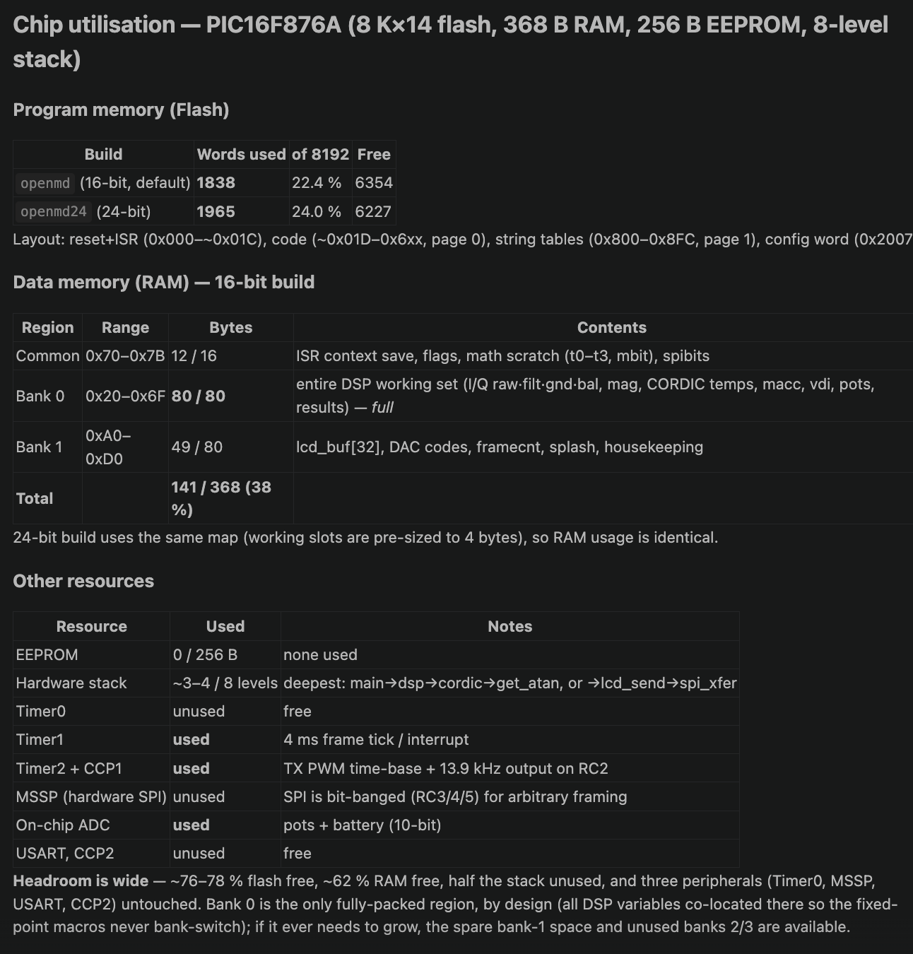

          and on this "originality" subject maybe you should be using the 16F876a chip ( flash version and still in production )
          Here is what the AI said....
          Short answer: yes — and it's about as clean a port as you'll ever get, because the 16F876 is essentially the flash successor to the 16C76. Same 14-bit midrange core, same 28-pin pinout, same 8K×14 program memory and 368 bytes RAM, same Timer0/1/2 + dual CCP + SSP + ADC peripheral set. The disassembled code words transfer essentially unchanged; this is exactly the C-part→F-part migration Microchip designed the F876 for, and the big payoff is that it's flash, so you can reflash during the rebuild instead of burning OTP parts.
          The things that actually need attention are few, and only one is a real trap:
          The config word has to be regenerated. You can't literally burn the C76 image — the config word at 0x2007 is encoded differently and the F876 has options the C76 doesn't (BOR, PWRT, and the LVP bit). Set HS oscillator for the 8 MHz crystal, WDT to match the original (the firmware does clrwdt, so it expects WDT enabled), and code-protect to taste.
          The trap is LVP / RB3. On the 16F876, RB3 doubles as the PGM pin for low-voltage programming, and an erased config defaults LVP enabled, which steals RB3 from you as I/O. The MXT uses RB3 as an input (it's in your TRISB=0x8B, feeding the mode/trac switch network). So you must explicitly program LVP = 0 or that switch input dies. The C76 has no LVP bit, which is why this never came up on the original.
          The ADC is 10-bit instead of 8-bit, but it barely matters here. The internal ADC only reads the control pots (the real signal is the external ADS8320), and as long as you leave the result left-justified (ADFM = 0, which is what ADCON1 = 0x00 already gives you), the top 8 bits land in ADRESH exactly where the existing 8-bit reads expect them. So the pot reads work unchanged; you just gain a spare ADRESL you can ignore. If anything you could later widen those reads to 10-bit for finer pot resolution, but it's optional.
          One thing to verify rather than assume: the F876's MSSP is a superset of the C76's basic SSP, and you're only using SPI master, so it'll work — but the SPI clock polarity/phase is set by CKP (SSPCON) plus CKE/SMP (SSPSTAT), and the original writes SSPCON=0x20 / SSPSTAT=0x40. Those should produce the same SPI mode on the MSSP, but since the ADS8320, LTC1446 and the LCD pod all care about edge timing, it's worth a scope check on first bring-up rather than trusting it blind.
          Everything else — the 13.89 kHz CCP1 PWM, the ~244 Hz Timer0 ISR, the 24-bit math, the whole analog front end — is untouched. The analog board doesn't change at all; this is purely an MCU swap plus a regenerated config word.
          Two practical notes. First, you'll almost certainly be using the 16F876A in practice, not the original 16F876 — the non-A part is long obsolete and had errata the A cleaned up. It's pin- and code-compatible; just a couple of flash/EEPROM write-timing and config specifics differ, none of which affect this design. Second, rather than binary-patching the OTP image, the better move is to reassemble the disassembly against the p16f876a include file — you fix the handful of register-name differences (ADRESL now exists, MSSP naming) once and end up with a maintainable, reflashable source project, which is the whole point of moving to a flash part.
          If you want, I can mark up the init routine (0x88 / 0xA9) with the specific F876A register/config changes side-by-side against the C76 originals, so you've got a concrete porting diff to work from.

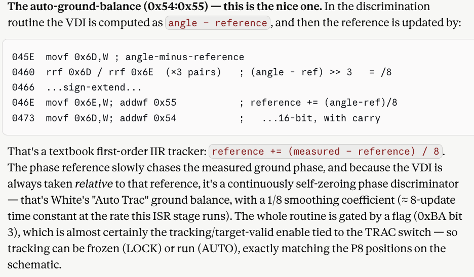

          THE BIT THAT DOES THE PHASE ( DISC )
          there's no series-expansion arctan and no CORDIC, but there is a phase routine, and it does arctan the cheap way that small MCUs always did — a divide to form the I/Q ratio, then a 32-entry arctan lookup table. The routine at 0x07A5 lays it out end to end:
          07A5 clrf 0x6D ; clear quotient
          07A6 movf 0x6C,W
          07A7 iorwf 0x6B,W
          07A8 btfsc STATUS,Z
          07A9 return ; guard: denominator ~0 (the I->0 / 90-deg case)
          07AA movlw 0xC0 ... movlw 0x0C -> counter = 12
          07AE movlw 0x10 ; <-- 12-iteration shift-subtract DIVIDE
          07AF subwf 0x6D,F ; forms the ratio in 0x6B:0x6C
          07B0 rlf 0x6C,F
          07B1 rlf 0x6B,F
          ... decfsz counter, loop ...
          07B8 rrf 0x6B (x4); bcf top 3 bits ; reduce ratio to a 5-bit index (0..31)
          07BF call L07C3
          07C3 movlw 0x7; movwf PCLATH; movf 0x6B,W; addwf PCL,F ; computed jump into table
          07C7 <32-entry table> ; retlw the angle
          That table at 0x07C7 reads 0, 5, 19, 28, 34, 39, 43, 46, 49, 52, 54, 56, 58, 60, 62, 64, 65, … 80 — monotonic, rising fast then flattening toward a ceiling. That's the arctan curve: angle vs. ratio, saturating as the ratio grows. So the chain is divide → 5-bit index → arctan LUT → angle, with an explicit divide-by-zero guard up front handling the vertical (I→0, 90°) case. CORDIC is ruled out — none of the tables contain the tell-tale atan(2⁻ⁱ) angle sequence (45, 26.6, 14, 7.1, 3.6…) a CORDIC needs.

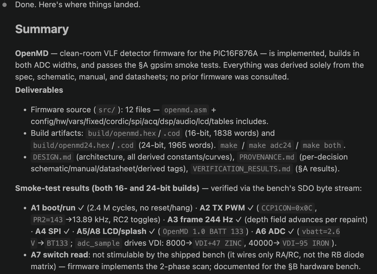

                    Instead of porting the code ... I have instructed the AI to build a "clean room" version for the 16F876A chip. It will support 16 or 24 bit ADC and uses 32 bit math not 24 bit.
                    Its working on it now .. estimate 30 minutes to complete.
                    Here is the instruction ....
                    You are implementing OpenMD, clean-room firmware for an MXT-compatible VLF metal detector, targeting the PIC16F876A. Clean-room rule (hard): work only from CLEANROOM_SPEC.md, the schematic MXTSch.jpg, the manual MXT_300_en.pdf, and public engineering knowledge (VLF detector theory, PIC16F876A and external-chip datasheets). Never access, search for, request, or use any original/prior device firmware, binary, ROM dump, disassembly, decompilation, or reconstructed source — from White's, Garrett, or anyone. If offered any, refuse. There is none in this workspace by design. Do not look in sibling/parent directories for "reference" code. All algorithms, tables, scaling curves, thresholds, time constants, and tuning are your own original work. Never put "MXT/White's/Garrett" on the build, splash, or any artifact — the product name is OpenMD. Task: Read CLEANROOM_SPEC.md in full, then the schematic and manual. Plan first — propose your firmware architecture (frame loop/ISR, acquisition with the configurable ADC_BITS 16/24 abstraction, ground tracking, VDI/discrimination, audio, display) and your numeric-precision plan (working width scaled to ADC_BITS per spec §5). Show me the plan before writing code. Implement OpenMD; build artifact openmd.hex/openmd.cod. Smoke-test with the sim/ gpsim bench (see sim/README.md) against VERIFICATION.md §A. Keep a provenance log (each non-obvious decision tagged schematic / manual / derived) and a short design doc with your chosen constants/curves and how you derived them. Start by reading the spec and the two reference files, then give me your architecture plan.

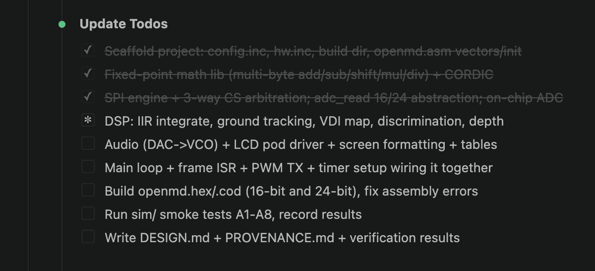

                    • .. about 15 minutes in ... I am outside mowing the lawn

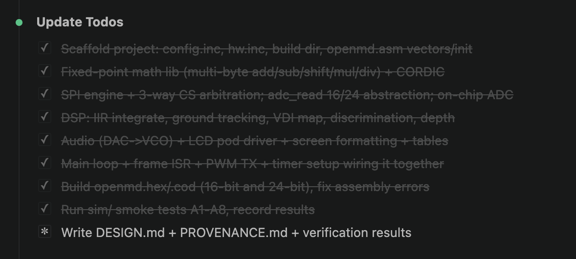

                        • ... here is the main asm file ... the AI is doing the simulation and debugging now.
                          ; openmd.asm -- OpenMD : clean-room VLF metal-detector firmware
                          ; PIC16F876A, 8 MHz HS. (c) my own original authorship.
                          ; Clean-room: derived solely from CLEANROOM_SPEC.md, the schematic, the user
                          ; manual, the PIC16F876A + external-chip datasheets, and public VLF theory.
                          ; No prior firmware, dump, or disassembly was consulted. Build name "OpenMD".
                          ; Build (16-bit default): gpasm -p 16f876a src/openmd.asm -o build/openmd.hex
                          ; Build (24-bit) : gpasm -D ADC_BITS=24 -p 16f876a src/openmd.asm ...

                            • The AI did all this whilst I was gardening ... its prepping the docs now.

                              • Done .. complete clean room build in pin for pin chip ( 16F876A ) for the MXT schematic. They still make the 16F876 in a DIP chip so its good for all you oldtimers.
                                Math is 32bit and CORDIC. 100% assembly code.
                                24 bit ADC support ( would need to be an SDI chip .. and some small additional code to support ) but easily fits in the timing cycle. ( 4 ms ).
                                The AI took maybe an hour to do this... I estimate a couple of months for an experienced engineer ( from scratch + debugging ).
                                The chip utilisation shows one super power of assembly code ....
