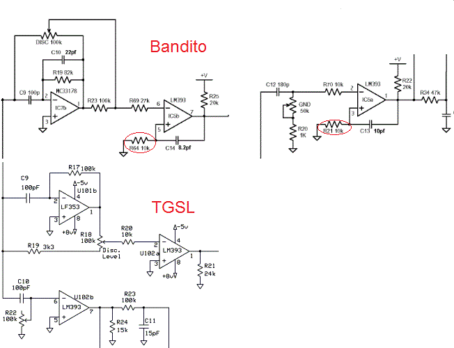

    • Doing some testing with the TGSL today. It was fairly quiet with occasional peeps.
      It only got the big silver to 10" so I decided to up the gain of the first filter stage.
      This will also tell me where the beeps are coming from.
      Well I changed the resistor to 1 Meg and cap to 100n and got my 12" in the air!
      But there are now a lot more beeps and chatter. It is still much different from the
      original Bandito and I'm not sure why?
      The input opamp seems quiet but the LM393 output seems to jump when a beep
      occurs so maybe it needs some noise suppression? It could also be coming back
      through the power supply...
      If you notice the Bandito uses resistors to ground on the 393, maybe I'll try that and
      see what happens;

      • Well adding the 10k's to the 393 seems to have helped. The audio is strong now and I heard
        a good beep to almost 15"! But it started chattering again so not sure if it's usable. I added
        the caps but it didn't seem to make much difference. I surmise they put the threshold for the
        comparator above the noise so avoid "phase jitter", not sure but they seem to make my board
        work better so they stay!

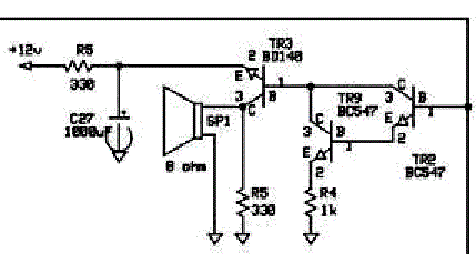

        Note: I also upped the audio cap to 1000uf from 220uf as shown in Ivonics loud audio mod
        (I thought the speaker might be causing the supply to glitch);
