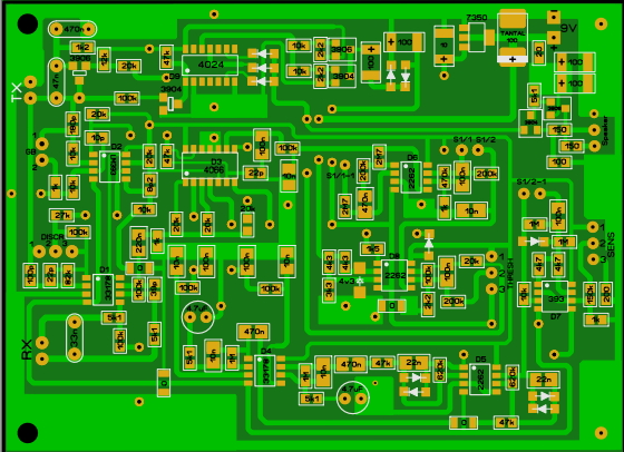

ok... understood... you may find ceramics at digital modern but trash boards, but their voltage is unknown. on Tesoro boards made on SMD
they used non-polar electrolytics. btw your layout has big spaces... meaning in size? you sure can put electrolitics there.
Yes, of course... This is the board from the first page, only slightly changed. I used the 7660 microcircuit in the negative voltage source and changed some ratings in the filters. I compared the board with the scheme, but have not collected it yet. Designed for self-manufacturing, not factory.Originally posted by MartyJ1963 View Postdo you have the layout of the SMD pcb that you posted?Attached Files
