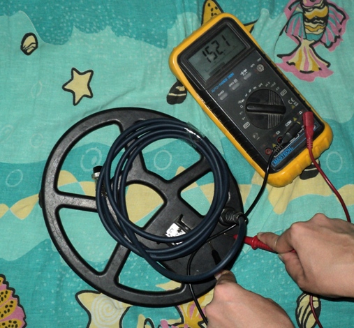

I put the original TX on the TGSL today. The TX is 17V tall at 15khz. For the negative supply I got -7.6V!
I see a lot of noise on the sine wave though. I think my scope is getting funky on me. Both channels look
noisy even with no signal going in. I may bring it to work and check it on the scope there...

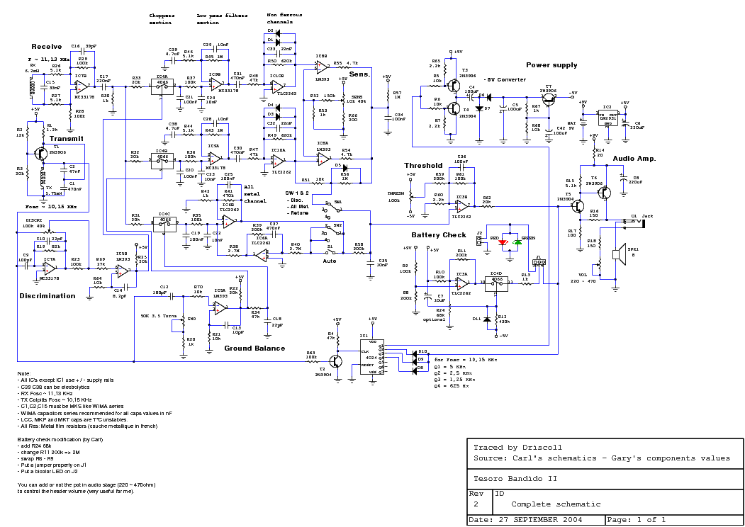

Here are some schematic´s. Don´t know if they are older.

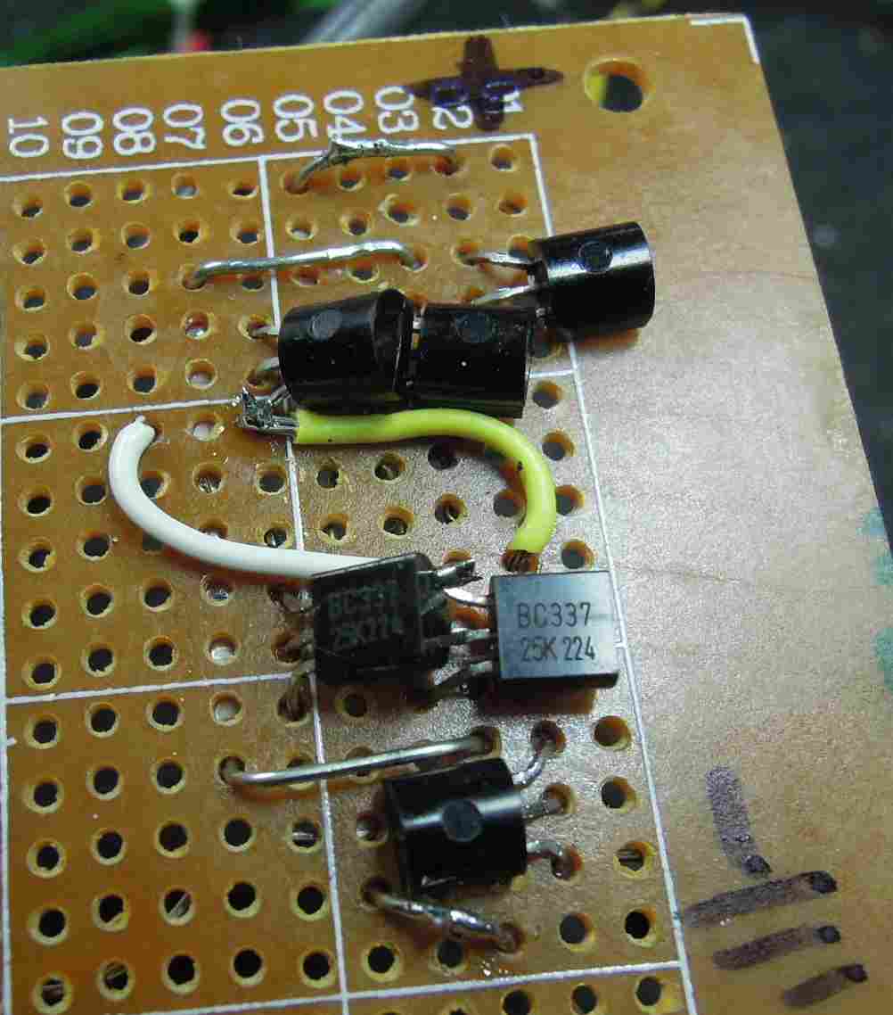

Well the mini H Bridge isn't working. I found a mixed transistor and fix that but still no joy!
Maybe the 3904's and 3906's Need a different resistance value?

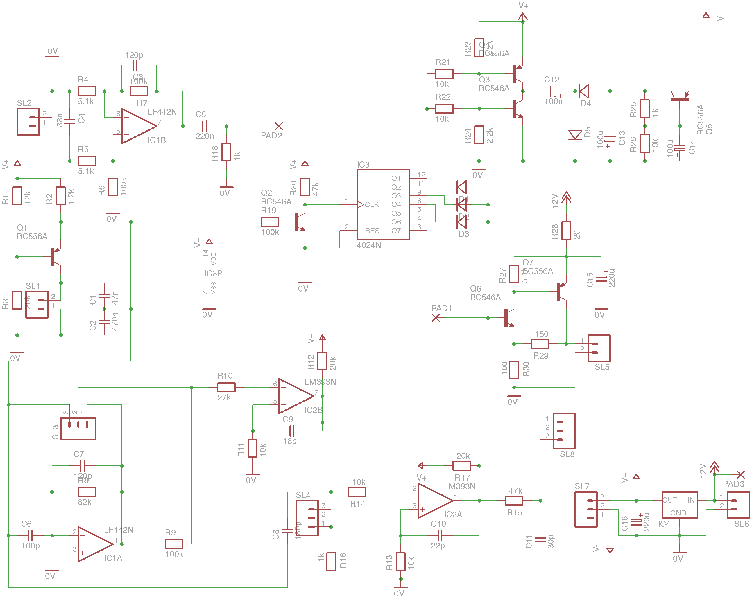

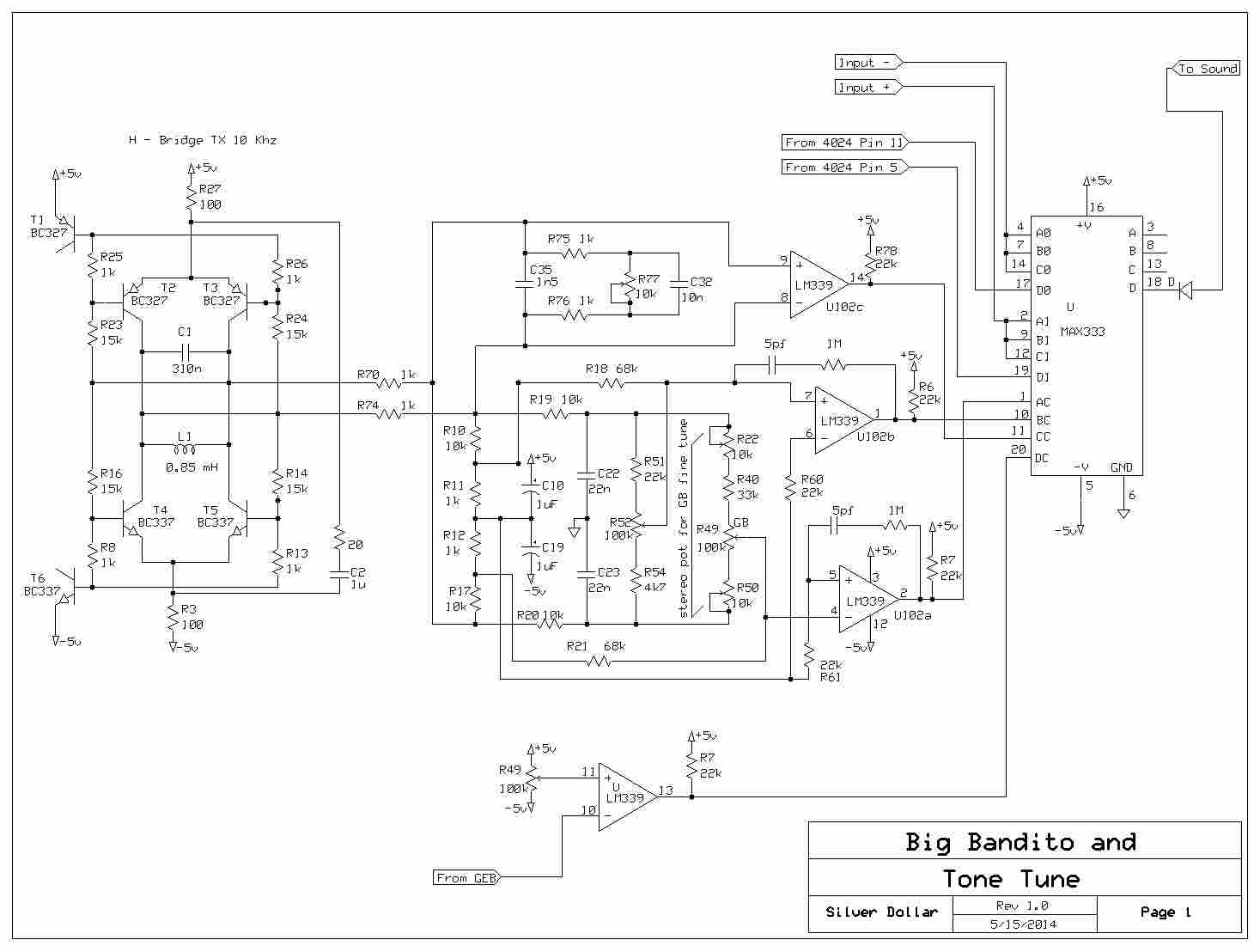

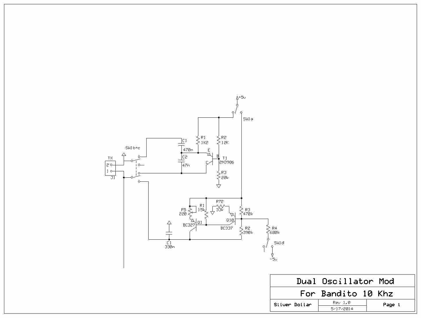

So I've been working on a big mod. I call it the Big Bandito and Tone Tune.
Here's the schematic;
It does a balanced TX and RX and has tunable dual tones via a level select able 4024 output.

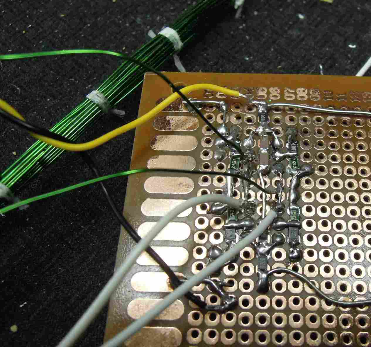

Here's the first part I call it the sleeping H bridge as the transistors are laying down;
Here's the bottom. I'm using a special technique where some parts are through hole
(transistors) and some are SMT so as to make a tiny pcb.

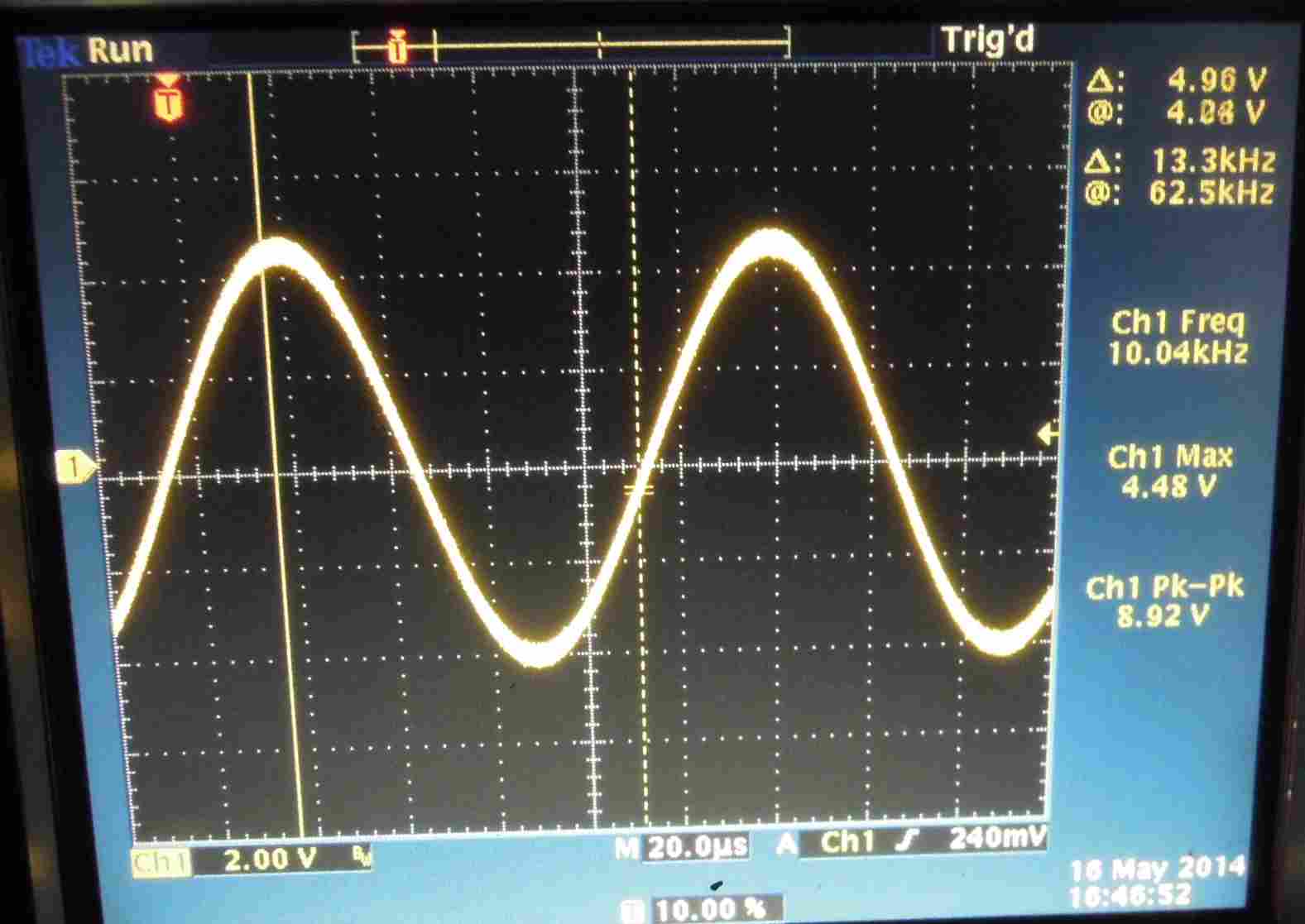

It oscillates at 10 khz and has about 9V amplitude but that is hiding the fact that
there is around 150 ma in the coil! It only draws around 4 ma too!
The dual tone mod allows for all high tones, all low tones or switch from low to high at some amplitude...

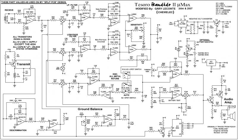

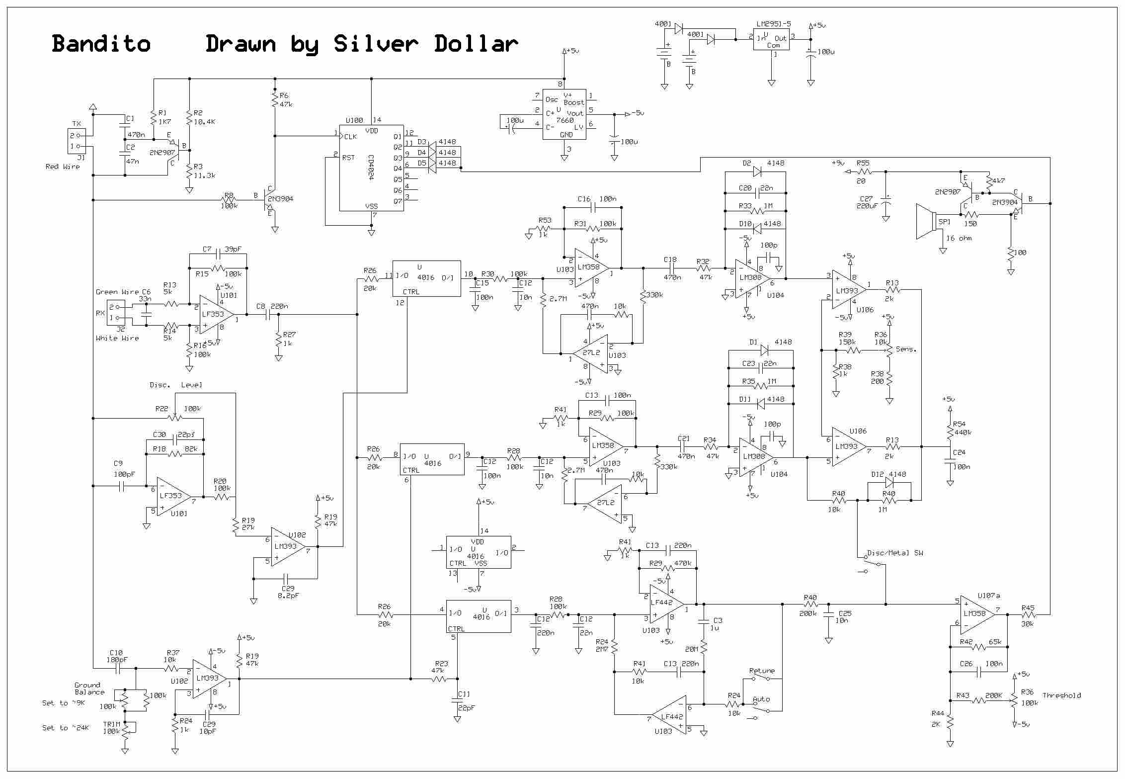

I probed around a bit on the original Bandito too. I found the resistors on the outputs of the
comparators that compare metal and disc are 2k. It also uses back to back diodes on the final
stage. Here's a corrected schematic;
It seems the instability is related to grounding the RX. I had similar trouble with my
TGSL and could not run it as a balanced input but had to ground one side of the RX.
I'm using the Tesoro coil now and the original Bandito works and is wired the same way
so I don't understand why the problem on the new board?

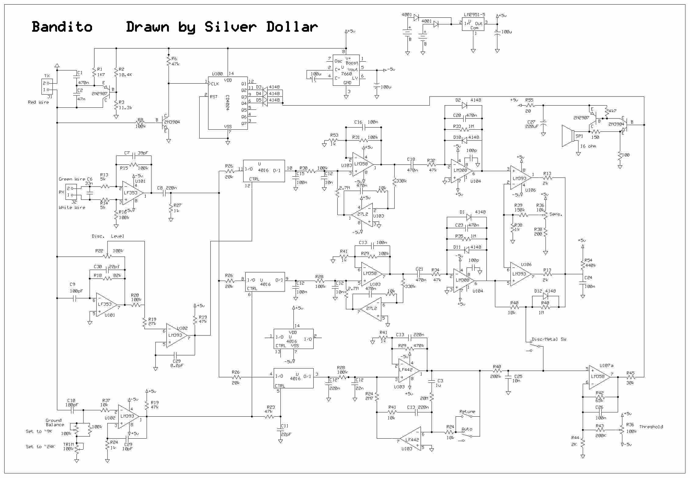

I just figured out the caps in the second filter were wrong on the original Bandito.

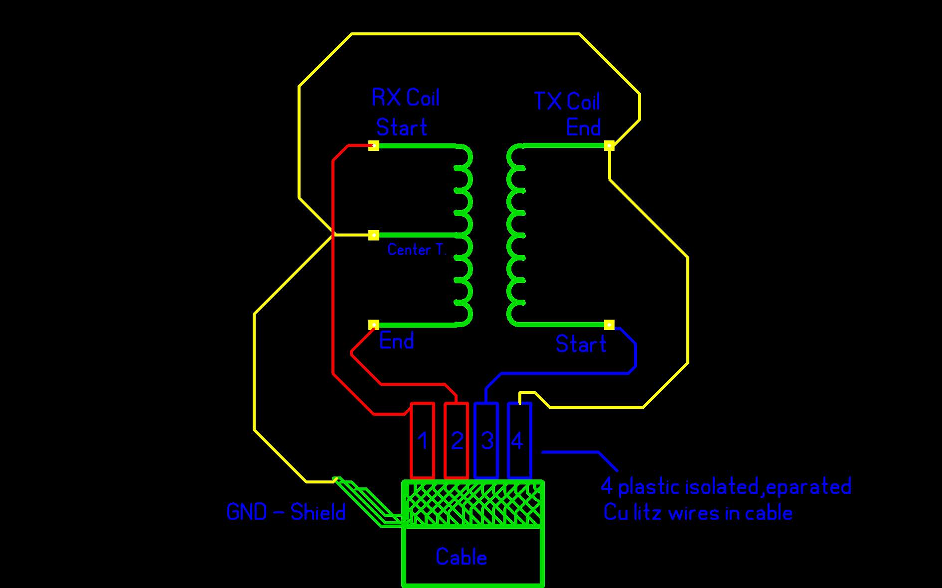

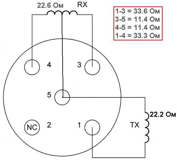

I am confused with the center tap wiring
Found two diagrams but they are not the same
Very subtle difference one shows the center tap connected to both the TX ground and the cable shield.
This does not seem right to me as would cause a loop
Also both are missing the coil shield Tesoro use a conductive plastic would this not be connected to the cable shield then back to the board
