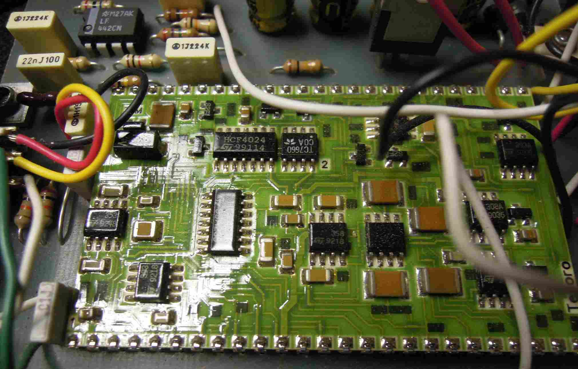

    The bandito I have is interesting. It's a rev B board and has these components on a substrate;
    LM308
    LF353
    LM358
    LM393
    27L2
    7660
    4024
    4016
    OFF the substrate is a LM2930-5 and a circuit with a LF442 in a dip package.
    The GEB has a 100k trimmer to ground then a 100k 10 turn with a fixed 100k across it.
    The sens and Disc pots are 100k.
    Maybe something like this? I'm not sure where the 442 is though;
Name:	Original Bandito.jpg
    The negative voltage on this board is -4.4V. The batteries are paralleled with reverse diodes on the plus side.
    Here's a picture

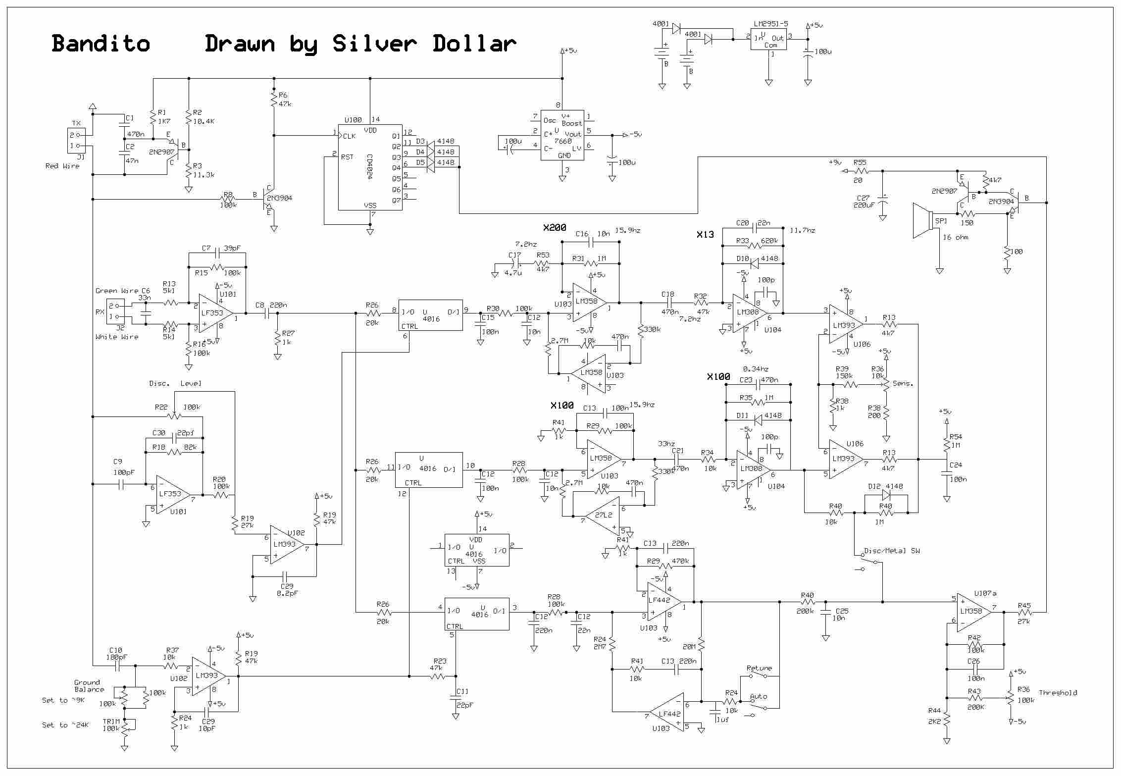

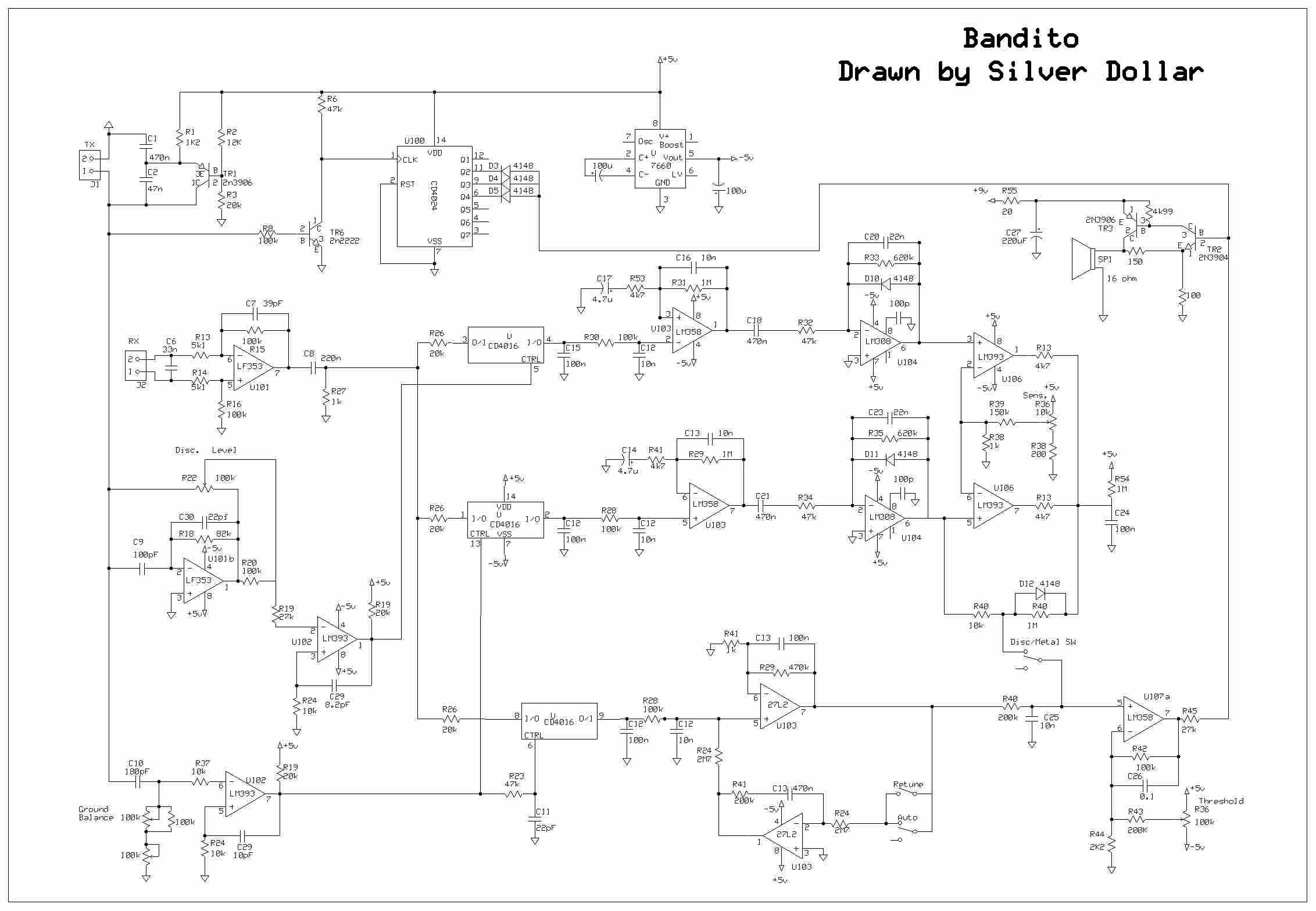

        Here's a better schematic for the original Bandito. I fixed the pin numbers and changed to the 7660
        for the negative voltage.
        • #94
          Noticed TR6 is a 2n2222 instead of 2n3904 used elsewhere
          2n3904 is a higher speed and lower noise device is there any reason that the 2n2222 was used other than availability ?

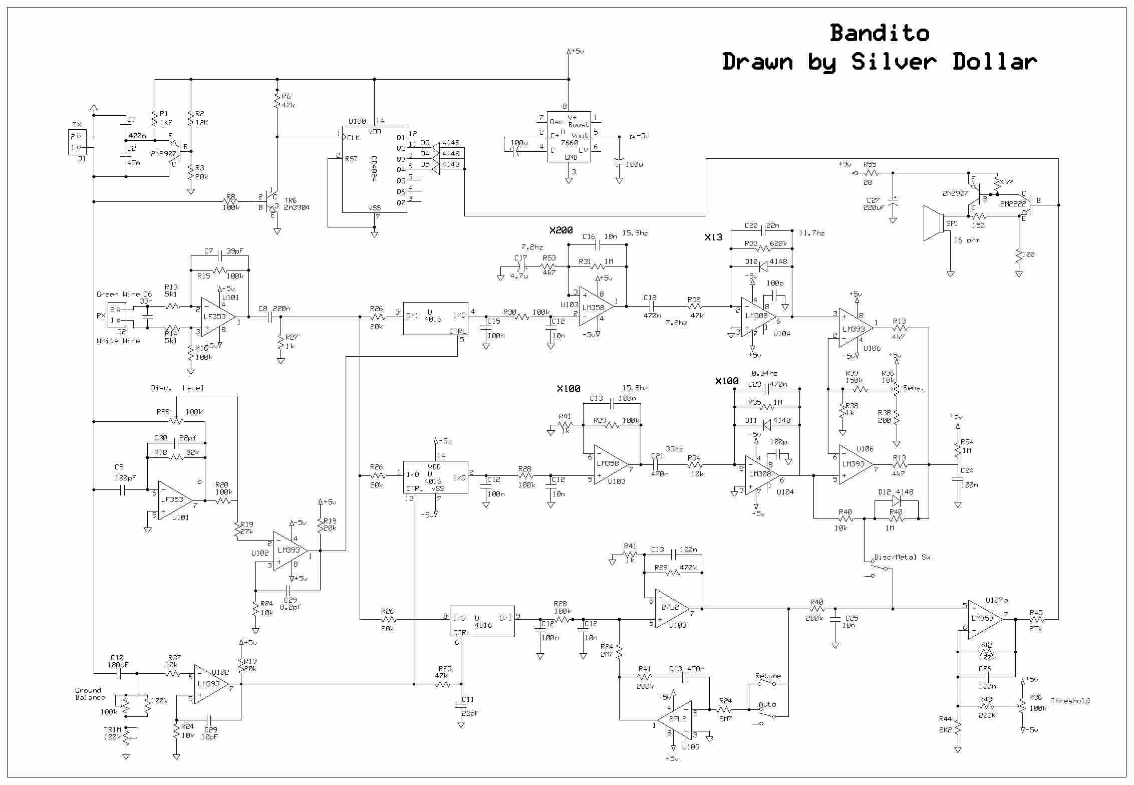

          • #95
            Oops the transistors have not been verified yet. I need a scope to see the
            markings as they coated the board with clear spray and it's hard to read.
            The TX is 2907 and one other is too.
            I'm finding some funny readings too. There are no 4.7uf caps and the 358 resistors
            seem to be 100k and 1k. The caps are 100n and 10n?
            The resistors on the 308's appear to be 840k (1meg?) and 10K (instead of 47K) but the
            caps are definitely 470n but 10K and 470n isn't right....
            The lower string is the values I found in circuit.

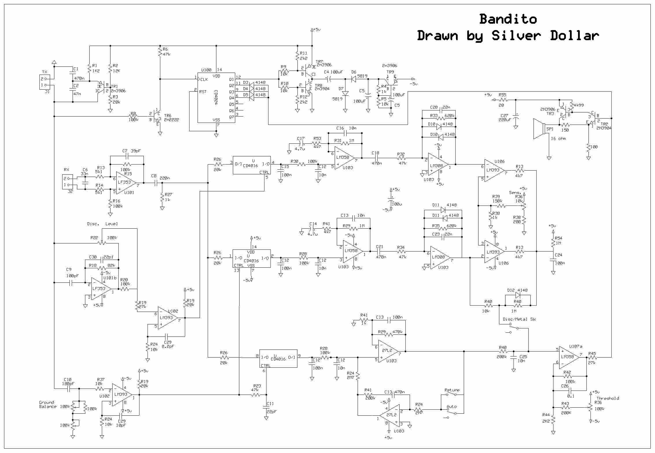

            • #96
              Well I've found the 442 is used for the pinpoint function (and it has a 20 meg like a mod I showed) so what is the 27l2 for?
              I assumed the 27L2 was CMOS so would hold the ground longer before bleeding off....

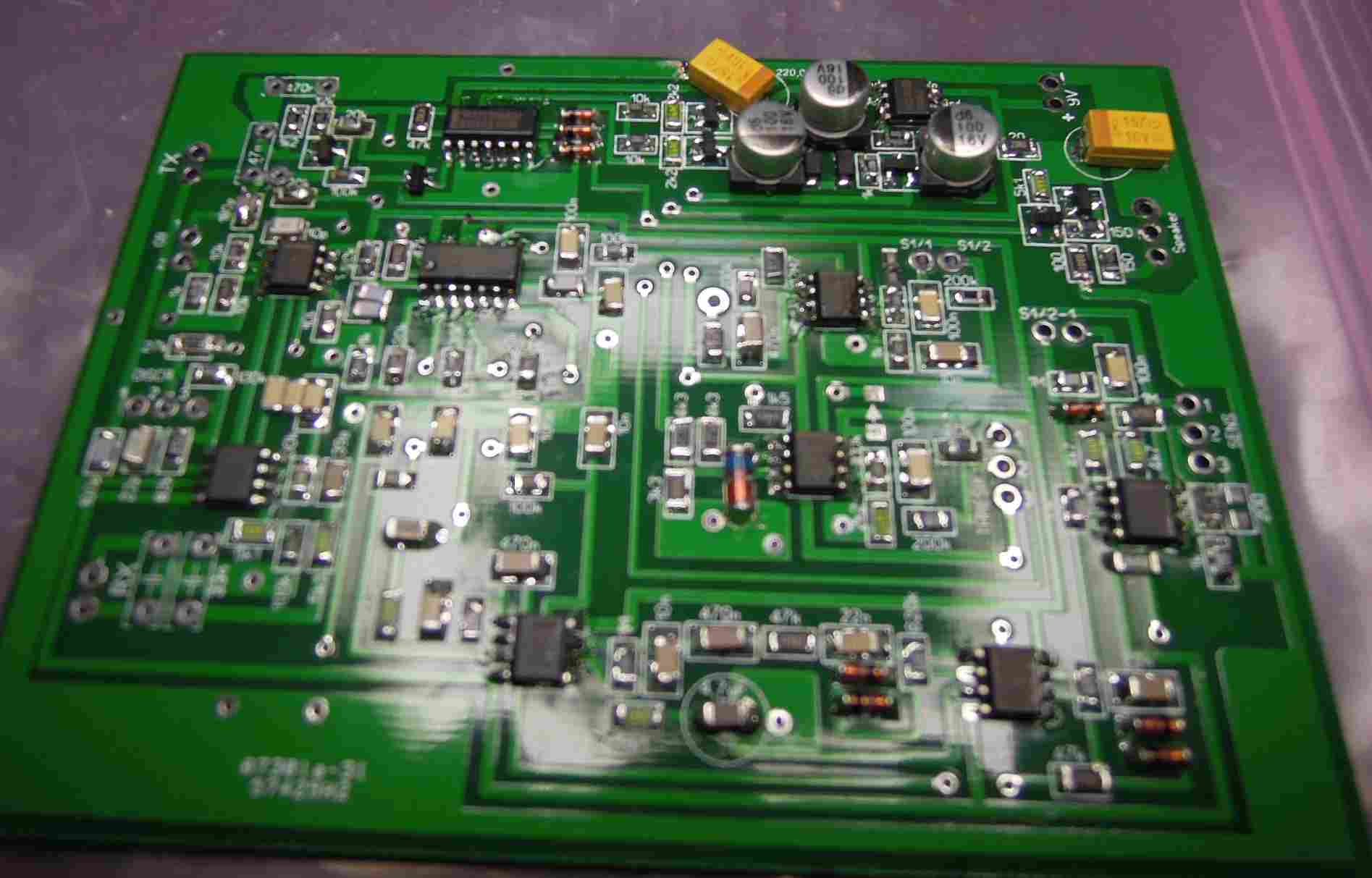

                Well I fired up my Bandito II SMT today. The first problem was a tiny TX (600mv) I had installed a 12K instead of 1.2K
                (their wrong in my bag). I got that solved but now I do not have any negative voltage. It reads 0.5V positive. Hmm
                I'll have to do some troubleshooting... I wonder if I loaded a 3906 in that Spot that was mislabeled?
                I saw some distortion on the TX sine wave so kept increasing the value till it went away. I ended up with 2.49K and the
                wave is bigger than the old Bandito.
                • #98
                  Well the negative voltage problem turned out to be the 100uf electrolytics that I
                  scavenged from some old equipment. It turns out sometimes the marked end is
                  positive! After getting that straightened out I had 2.9V for the negative supply.
                  I also was getting around 9" in air for a gold ring. I took the capacitive multiplier
                  out and now have 4.0V! The air test is now 10" but there is some instability. I
                  jumped the sensitivity to the negative supply so maybe I'll put it back to ground
                  and see what happens...

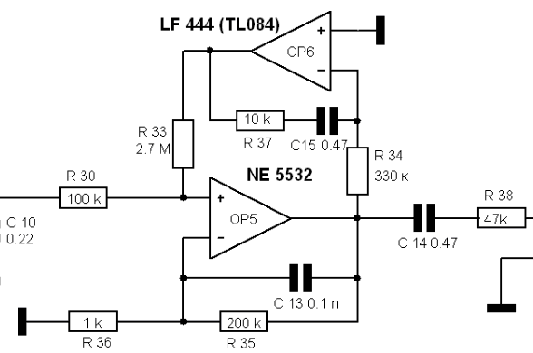

                      • I was thinking about the 27L2's on the bandito and had a look at some other schematics when I found this one;
                        I'm pretty sure that's how the original Bandito I have is configured. I remember reading 2.xx megs and 3xxk around
                        the 27L2 and there are .47's there too.
                        Should look something like this;
                        Anyone know how to calculate the filter frequencies for this type of filter? I usually do that but cannot find this configuration
                        on any calc sites....

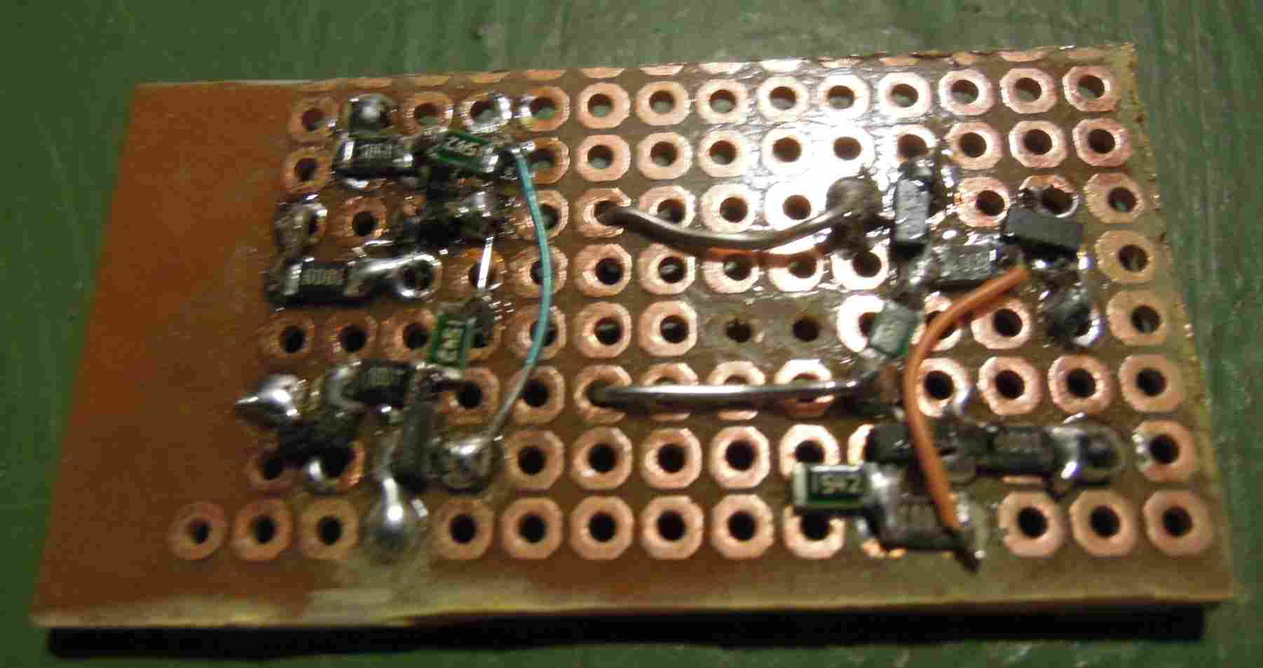

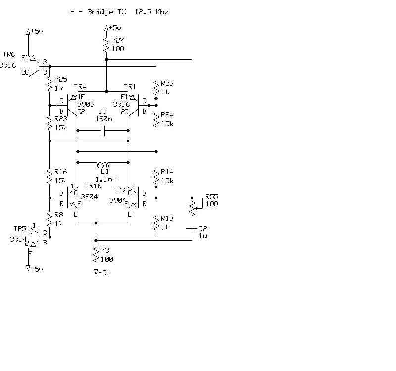

                        • So I whipped up this tiny transmitter (oops I noticed a jumper missing). It's an Hbridge
                          designed by Davor. Unfortunately you cannot use it with a stock Tesoro coil.
                          It puts a lot of current into the coil for not much battery use and fixes some other
                          problems with harmonics and such. I'll have to tickle the value a bit to get it to 10khz
                          and I'm not sure if it will work with the 6mh coil or a 1mh Minelab style is needed.

                            • And if you use original 4-Pin tesoro coils with RX: 15,04 mH,66,9 Ohm and TX: 0,929 mH, 4,3 Ohm? These are for 14-18 khz.
                              • The 4 pin is the right inductance's but this oscillator requires the TX to not be tied to ground.
                                The Minelab oscillator would work with the 4 pin and a standard Tesoro coil and get you some
                                additional current into the TX. The big question is will it make any difference? It appears the Deux
                                has different power levels available and most people say there's no difference other than the battery
                                not lasting as long.
                                It might be a big field charges the target too much and it doesn't decay fast enough to see it...
