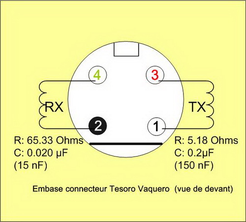

      Maybe there is a difference between the uMax coils. Tesoro only list two types of coil 4 pin Delta and 5 pin Epsilon.
      Found this
      Resistance looks quite different looks more like a normal coil with a finer wire and more turns on the RX compared to the TX
      • Well the new 4 pin coils are 1mh TX and 10 or 12 mh RX somewhat similar to the Minelab coil.

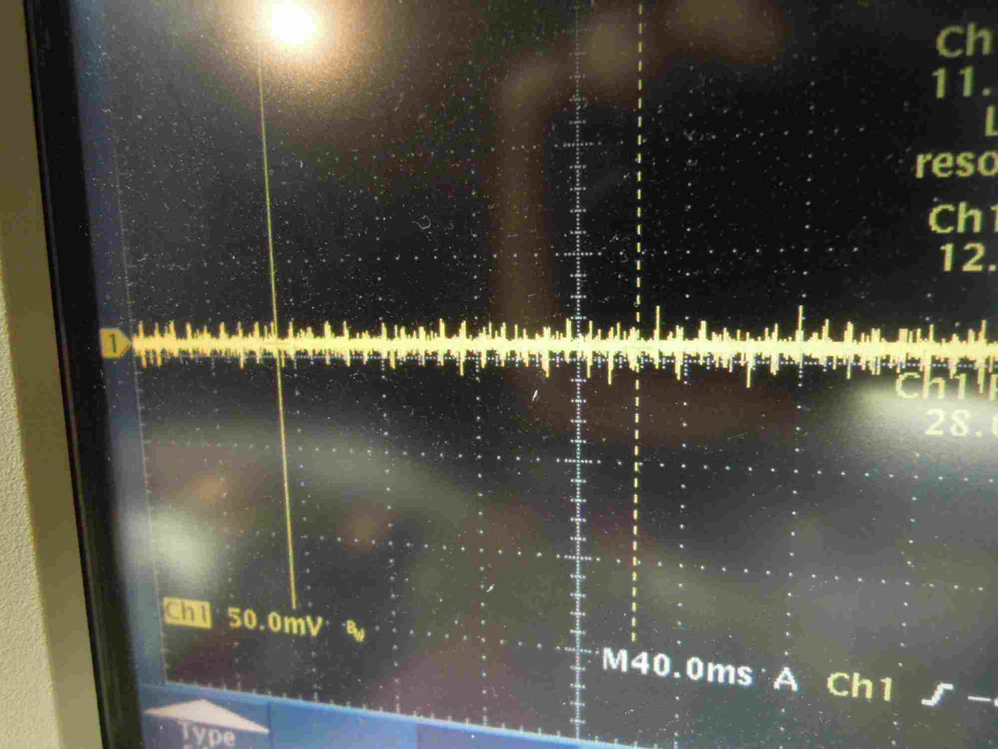

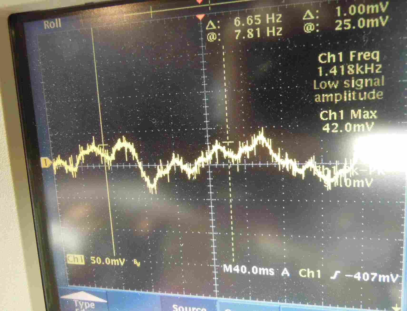

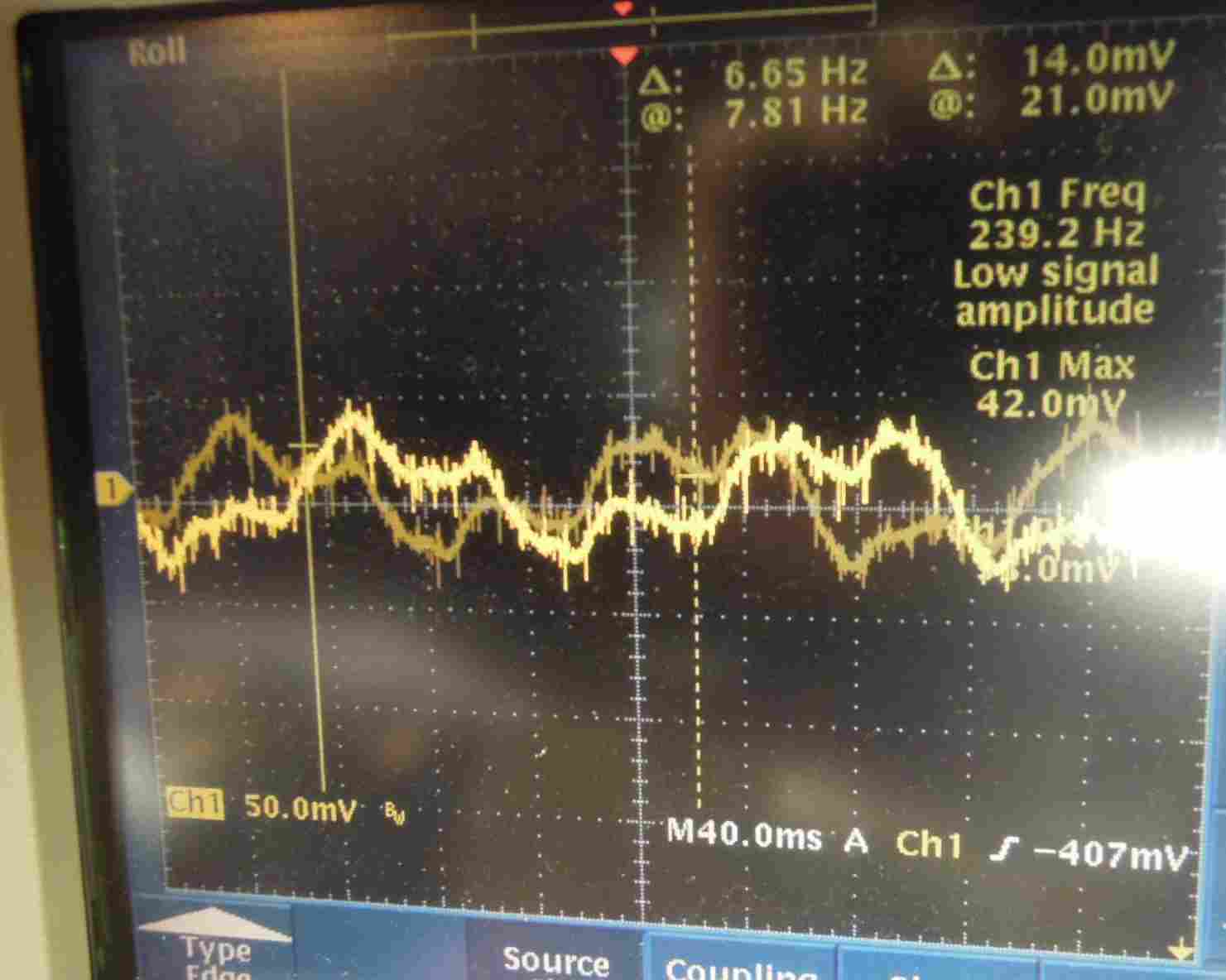

        • I'm not sure this is a problem as I didn't use a Sens or Threshold pot. I didn't think they were
          necessary unless you wanted more depth.
          So here's the inputs to the 393's;
          The fixed input to compare to;

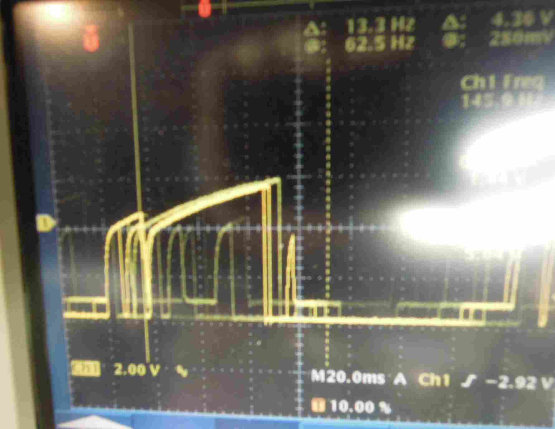

          And the chattering output;

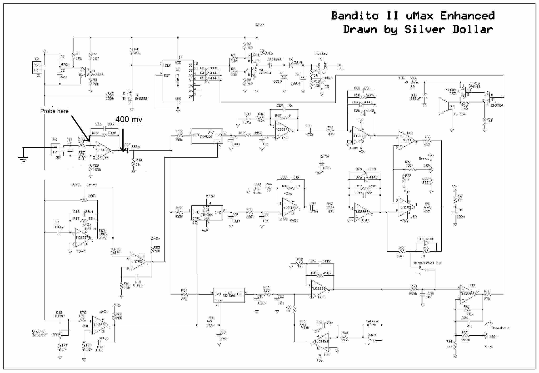

          • So there's defiantly a problem with my Bandito similar to the problem I had with TGSL.
            The RX input is a differential amp but is fed from a single ended coil. I get a sound
            when I probe to the grounded side of the opamp and see a 400mv signal out of
            the first opamp. I didn't check on the original Bandito but I'm using it's coil...
            I see a ring down on the output of the LM393 and am not sure if it's going through the
            power rails or standard path. I can hear targets but also get an oscillating tone. I did
            try to isolate the 393 using 10 ohm resistors and a 4.7uf cap on the plus and minus supplys.
            On the TGSL I shorted out the 2 resistors on the plus input of the opamp and grounded the
            4.7K/5.1K on the other side and that helped cure it. Maybe a cap across the 200k to ground?
            I'm not sure about the 39pf cap. I measured all resistors and caps incircuit but the pf value caps
            would not read...
