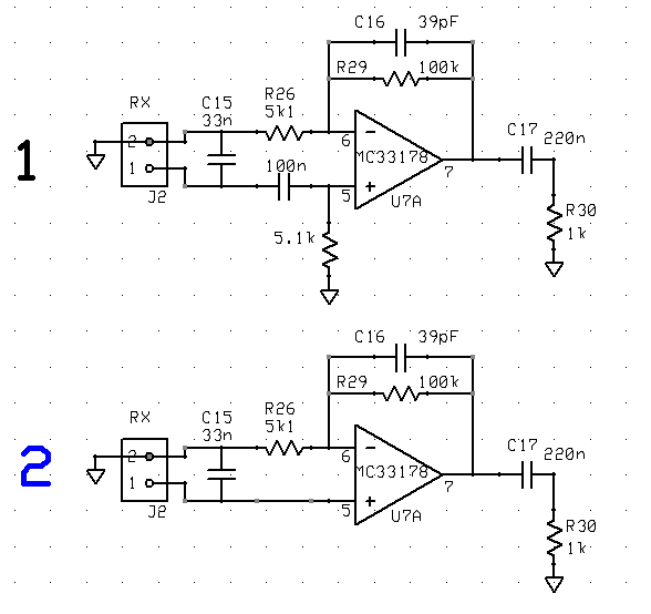

    • So I tried a couple input mods to try and increase depth.
      The first replaces one of the 5.1K input resistors with a cap for DC coupling and the 220K to
      ground with 5.1K for input impedance matching. This failed to gain and actually lost depth!
      No responce to silver and gold at 6" with this setup.
      The second worked quite well. I removed the 220k to ground and shorted the 5.1K input
      resistor thus allowing all the signal from the coil to get into the opamp. This netted
      8 1/2" on gold and 9 1/2" on silver. As always this might not mean anything in the ground
      but could gain a little...

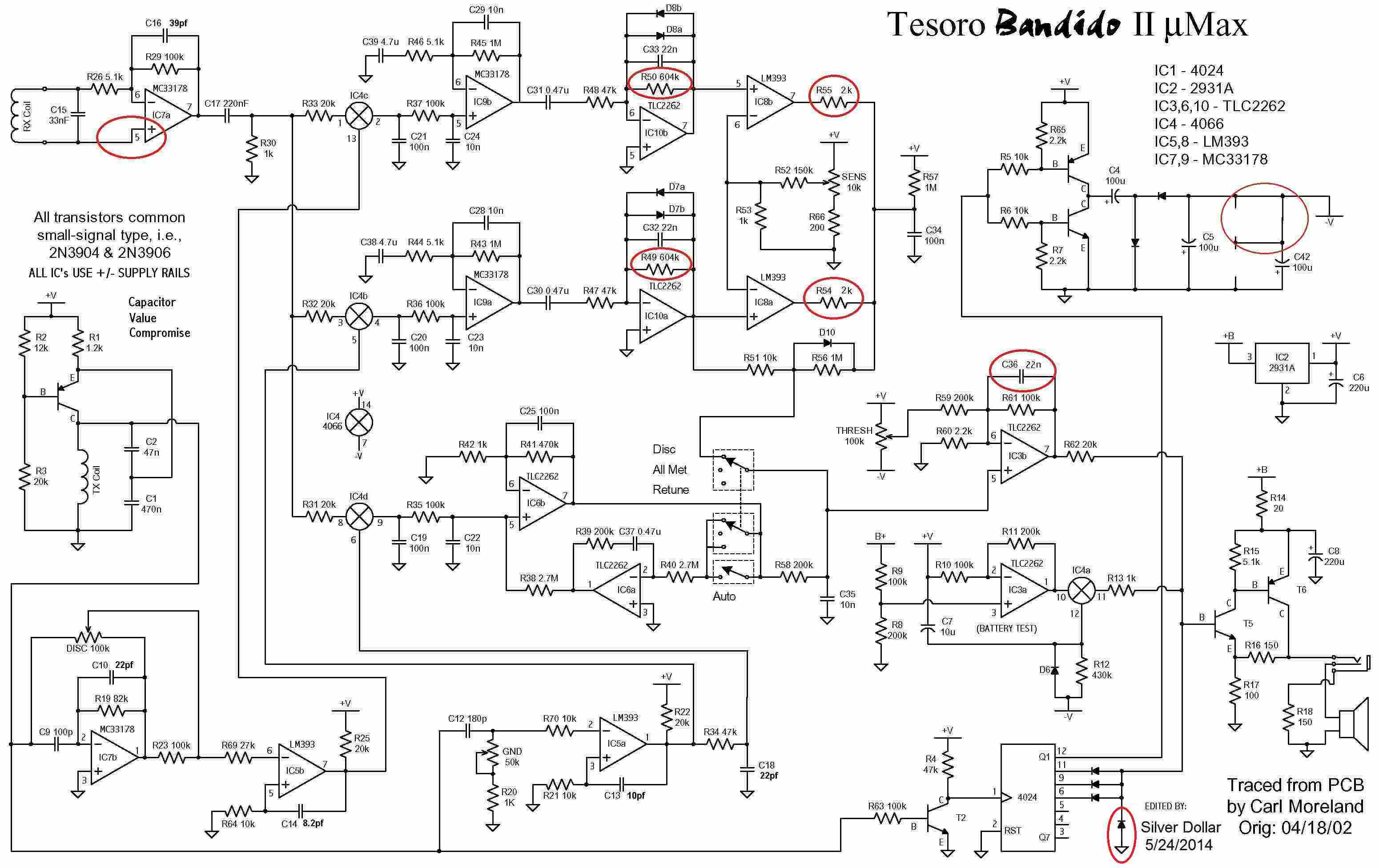

      • I didn't have 620k resistors so had to use 681k. The 22n caps should change to match
        the frequency we want out of the bandpass filters. So Tried 1Meg, 470K, 604K and 681K
        and found the 604K gave the best response.
        I tried a few values for the cap but 22n was best.
        Also the 100n in the Threshold amp has been found to work better as 22n. With these mods I
        get 9" on gold and 12" on Silver in air test. Here's a modified Schematic;

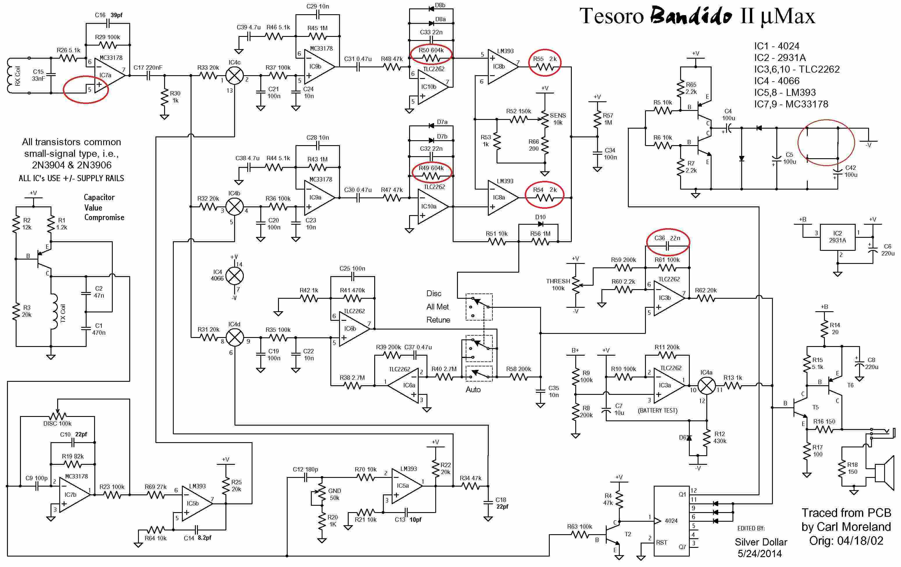

        • Oops one last mod. I found adding the diode to the bottom of the 4024 diodes gives about 1/2" more air test.
          So here's the schematic for all mods;

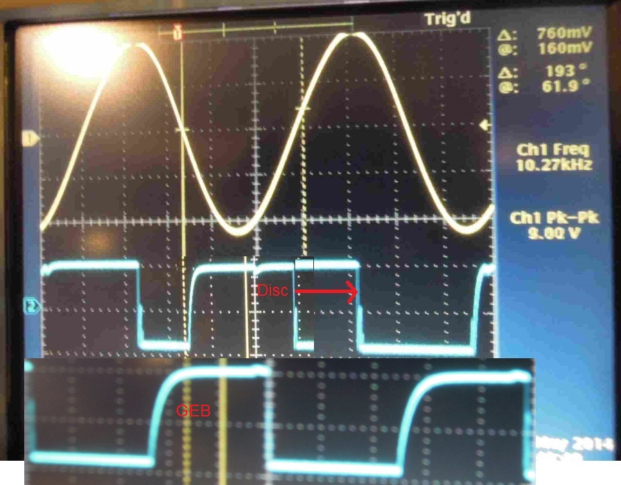

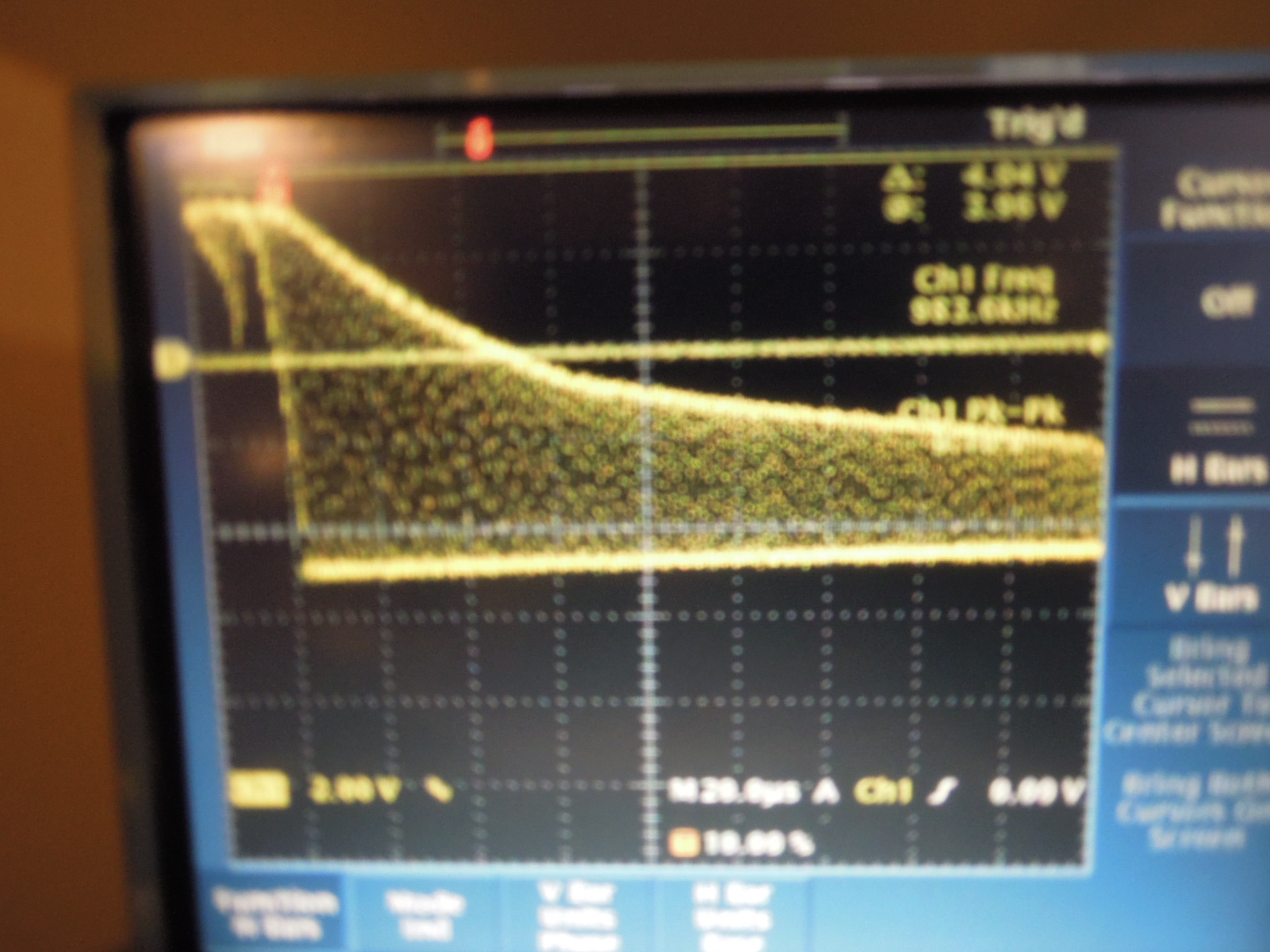

                    • I measured the Disc and GEB signals to check them against my TGSL and have a picture;
                      These are vs TX so look funny as the RX is shifted (maybe 200 degrees? Can't tell as can't
                      see the RX!).
                      The Bandito acts much different than the SMT Bandito and TGSL. It has random noise at
                      high sens and clean strong signals and can detect silver to 14". The target signals look
                      different too;
