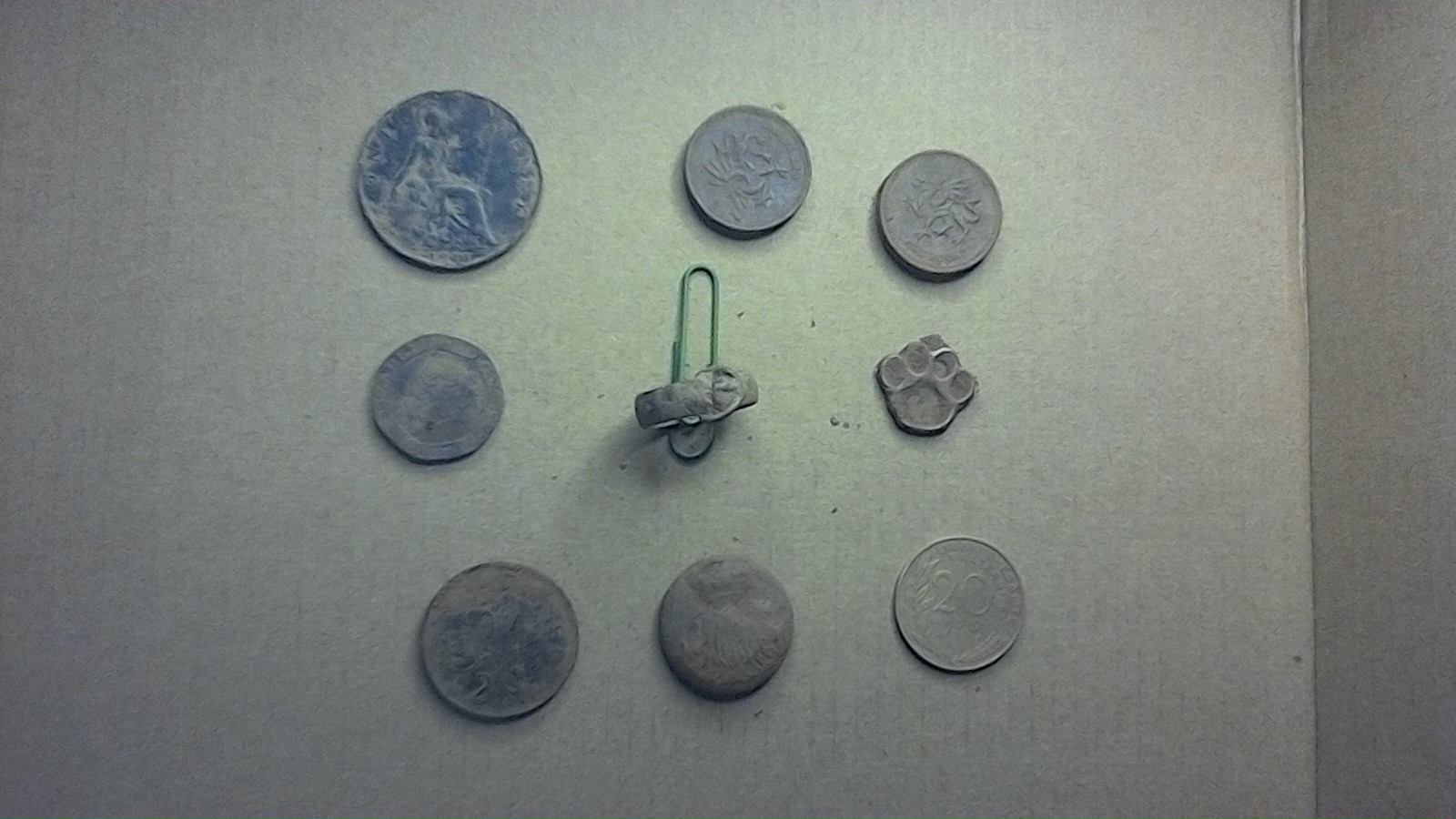

        • Yep after all that just the coil. With the 5.7" concentric. Big coins top out at 9" so not bad when compared to my IDX with a 10" DD coil which tops out at 13.5"
          Tiny silver coin the would fit on your little finger nail is 6" in fact most small targets are around 7".
          Discrimination seems fine foil cuts out nicely. I was slightly disappointed when compared with some video on YouTube but could not find a video with the 5.75 and Bandidio.

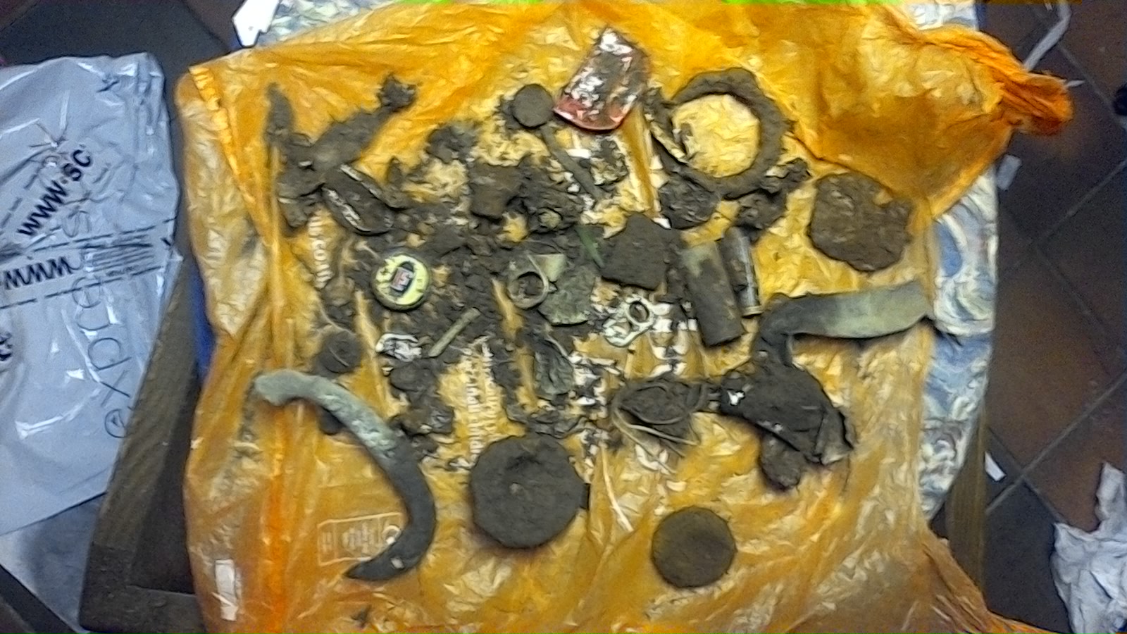

          • Been out with the new coil. Long wet grass was no problem. Like it. Ran with zero discrimination. Did not dig much iron. Some of that was just to make sure. Going to take a bit to get use to the tones.
            Hard to explain but seems to hit a target much stronger than my IDX as you sweep you know instantly if it good and just go back over it to pinpoint it. IDX I was continually going back and checking pop and beeps.
            Fields weren't that productive but did as well as everyone else

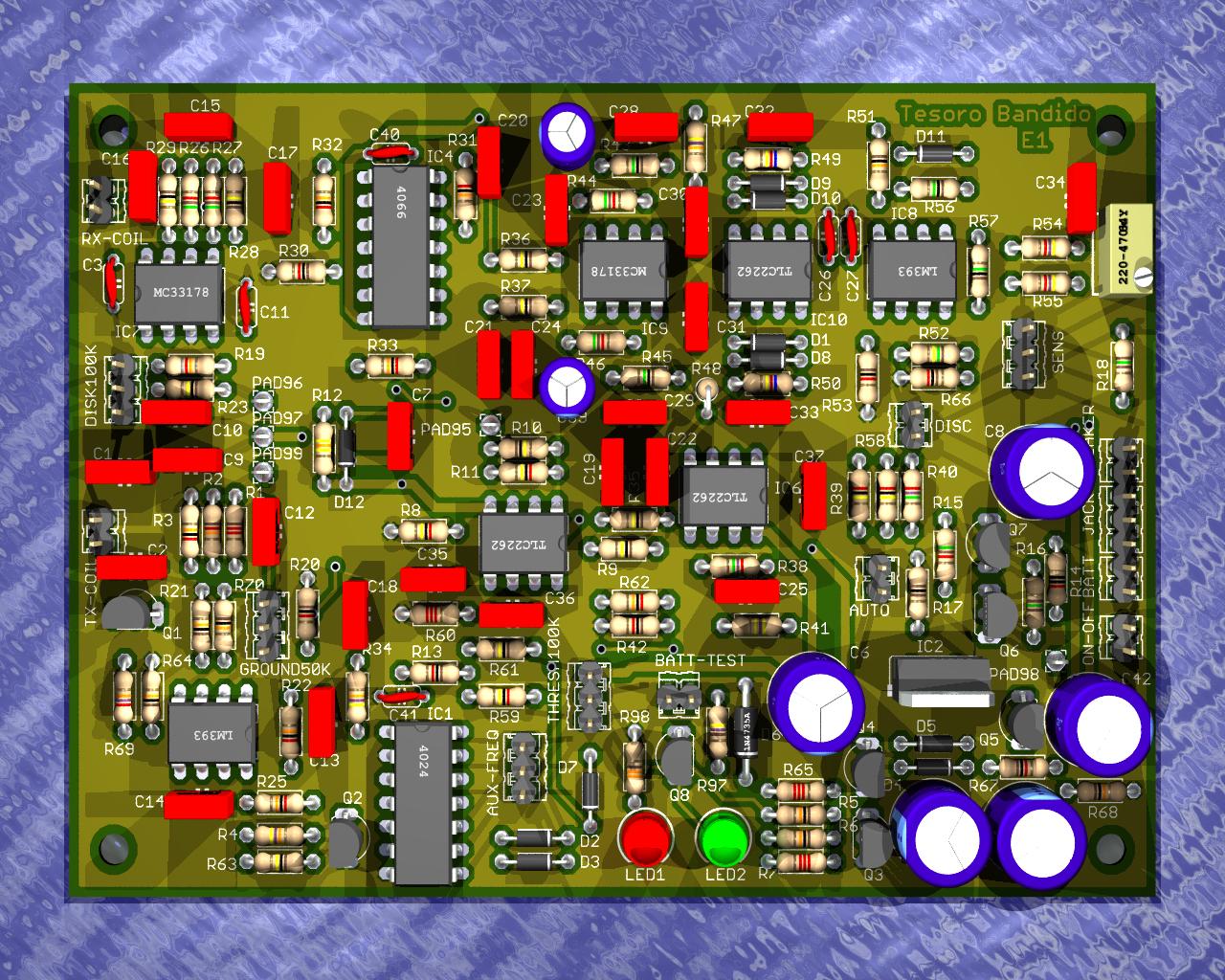

            • Any one have bandito layout not SMT parts??
              • I have Rev.1, but I have no idea how good this PCB is
                  Thx alot i also get one version from member here on geotech
                  • That was my PCB layout. I still have the machine with this PCB and I still use it. I don't remember if I had to correct any mistakes on it or not. I can open the machine and look if needed. It's still my favorite machine.

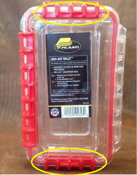

                    • can anybody give a link where to buy such submersible box? http://www.ebay.com/itm/TESORO-BANDI...oAAOSwYaFWcF53
                        Do a Google for "pelican 1040 case" loads here in the UK but don't know if they will ship to you for a reasonable price
                        • http://www.ebay.com/itm/PLANO-4648-L...sAAOSwhcJWJQkc
                          I don't know what size your looking for, but what ever you get, make sure it has the 3 grips to hold the top on. Click image for larger version
                          I have a bunch of these, all different ones but not as good as the plano The link goes to the smart phone ones just keep digging you'll get to the bigger ones.

                          • Originally posted by Merc View Post
                            Merc
                            ok mate can you pls open and see i make holes in pcb and i start to solder parts,but idk if pcb have mistakes!thx alot
                            I have also this version but idk is okk

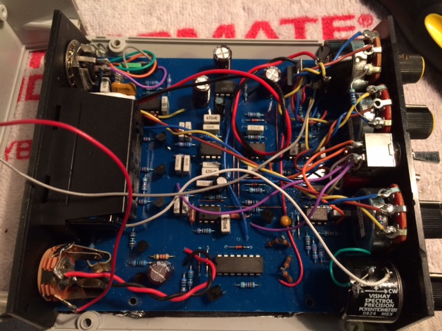

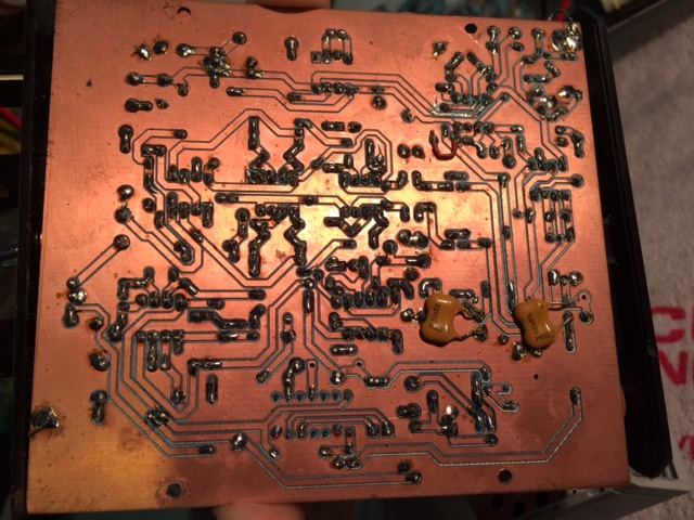

                            • I have looked at my board and I see some modifications but not really any errors. Please remember that since the PCB is single-sided, I ran into problems getting signals from one part of the circuit to another and used wires. There are several short "Jumper" wires and a few longer wires. There were called out on the schematic and the PCB layout I posted. Example : Wire A to Wire A. On the back of the board, I added 2 small capacitors to simply tweak the ground balance. I had to do that to get the range of ground balance without being right at the end of potentiometer travel. I also added on the bottom of the PCB a short wire to connect a pin to ground. I mechanically engraved my PCB and sometimes there is not enough copper left in an area and a pin gets isolated even though the layout shows it is grounded. It was just a side effect of my mechanical etching. If your are using conventional chemical etching, your PCB should be fine. I will include some pics.Click image for larger version
                                I have looked at my board and I see some modifications but not really any errors. Please remember that since the PCB is single-sided, I ran into problems getting signals from one part of the circuit to another and used wires. There are several short "Jumper" wires and a few longer wires. There were called out on the schematic and the PCB layout I posted. Example : Wire A to Wire A. On the back of the board, I added 2 small capacitors to simply tweak the ground balance. I had to do that to get the range of ground balance without being right at the end of potentiometer travel. I also added on the bottom of the PCB a short wire to connect a pin to ground. I mechanically engraved my PCB and sometimes there is not enough copper left in an area and a pin gets isolated even though the layout shows it is grounded. It was just a side effect of my mechanical etching. If your are using conventional chemical etching, your PCB should be fine. I will include some pics.[ATTACH]34685[/ATTACH][ATTACH]34686[/ATTACH]
                                Ok thx mate on nice pics i will try make and see what will happened
