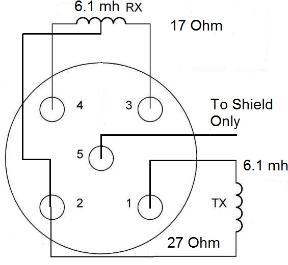

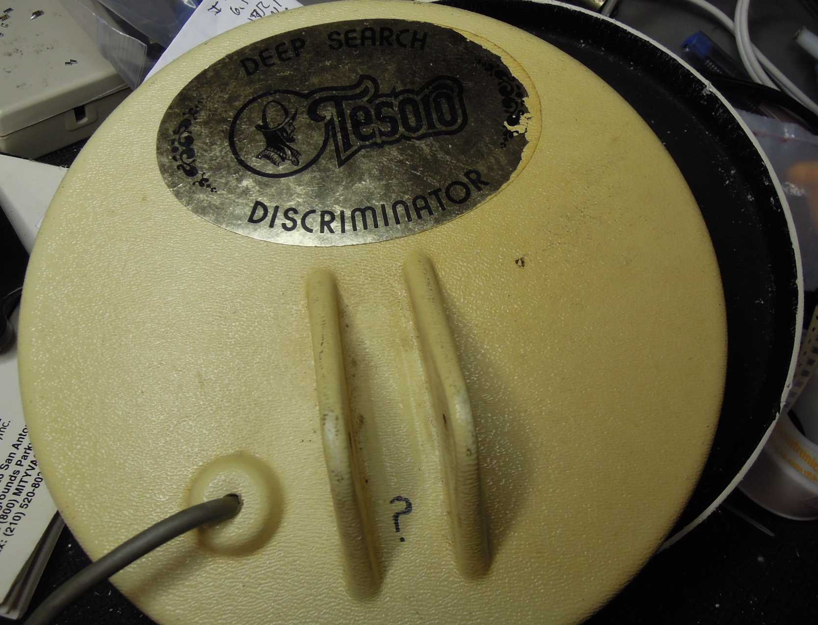

    I got the widescan coil today. It is 7" and has a centertapped RX. A funny thing though the
    RX coil measures 6.1 mh and 17 ohms but the TX measures 6.1 mh and 27 ohms! It almost
    seems they swapped the TX and RX but the centertap is on RX...
    It also doesn't perform as well as the Brown 8" concentric. On coins the Deepsearch does 6"
    where the Brown Concentric does 7". I thought the DD coils were supposed to go deeper?
    The null acts just like my homemade centertapped coil. With just TX connected a scope
    across the RX reads 4.7V p/p but connecting the shield to ground gives no signal at all!
    By the way there is no connection at all from the shield to RX or TX in the coil. The center
    of the RX is tied to TX ground. The wire seems a bit cheezy and is very short. I'd like to
    get inside it and rewire it at least and maybe lift the centertap? I started running an exacto
    around it but it might be a bit difficult to cut all the way through...

      I thought a concentric were deeper. DD have the same depth ish down the center of the coil where as the concentric is only deep at the center and drops off quickly.
      Resistance of you new coil do appear odd

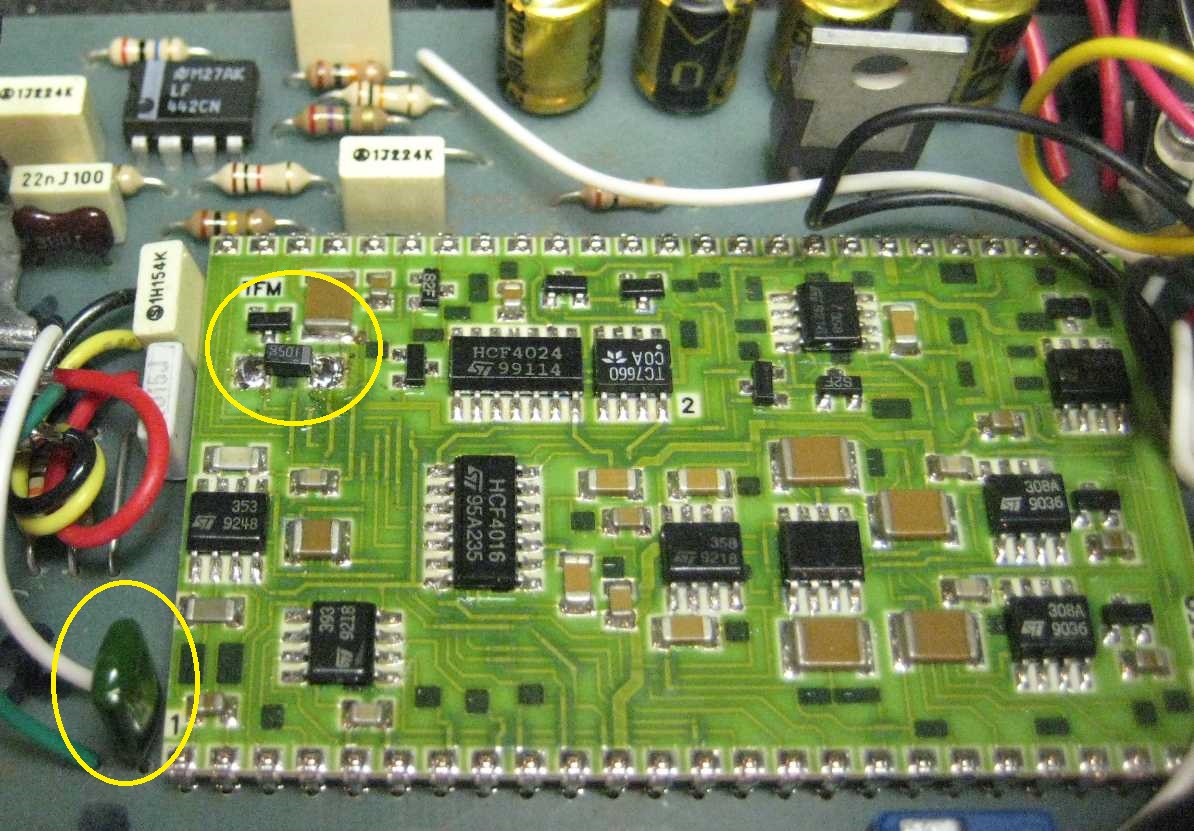

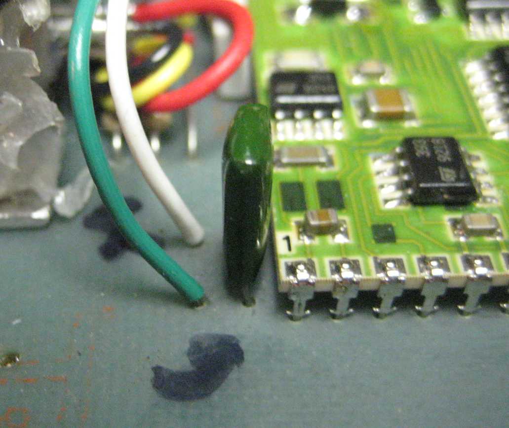

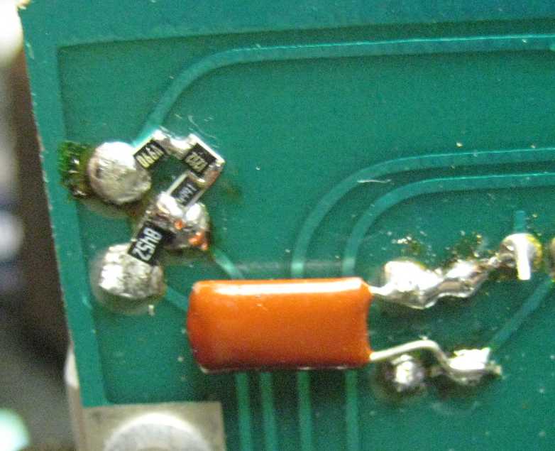

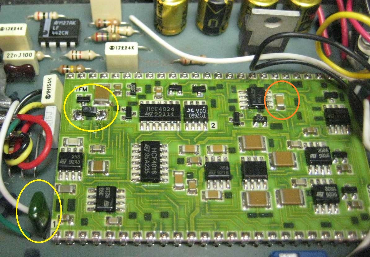

      • I did a couple of Mods to the Original Bandito today. I will take it to the beach
        this weekend and wanted it to be "tuned up" for the job.
        I use a cap substitution box to set the RX cap to the best value. The cap is
        actually 2 caps stock. A 10 nf is on the regular PC board so I removed that
        and substituted some in it's place. The original measured 9.45n and the new
        one is 11.1n. That gained me maybe 1/2" in the air, it doesn't make a huge
        difference but maybe some marginal targets will be heard!
        I also replaced the threshold pot on the back of the unit with fixed resistors.
        That sets the amount of volume change with depth and I don't imagine ever
        adjusting it.
        I found the cap that sets the length of the tune on battery check beep too.
        It was a 10uf on the back side of the sub straight and I changed it to 1uf
        so now a nice short beep to let you know it's on but not announce it too much!

        • Here's one more tweak. The 100n cap at the last LM358 determines the size pulse
          that gets through to the speaker. I have reduced it to 22n in the past but here find
          that a 47n + 22n (69n) gives the best response. I can discern targets to approximately
          10 inches with this mod. Not sure how it will work in the ground but I believe you can
          reduce the sens if it proves to be a problem...
          (it's the one circled in orange)
          It is very difficult to remove parts from this substrate so be careful if you attempt this mod...

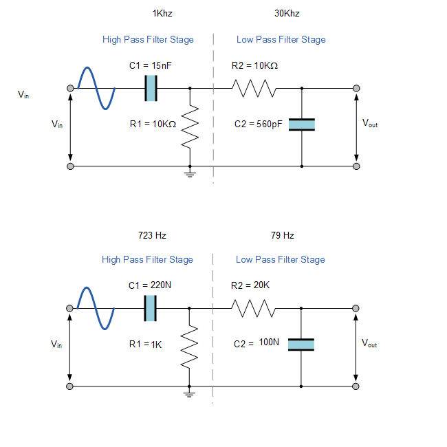

          • I'm trying to figure out the filters just after the input opamp and it seems to be designed wrong.
            The classic bandpass has a highpass set lower than the lowpass (say 1 khz to 30 khz) but the
            bandito has the highpass higher than the lowpass (723 hz to 79 hz) somewhere I had a blurb
            about how the 4066 switch affects this but cannot find it right now.
            Does anyone have any ideas about why they set the filters like this?
            • Oh i found that quote from Davor "It has 20k in series with the bilateral switch that is 50% time open (thus behaving as a 40k resistor) and a 220n capacitor, giving a -3dB point at 18Hz"
              I had good results on the SMT Bandito changing that cap to 20n = 180hz but not so good on the real Bandito, it seemed to allow more noise through...

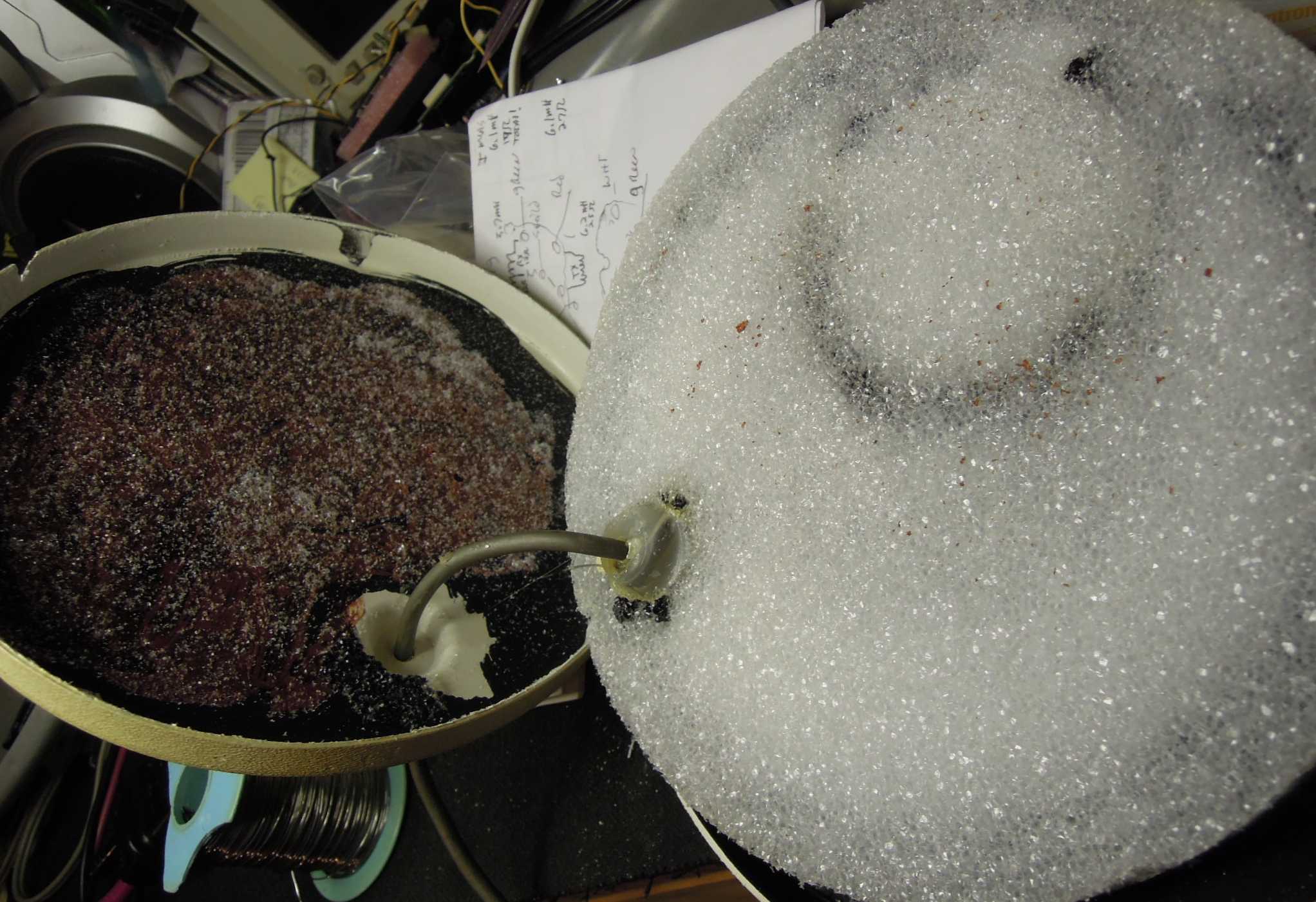

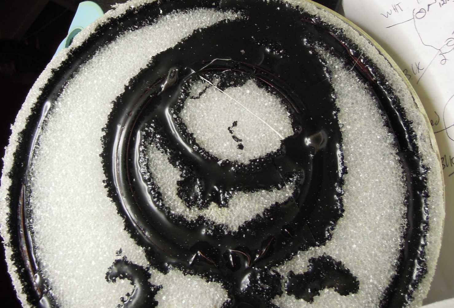

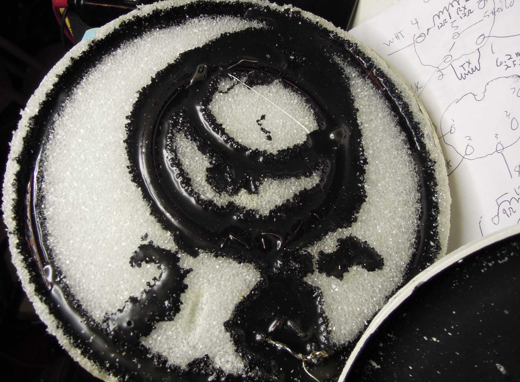

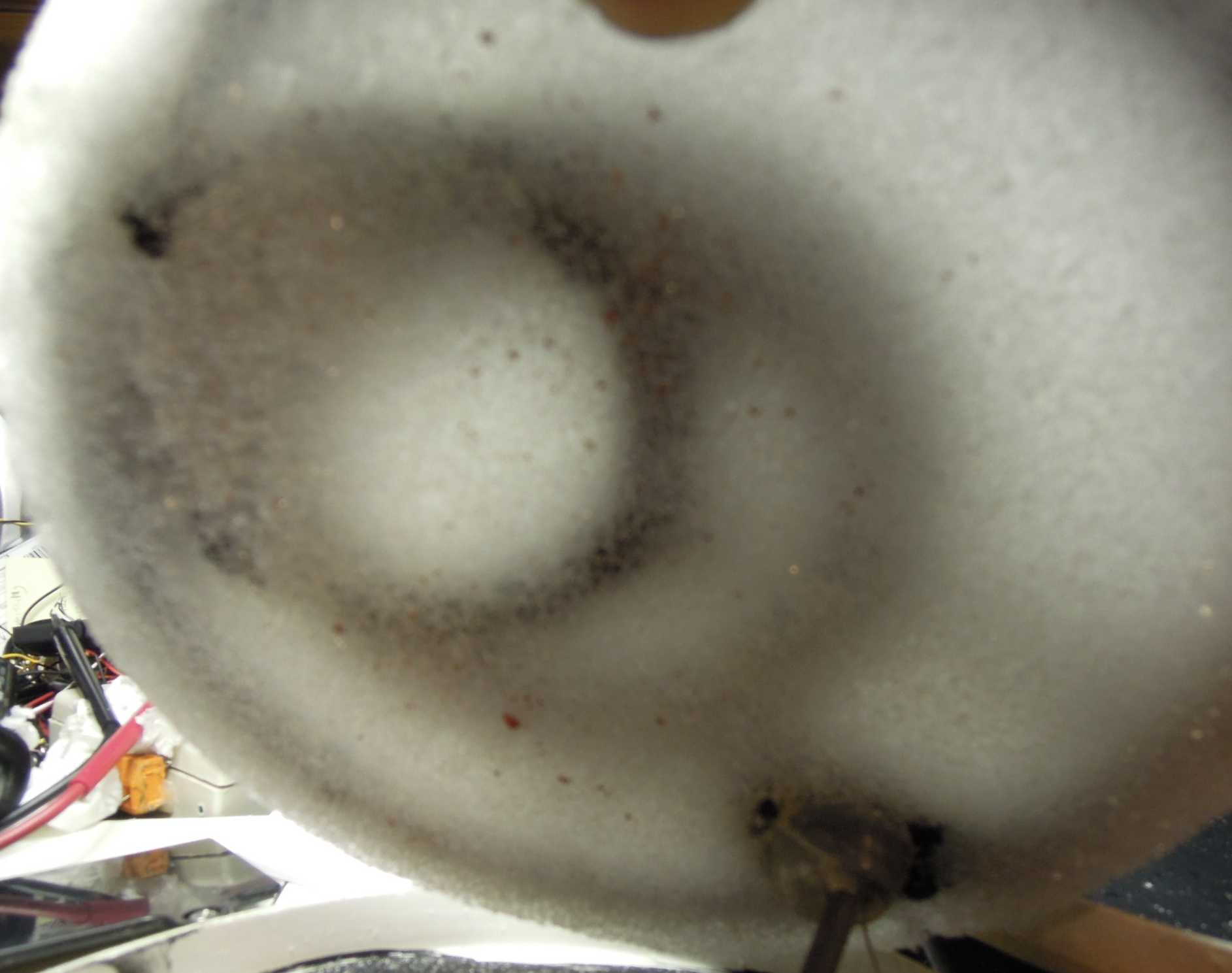

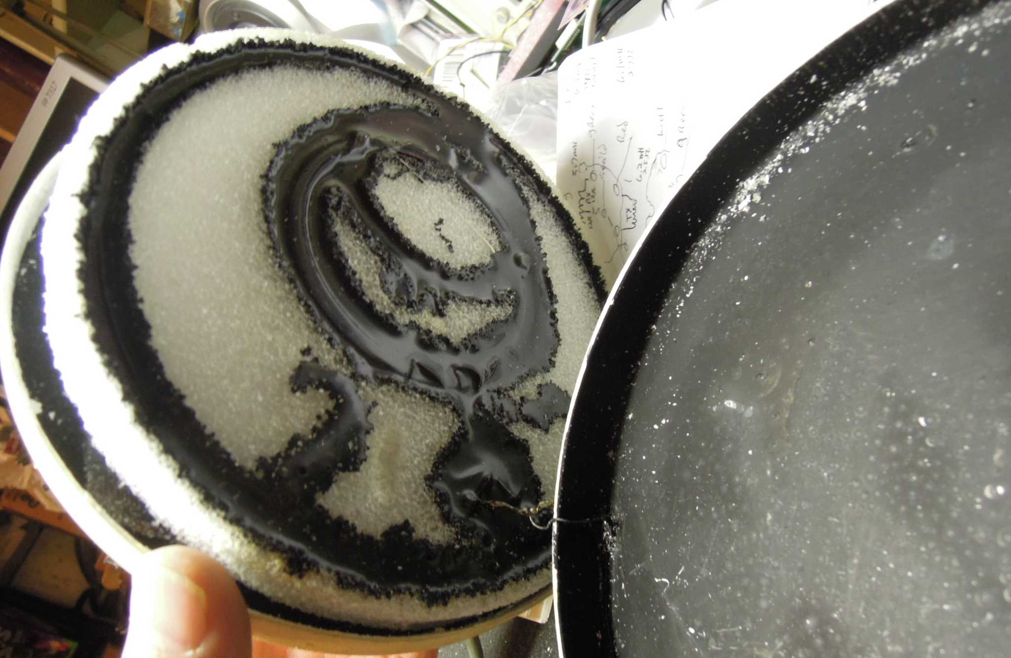

              • Well I opened up that Tesoro coil today. It is actually called Deep Search and it looks like an
                omega possibly. Not sure why centertapped or why TX resistance is so much. Here's some pics;
                The graphic paint reads 10k per inch in spots (bottom cover) and 5k per inch in other spots (top cover)...
