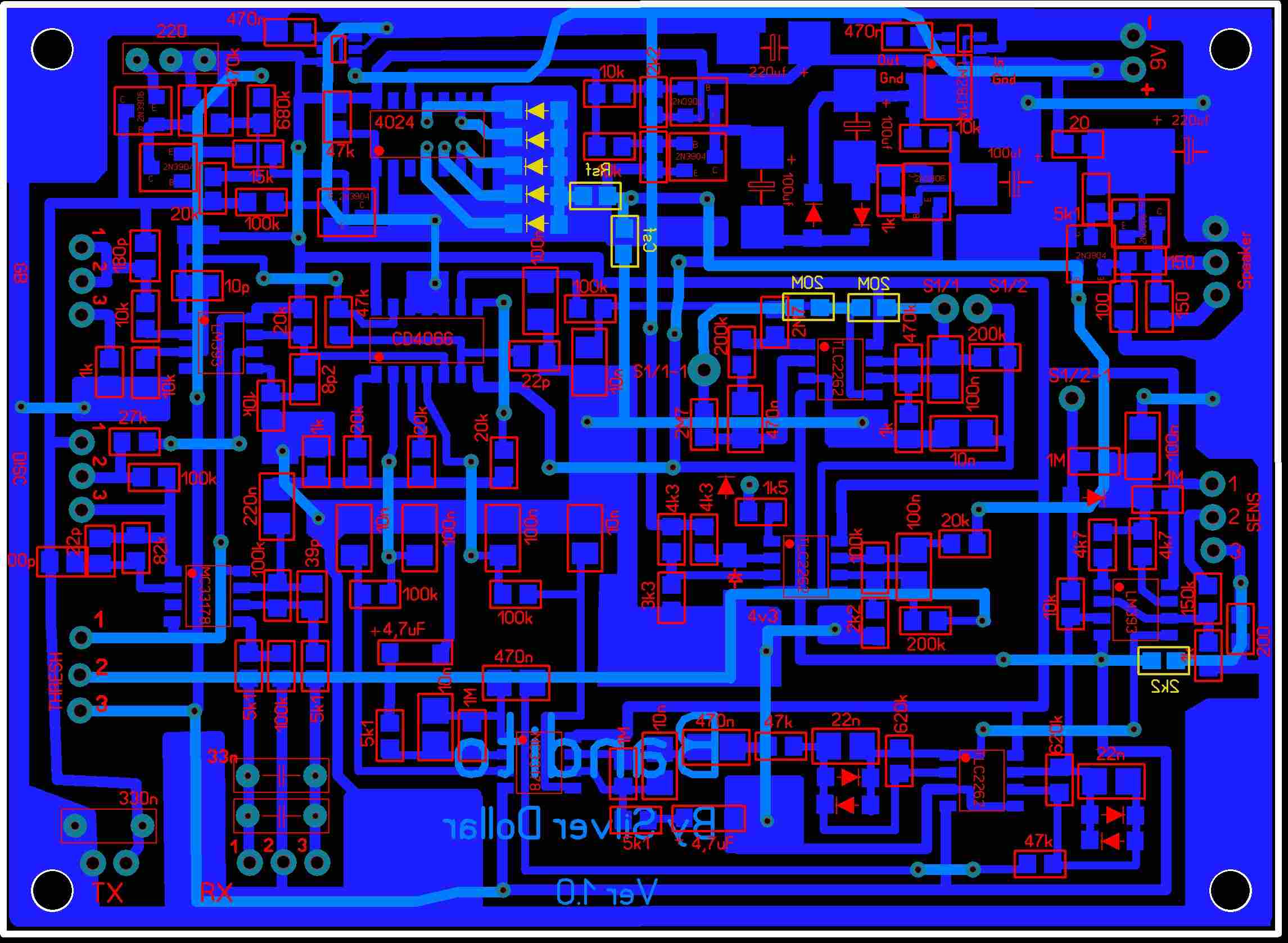

              Cheers good for magnification managed to acquire two industrial ones and have a wide selection of tips for my iron. Ordered from DX some good quality solder braid and some solder paste to try. Looking at the schematics and there are some parts missing from the list like the zener diode probably not needed (battery LED)
              One of the transistors is a different pad size SOT-323 will have to change the parts list.
              Also on one of the thread there was mention of 3 alternate transistors but can only see two type on the schematics. Could have been for the TGSL as some of the thread are merged.

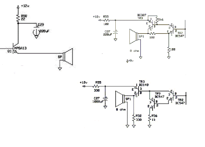

                Um it looks like 3904 and 3906 are the only transistors. Which one has a different pad size?
                Some of the audio circuits are different on TGSL, usually to add a BD140 for more volume.
                I've seen 1 MPSA13 or 2 transistor or 3 in the audio output stage. It looks like our layout uses
                a 3904 and a 3906.
                Here's a picture of the 3 possible configurations;

                  VT2 2N3904 top left of board between 4024 and 4066 tiny tiny transistor size there room on the board for a normal SOT-23
                  no 2N3904 in that size listed have to use an alternate part
                  • #70
                    Oh ya I see it. I noticed the smaller outline but saw the value and assumed it was the same size.
                    I'd add jumpers if necessary or try to place it just right using the standard part. Ill have to fix that
                    on a relayout... Most likely a mistake should have been the same size as the others.

                      • #72
                        I'll bet the design was originally a Russian one and someone changed some things.
                        They changed the transistor pads but just missed one. I see hints of this in the
                        ground areas and some of the caps have smaller and larger pads layered on top
                        of each other. I get some complaints from a free gerber viewer because of some
                        of the changes and am not sure the layout guys would like it.
                        If I make more boards I may start over and put the pots along one side so you
                        can board mount them. And fix all the details problems at the same time.

                          Well my board came in today so i'll try putting as many parts as I have on it
                          then see what I need to order. I have a SMT TGSL coming so want to order
                          parts for that too...
                          • #74
                            Well I can definitely say the resistors are 0805 the 1206's are too big! I squeezed a few in by
                            soldering one side and sliding it off the pad a bit to have access to the pad on the other side
                            but not recommended. Most of the caps are 1206 sized but some are smaller (10pf?).
                            The 3904 that has the wrong sized pads can be soldered but only 1/2 the leg is on the pad,
                            close enough, it's only to feed the clock to the 4024...
                            I tried using some 150uf SMT caps for the 220's, one worked but it's tough to get room for the others.
