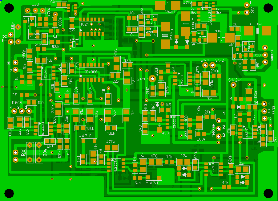

    I took a copy of that board and am comparing it to our board looking for mistakes + improvements.

    Few mistakes in it but see if this works

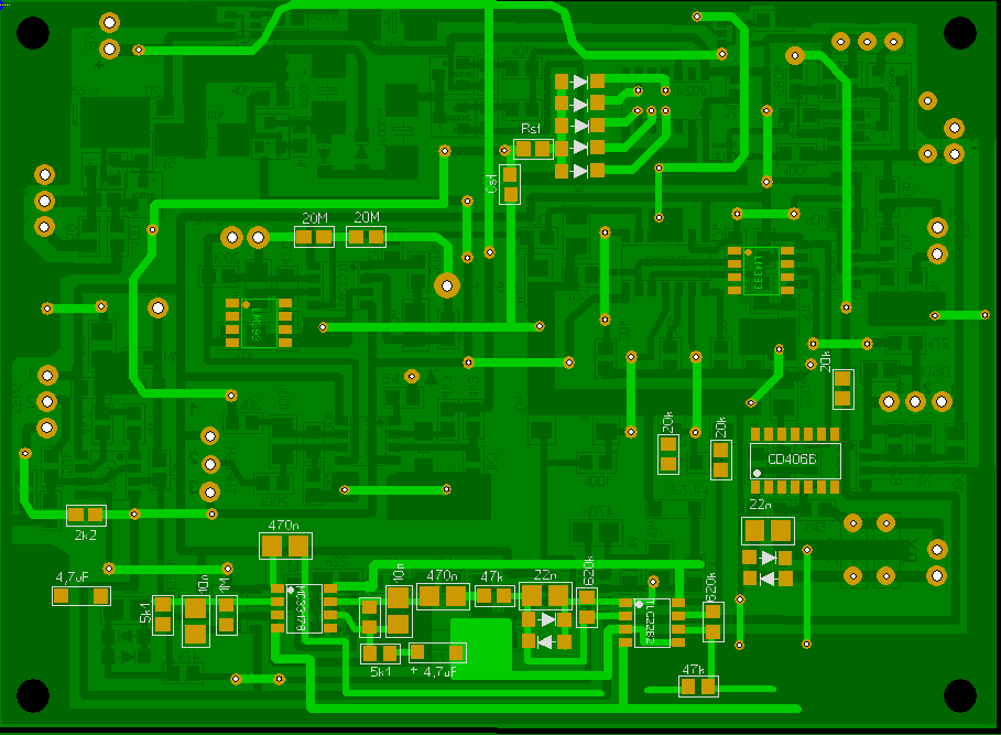

      Here's some pics of the Dual Layout, it's my first try at board layout it's kinda fun, like a puzzle.
      I still have the original, original with mods, with mods and SmD caps and this monster;

        Your new layout looks clean

                started on the capacitors did not reilise they were all different sizes so will have to start again
                can't find the 10uf on the board
                on the board there are two over the RX but on the schematics there is only one.
                have you recieved your board yet. Transistor that's on the CD4024 has very small pads might have to find a different transistor for it
                C14-8.2pf :0805
                C13-10pf :1206
                C10-22pf C18-22pf
                C16-39pf :0805
                C9-100pf :0805
                C12-180pf :0805
                C22-10nf C2 4-10nf C23-10nf :1206
                C32-22nf C33-22nf :1206
                C15-33nf :through 5mm
                C2-47nf :through 5mm TX coil
                C19-100nf C21-100nf C20-100nf C34-100nf C36-100nf C25-100nf C28-10nf C29-10nf C35-10nf :1206
                C17-220nf :1206
                C1-470nf :through 5 TX COIL
                C37-0.47Uf C31-0.47Uf C30-0.47Uf :1206
                C38-4.7Uf C39-4.7Uf :through 2mm
                C7-10Uf
                C4-100UF C5-100UF C42-100UF :through 3.5
                C6-220Uf C8-220Uf :through 3.5
                C3-??
                C11-??
                C26-??
                C27-??
                C40-??
