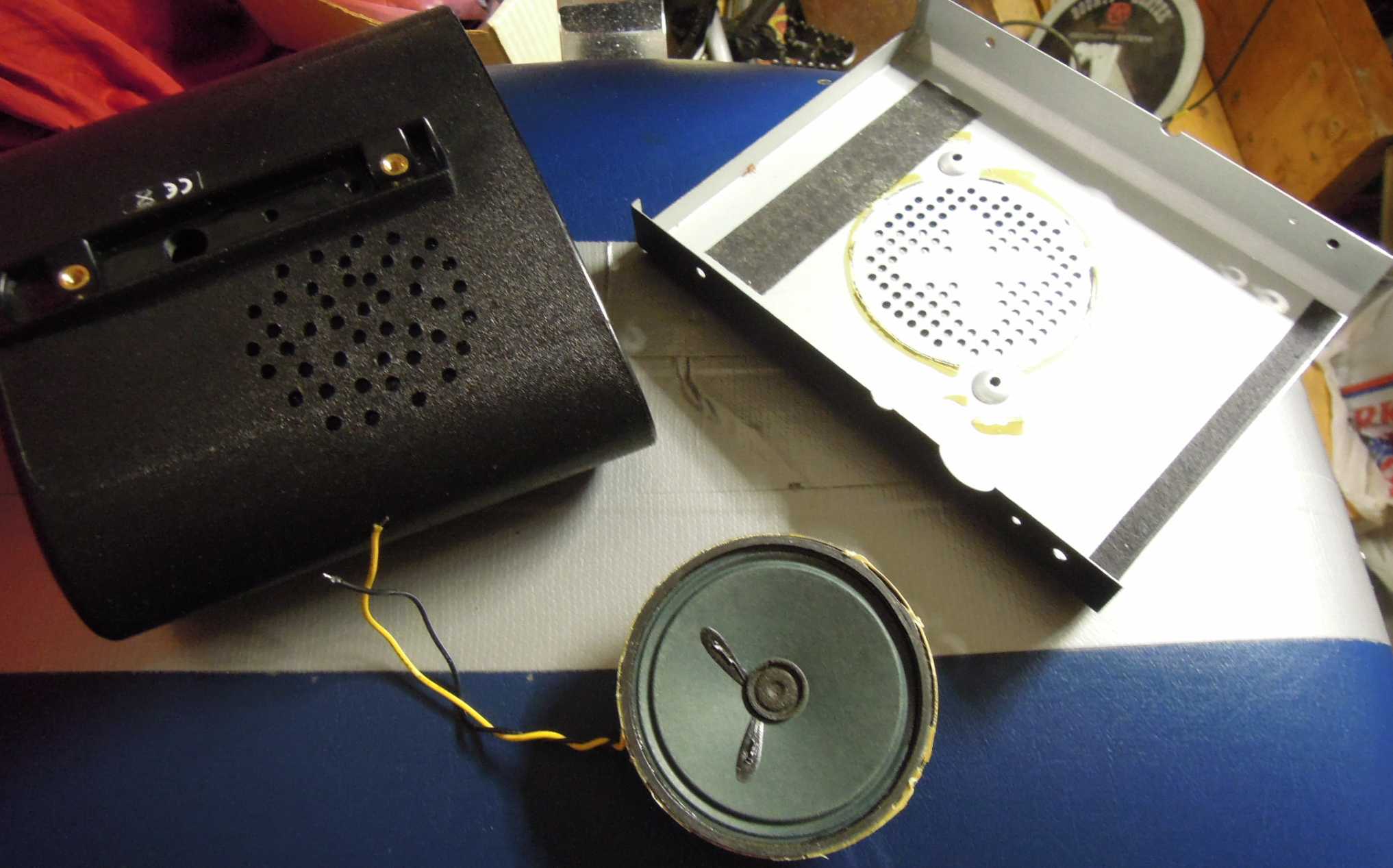

        • make sure you don't loose sensitivity to very small objects by increasing the TX voltage. I know golfnut uses this mod to good affect on his IDX. Some tried the same mod but had worse sensitivity to small target. They had no more depth but hit on coin size targets better.
          • I saw the depth lower with a bigger TX before. 9V seemed to be the sweat spot.
            But I now have 10.2V at 12.5 khz and by tuning the RX have gotten a good
            signal.
            I compared the original Bandito to my SMT one today and the SMT one beats the
            original by 1" on each test. Then I tried a few different speakers and gained 1"
            by using an old CB radio one. It's louder too! Now I have to make a volume adj
            pot!
            The final figures;
            Silver Dollar 13"
            Gold Ring 12"
            Coins 9"
            But these are only with that "special" speaker. It allows higher Sens somehow.

            • wounder if the audio lacks some punch to drive the speakers. I did some experiments with headphones on the IDX and the lower the impedance the greater the depth in all metal mode made no noticeable difference in Disc mode. Always meant to change the mpsa13 for a mpsa14 but never got round to it as I am always using the detector.
              • I found some problem using the 9V for the TX. I think the speaker causes problems on the 9v.
                The thing oscillates implying positive feedback. The opamp filters are on separate channels so
                should act differently. The only place for a problem is at the TX or RX input. The speaker will
                radiate a magnetic field though I tried a 25 ohm speaker from a TV that had metal shields on the
                back and no improvement. This CB speaker seems to have a limited bandwidth that somehow
                reduces the feedback. I might try removing the transistors feeding the speaker and use an
                external amp. Ivonic had problems when adding headphones so there's something funny there.
                What is the difference between MPSA13 and 14?
                I did notice the original Bandito has loud audio. The SMT one didn't but is close with the new speaker...
