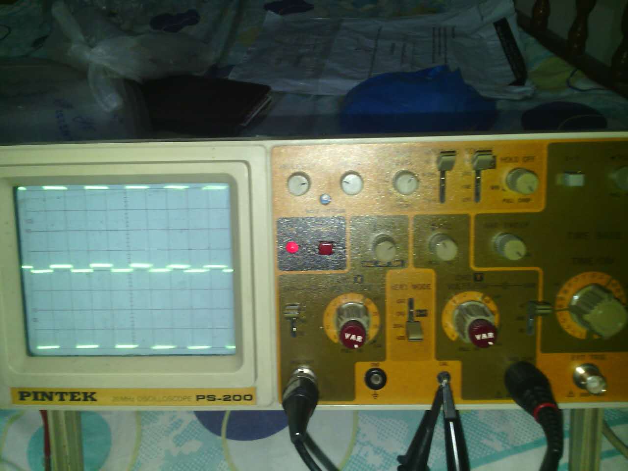

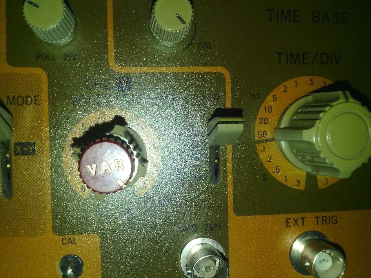

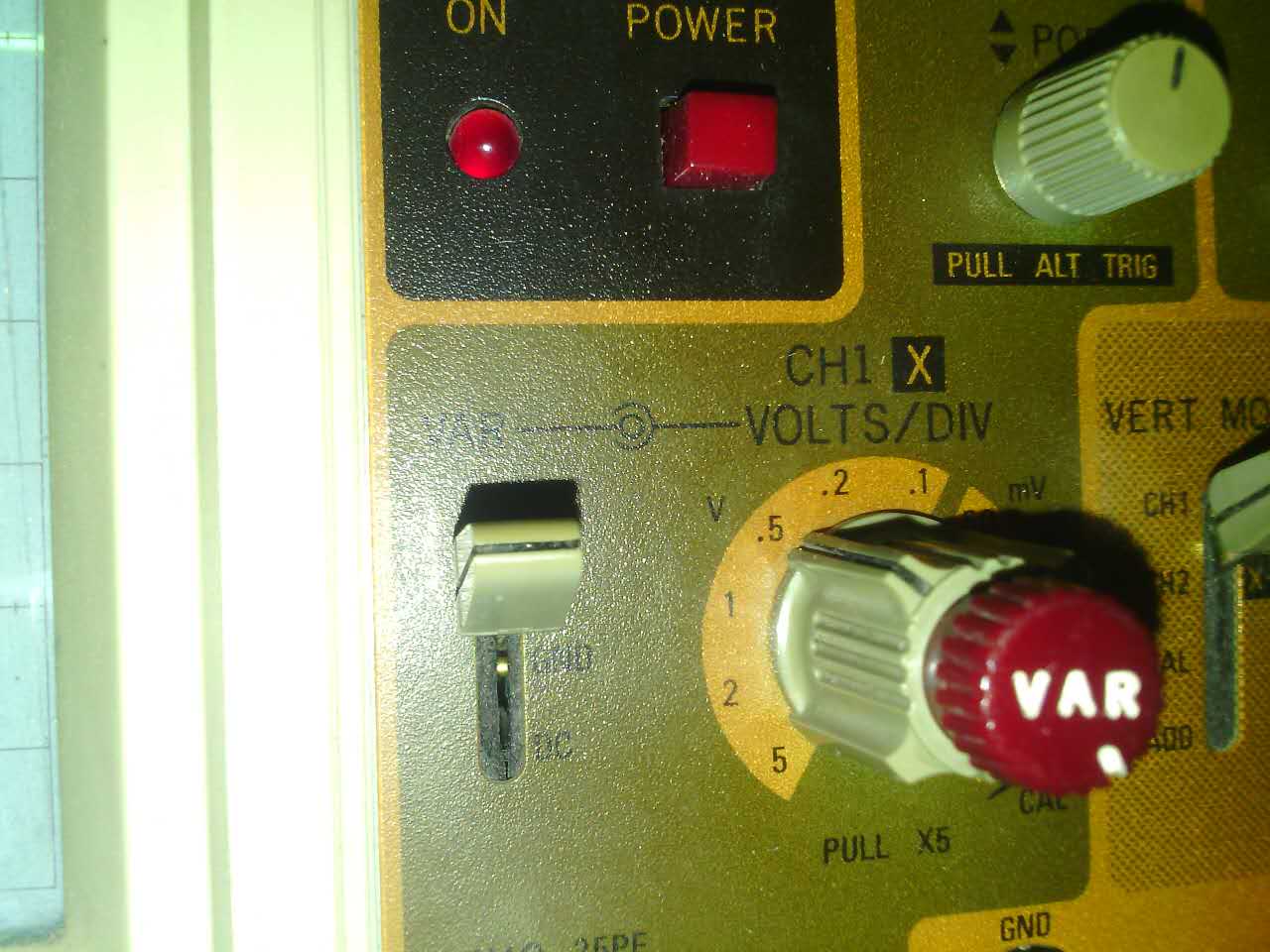

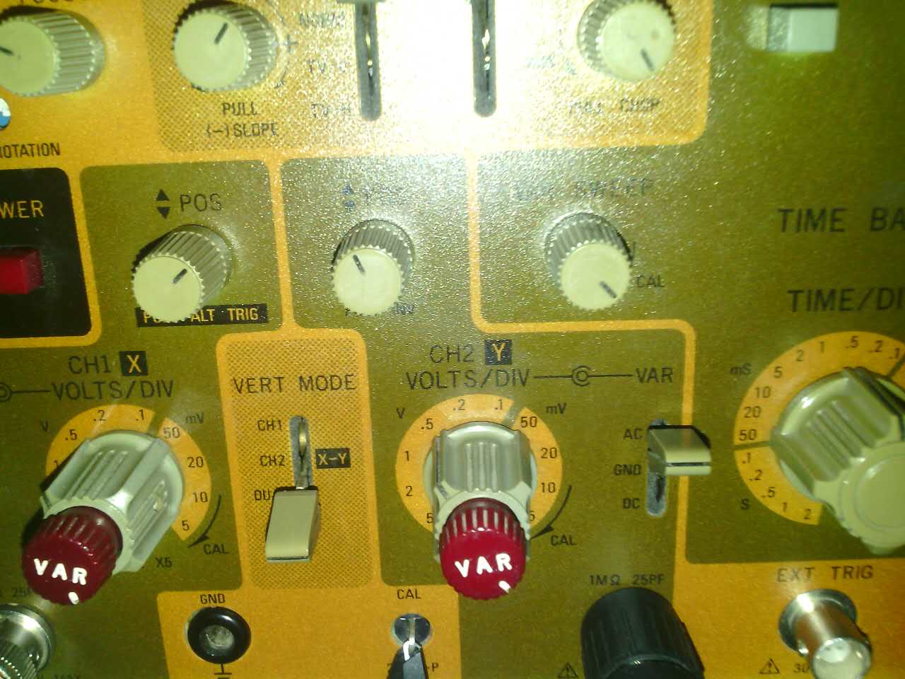

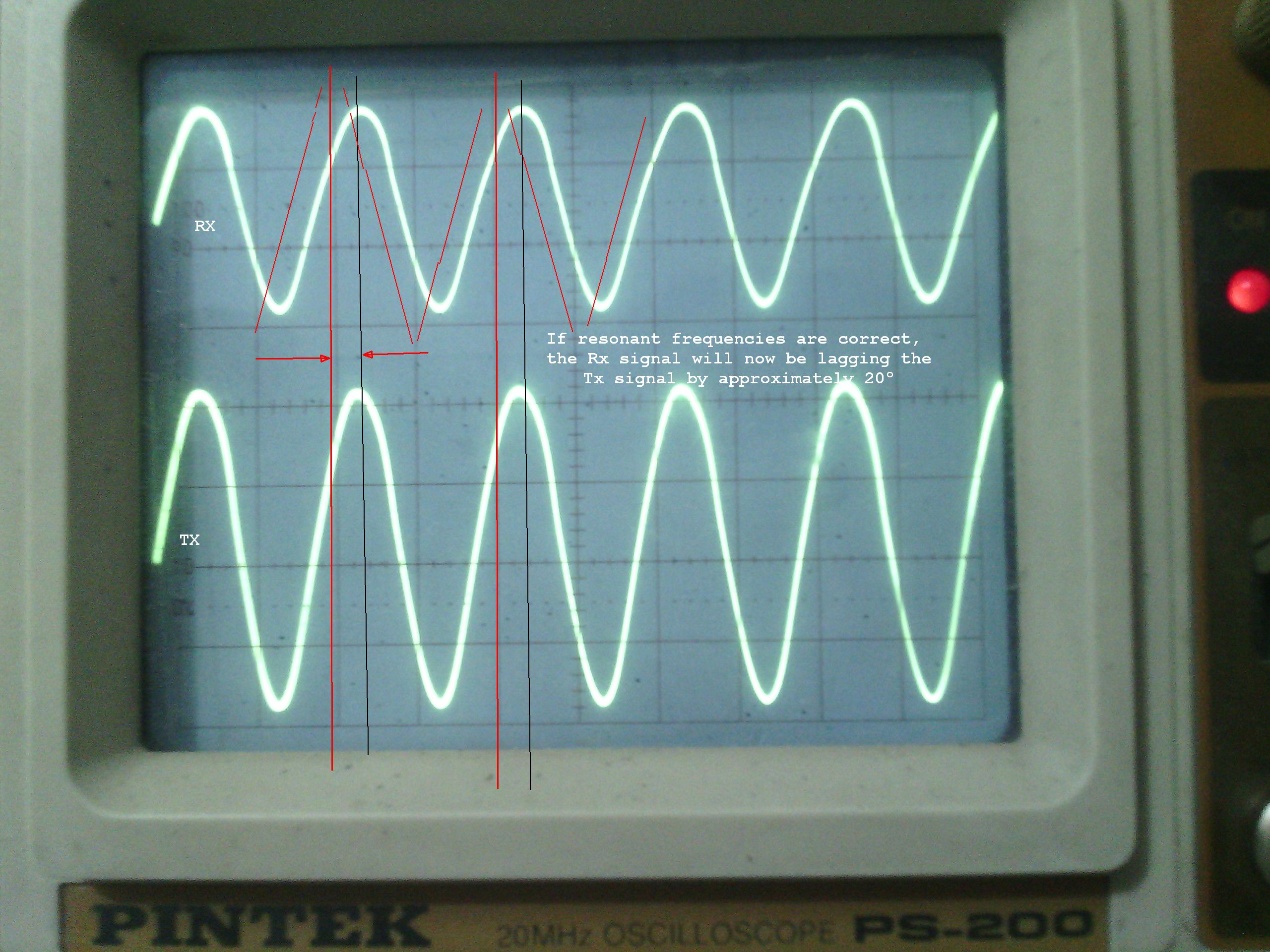

        A member asked me abt calibration of my oscilloscope and i didn't know anything about it. Attached are pictures of my oscilloscope in calibration mod with its knobs in respective positions for the experts to see what are its calibration settings and how these translate the waves from Tx and Rx of my silent TGSL. Thank you pplClick image for larger version

                        i hooked the probe as directed by you. my scope displays wave much widers than one big square. As i set it to 0.5mS then it is exactly one big square width.
                        Originally posted by rickb View Post
                        91 hz should not be present anywhere on the board. Either something is very wrong with the board or your scope is malfunctioning or seriously out of calibration. It is up to you to figure out which before you go further.
                        Most scopes have a 1Khz reference square wave terminal on the front panel. hook a probe to it and set the time-base switch to 1 ms/div. Each full cycle should be 1 major division. If not find out why before going further.
                        • #57
                          .5 ms per cycle is 2 KHz. very unusual but not impossible. Is the variable adjustment for the time base switch in the calibrate position? it should be.
                          Do you have a working transmit coil hooked up to the tx terminals. Is the gnd clip of the probe connected to the gnd terminal of the coil?
                          The tx freq is about 14 KHz or about 70 microseconds per division.

                            Rickb I will conduct fresh test and share pictures so you can look in to it. I am very thankful for your attention and response. stay with me
                            The tx freq is about 14 KHz or about 70 microseconds per division...............

                              TGSL 101
                              An introduction to the “Tesoro Golden Sabre Light”
                              page 19
                              If you have a dual trace oscilloscope, read on!
                              Advanced Nulling Methods
                              1. Connect the “A” channel of scope to U103 pin 5. - Set scope to DC setting.
                              2. Set the GB pot to the mid range position.
                              3. Start with coils apart and start to overlap.
                              4. Continue increasing overlap until the the D.C. Signal on Pin U103 pin 5 is 0 volts. Check the
                              phase relationship between J1-1 (Tx signal) against U101 pin 7 (Rx signal). If resonant
                              frequencies are correct, the Rx signal will now be lagging the Tx signal by approximately 20º .
