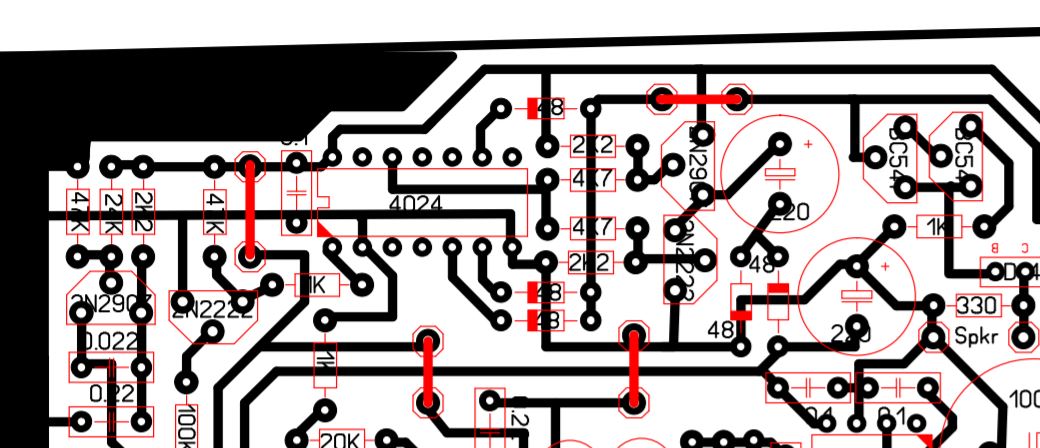

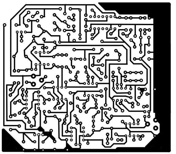

i made the board myself.

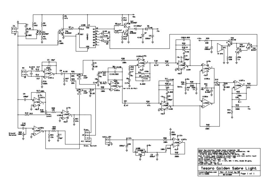

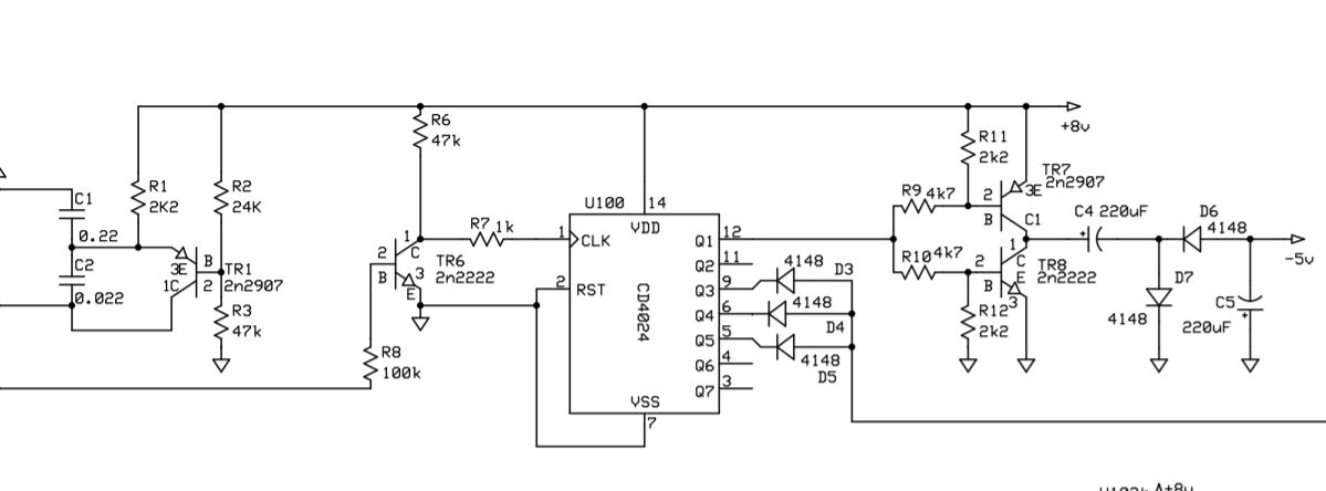

Here is view of the schematic i used now to compare. Its from this website.
Here is the part of schematic showing position of IC 4024

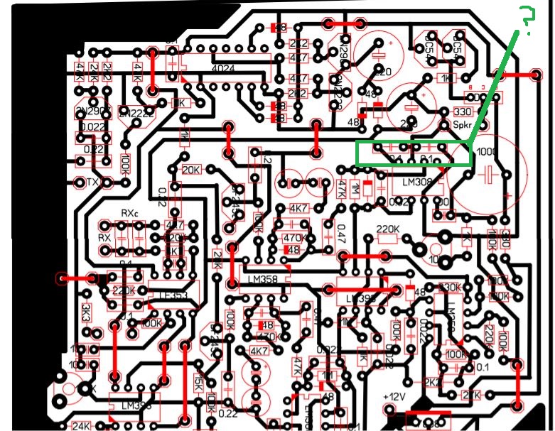

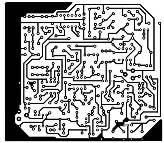

Here is the PCB design i used to make my board
Here is how position of 4024 was given in PCB design.

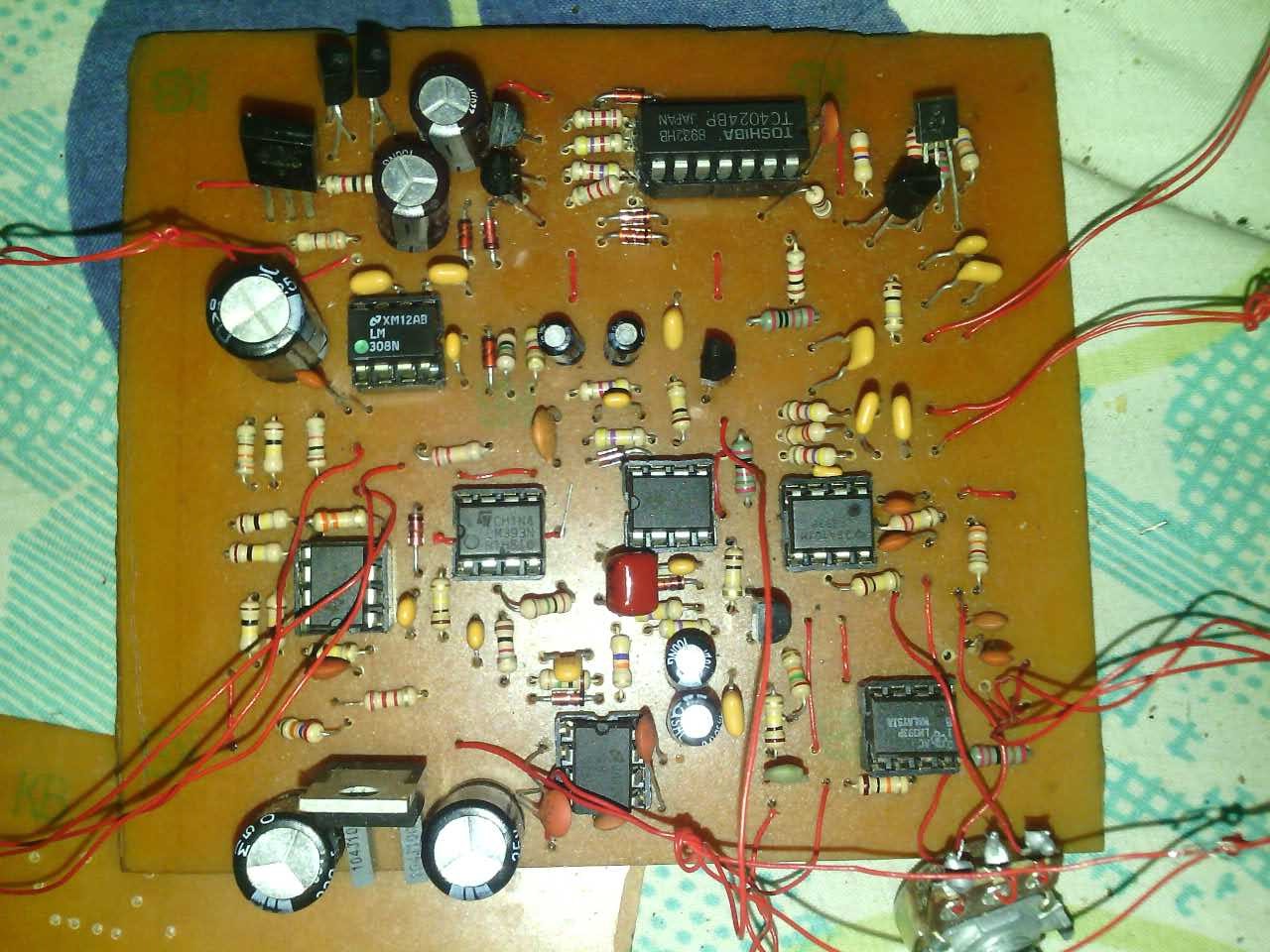

Here is my TGSL board
Compare the IC connections given in schematic with IC position given in PCB design and you will know. And this is illustration of just one IC. I have checked four so far and same is case with all four.Originally posted by rickb View PostI am having a hard time believing your responses. Did you solder parts to the copper side of the board? Front side? Show pictures before doing anything else.

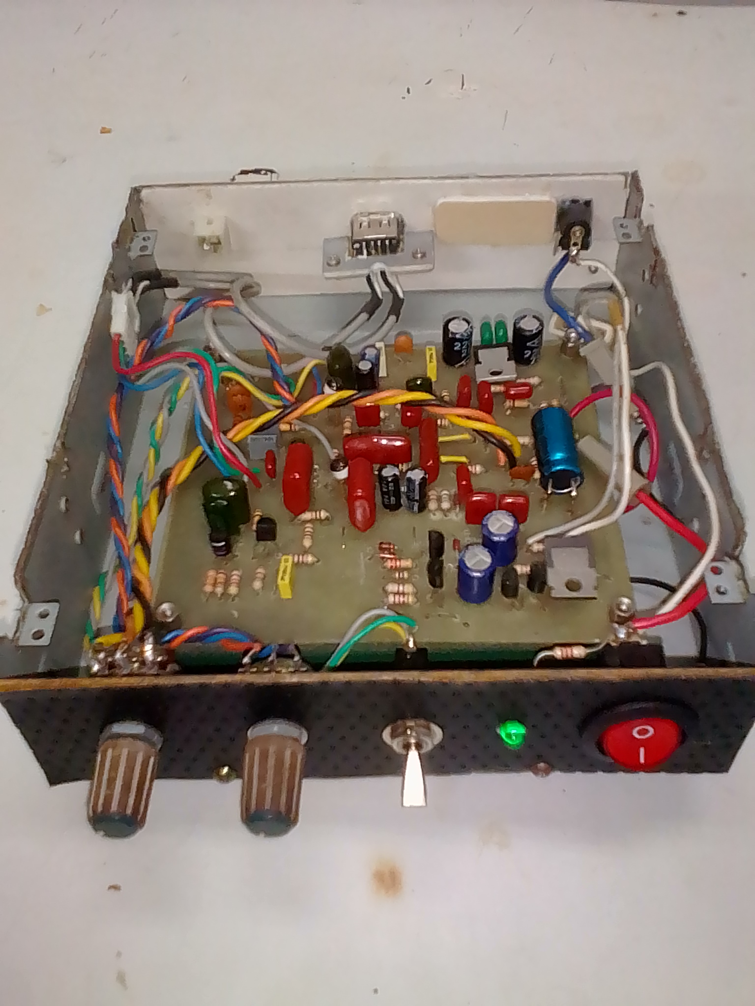

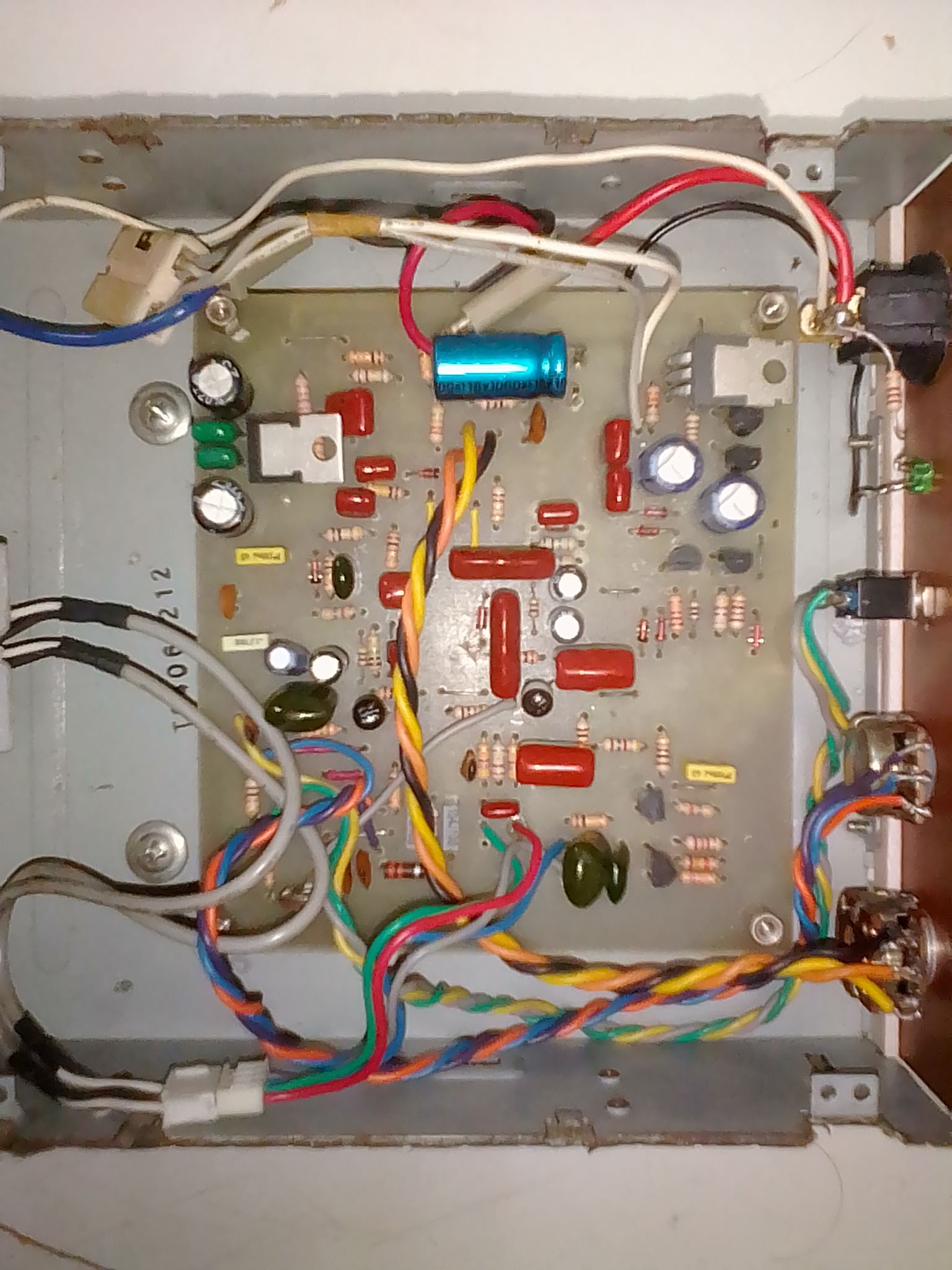

I made same mistake with my home made TGSL pcb. I didn't mirror the image when printing to CUPS. As soon as I took board out of ferric chloride, I saw my silly mistake and begin to cuss myself. But then I realized I could solder chip sockets to copper side of board and reverse legs of transistors and pay attention to diodes polarity etc.and I could solve problem. Other way is to bend legs of chips all the way to the other side. Now you will have fancy pcb that nobody but yourself can understand
So it is more common mistake than others will admit.
Here is my TGSL which works like it is demon from hell, finding deep targets.

. I have discovered this after reading the schematic. All IC are correctly positioned only if i solder them on solder side of the PCB and this has its own challenges so i will rather build a new PCB. If you have a tested and working TGSL pcb design (single sided without any SMD) then pplz share with me.
