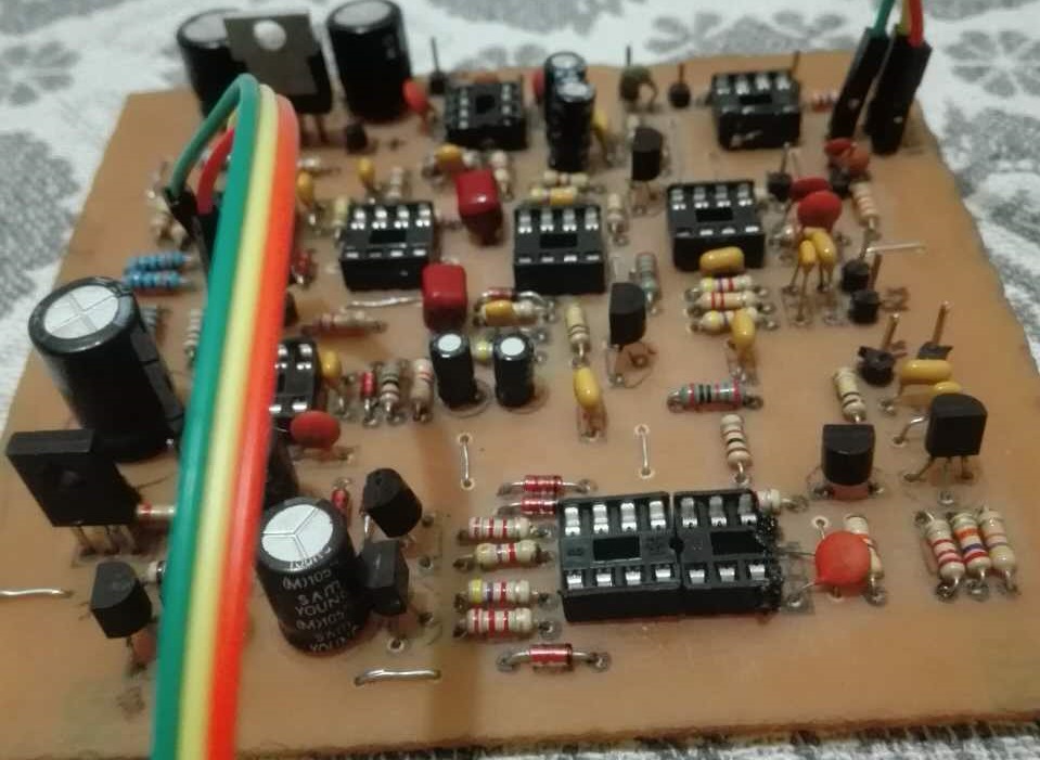

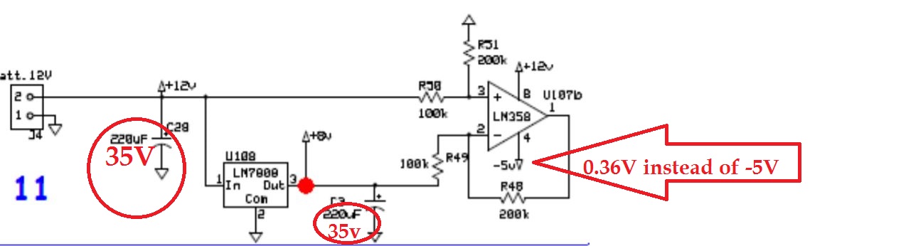

        Populated my second TGSL board today. Connected everything with it except coil but it is silent. Power is 13V DC.
        PROBLEM !
        The voltage on pin 4 of lm358 is 0.36V instead of -5V. How i correct this. My c3 and c28 is 220uf 35V.

        • #79
          PROBLEM !
          [ATTACH]43665[/ATTACH]
          NEVER run tgsl without coil!!!
          Connect Tx coil and check negative rail again
          • #80
            Fixed. Thank you for quick remedy. Why it is silent when every component and joint i fixed is more than perfect??

                  • #84
                    look on schematic. no TX coil - no generation. no generation - no negative voltage.

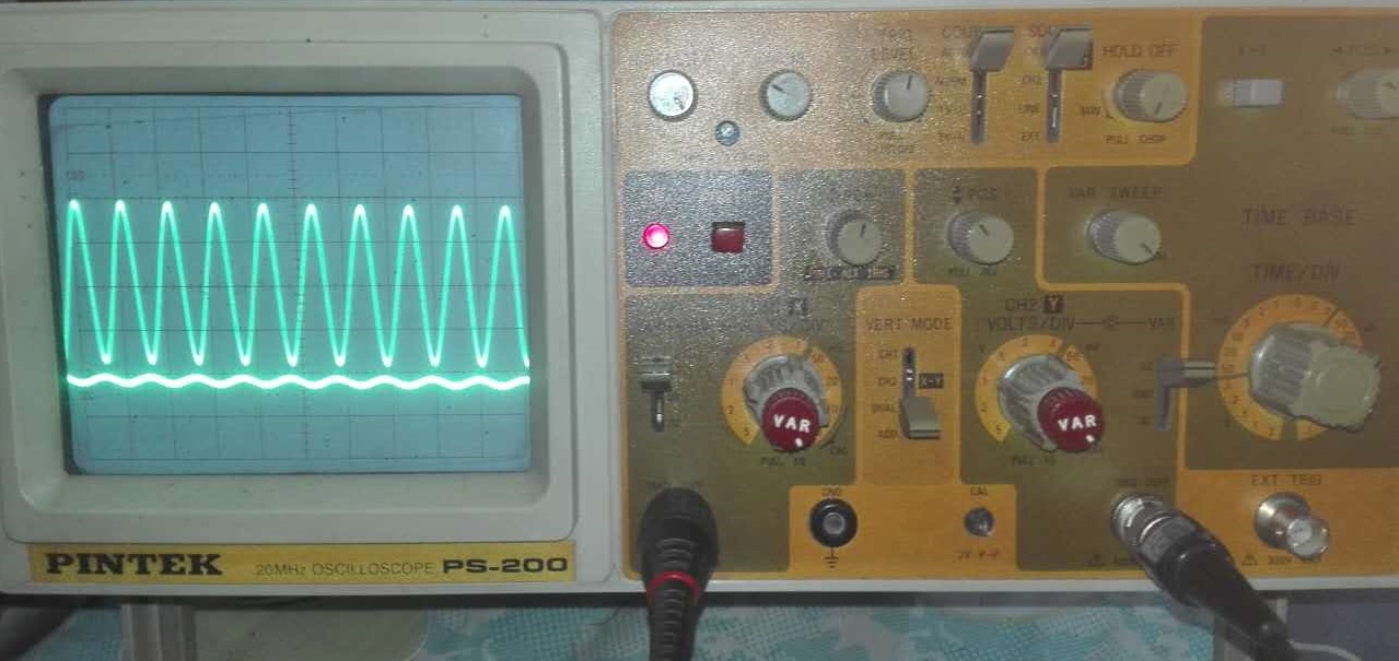

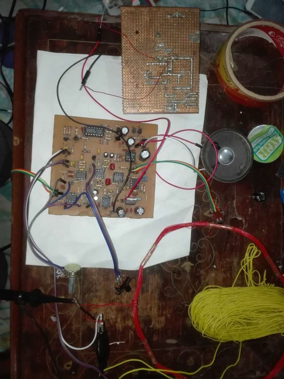

                        • #87

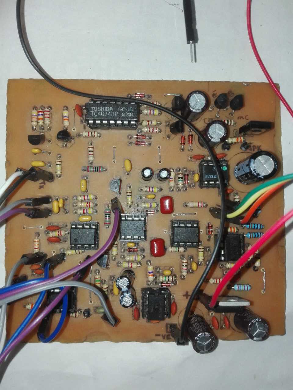

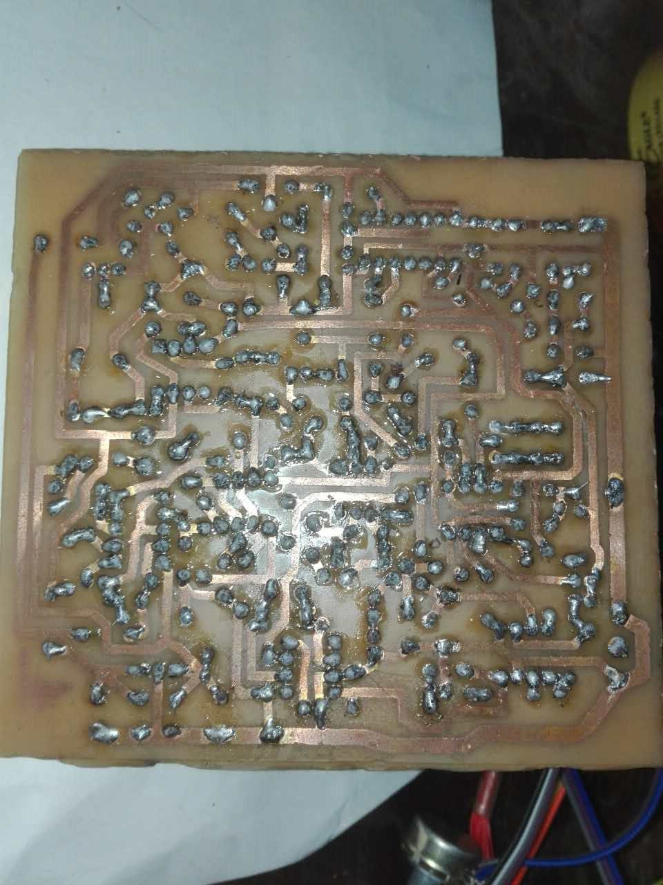

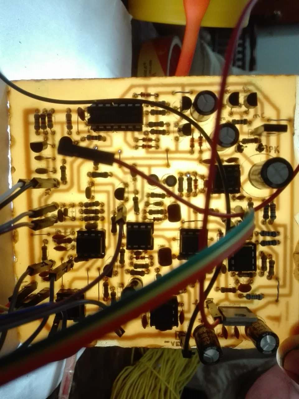

                          My TGSL is based on apberg's single side version. I am now using c3, c28 as 220uf 25v instead of 220uf 35v. After i attached a makeshift coil it is giving a beep if i attach any pot wire or oscilloscope probes. Mostly it is beeping very faint. I can see the Tx wave change with hovering of metal objects or movement of Tx coil (time/div knob set at 20uS; Volt per div knob at 1V. The voltage on Tx coil are 7.35v; same knob position as Tx. There are some milliVolts on Rx. The voltage on pin 4 of lm358 is -6.42v. Ground balance pot makes sound on connection and works towards one end of the the pot turn. The discrimination switch, sensitivity, discrimination pots sound on connection but nothing translates on scope.

                          • #88
                            Now that's what I'm talking about! Great job Chu! You did work very hard In short time to redo the whole thing.
                            If you have beep, then the circuit is good.
                            The only thing left is to put proper coil and tune everything.
                            But before you do this, here are a few things to know in general.

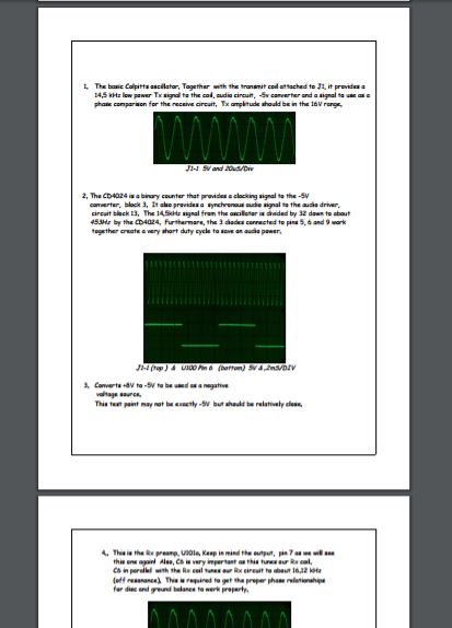

                              Is this the build document ?
                              ........... Do you have the Build document?.....................................
