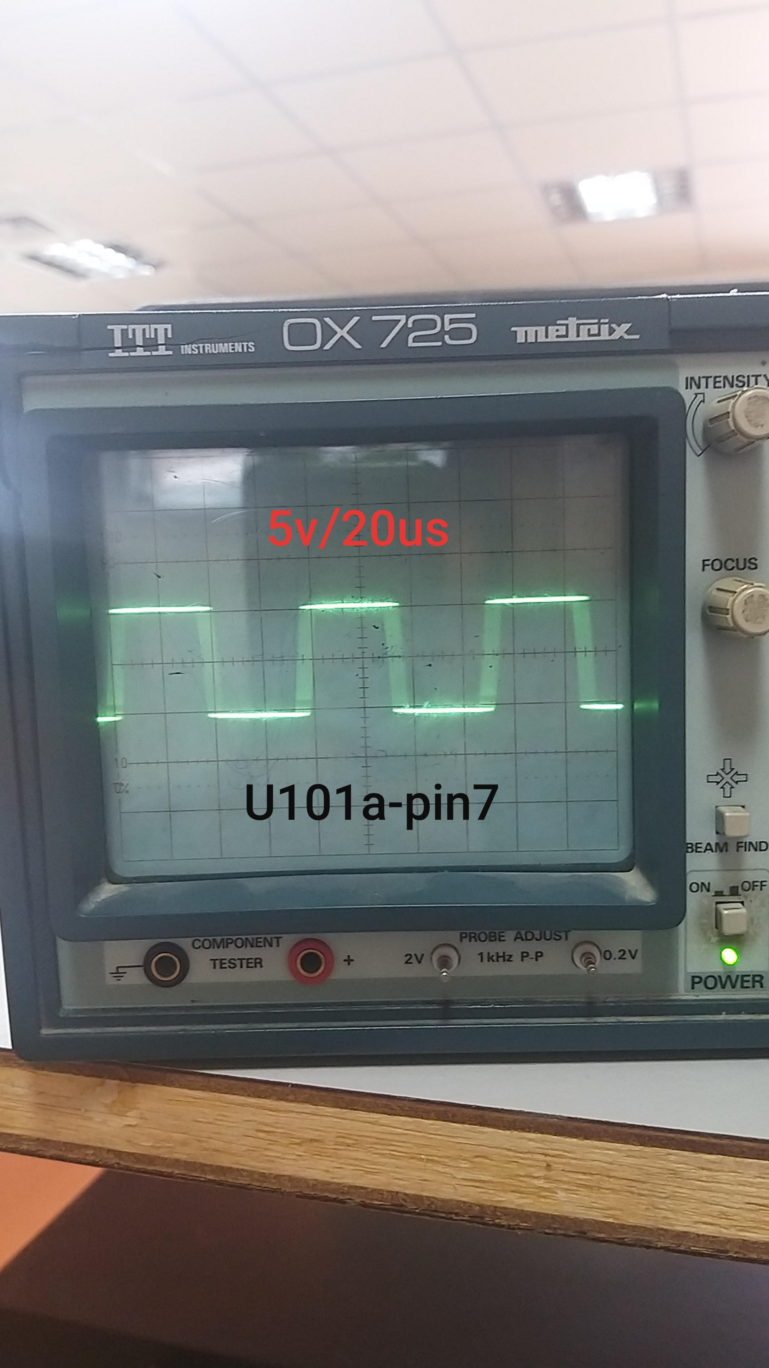

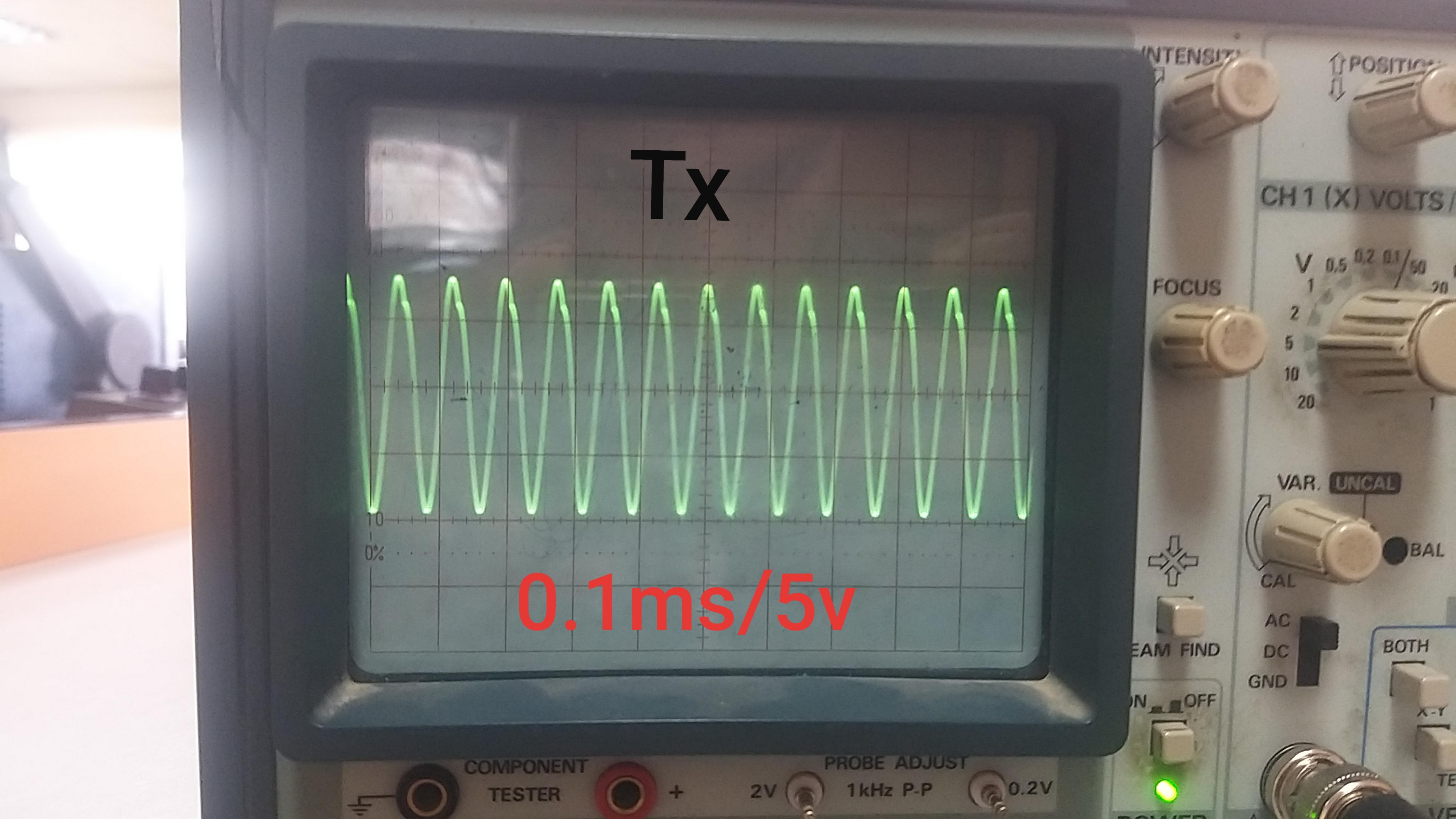

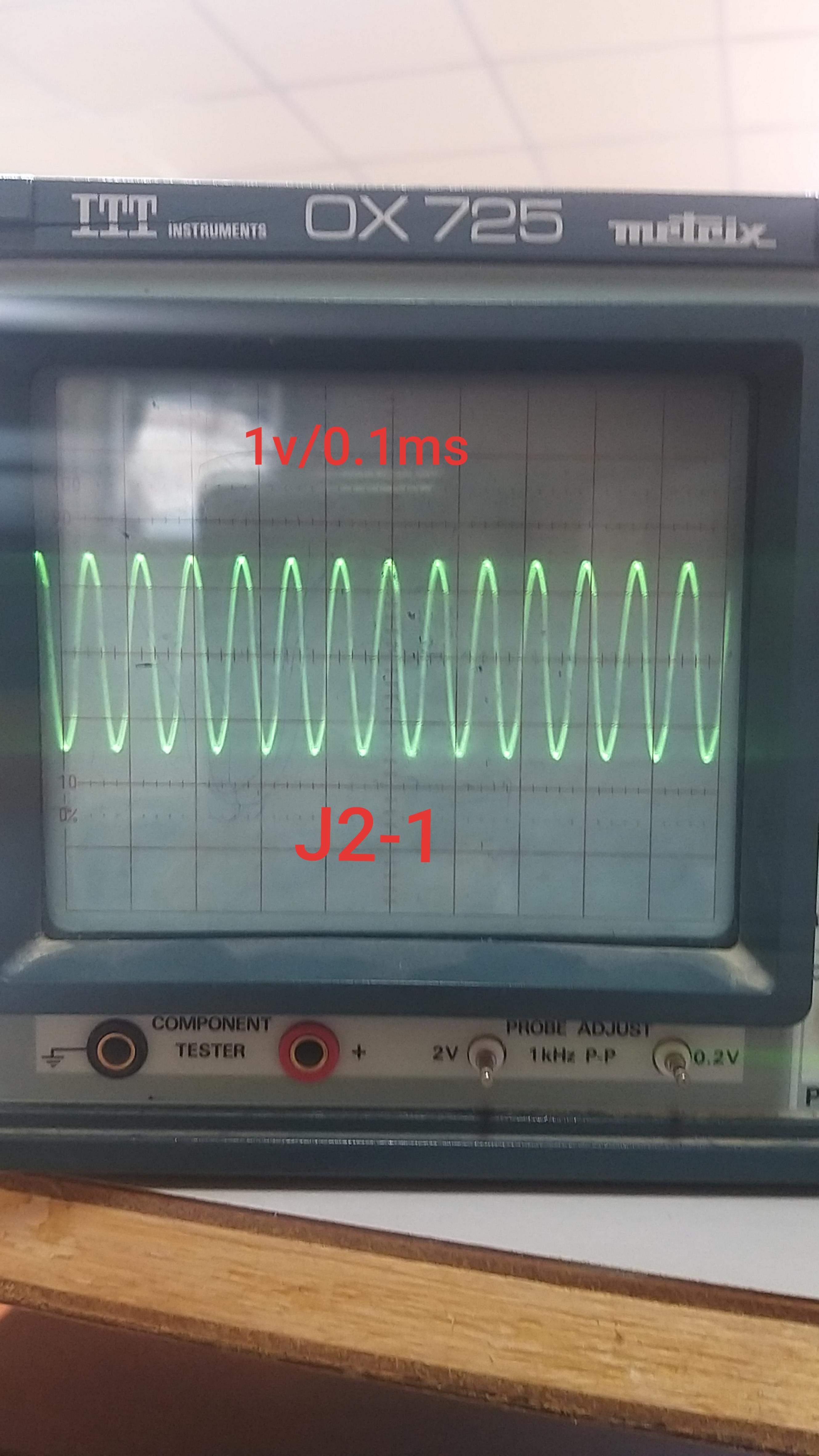

                    Oki this what I did, first I removed some turns from Tx because the inductance wasn't correct, then while I was measuring U101a-pin7 I gradually removed turns from bucking coil until I reached 15mv ~ ,but I don't know why Rx waveform looks ugly, anyway even though that I'm so close from nulling and Tx is almost 14.3khz but still there is no reaction from the device at all when I move a target or touch anything.
                      The wave forms look fine. RX is noisy due to electrical noise in you shop. My RX signal looks worse than that but TGSL works great.
                      I have read that with a concentric the RX phase shift is about 200 degrees.
                      Again use both channels of your scope to compare when the FET switches turn on relative to the TX and/or RX signal phase.
                      Next is check the outputs of the next two amps, U103 pins 1 & 7, then U104-6 & U105-7.
                      These should be very near to Zero Voltages.
                      Did you try All Metal Mode?
                      I am guessing it still beeps when powered on.
                      It did take me a while of fiddling to get my TGSL working. Keep at it.
