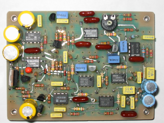

    hi Leto
    can you send me on e-mail your pcb board schemtatic with fixed all mistakes and some fotos of wiring. i have my one silver sabre original but made in surfice technology so i would like to make your project. my e-mail is [email protected] thanks

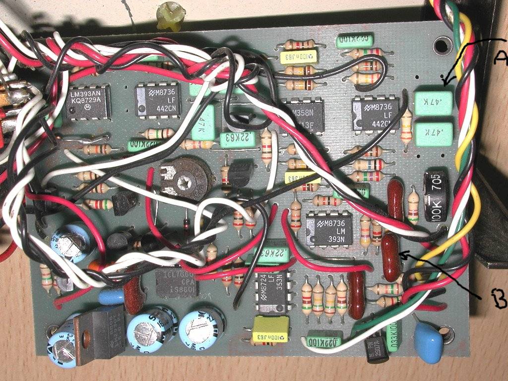

        help silver sabre
        I need help as the attack on the mother board wires, potentiometer, Swick, plate I attach a photo if someone can help me, I leto that Hamlet has my same instrument

              hello all, finally someone who could help me to run the old silver saber, if I can I attach the plate, though some experts indicate how I can reattach all the wires from the potentiometer disc. sens to the potentiometer, the swich, and plate, including power, thanks to all alex

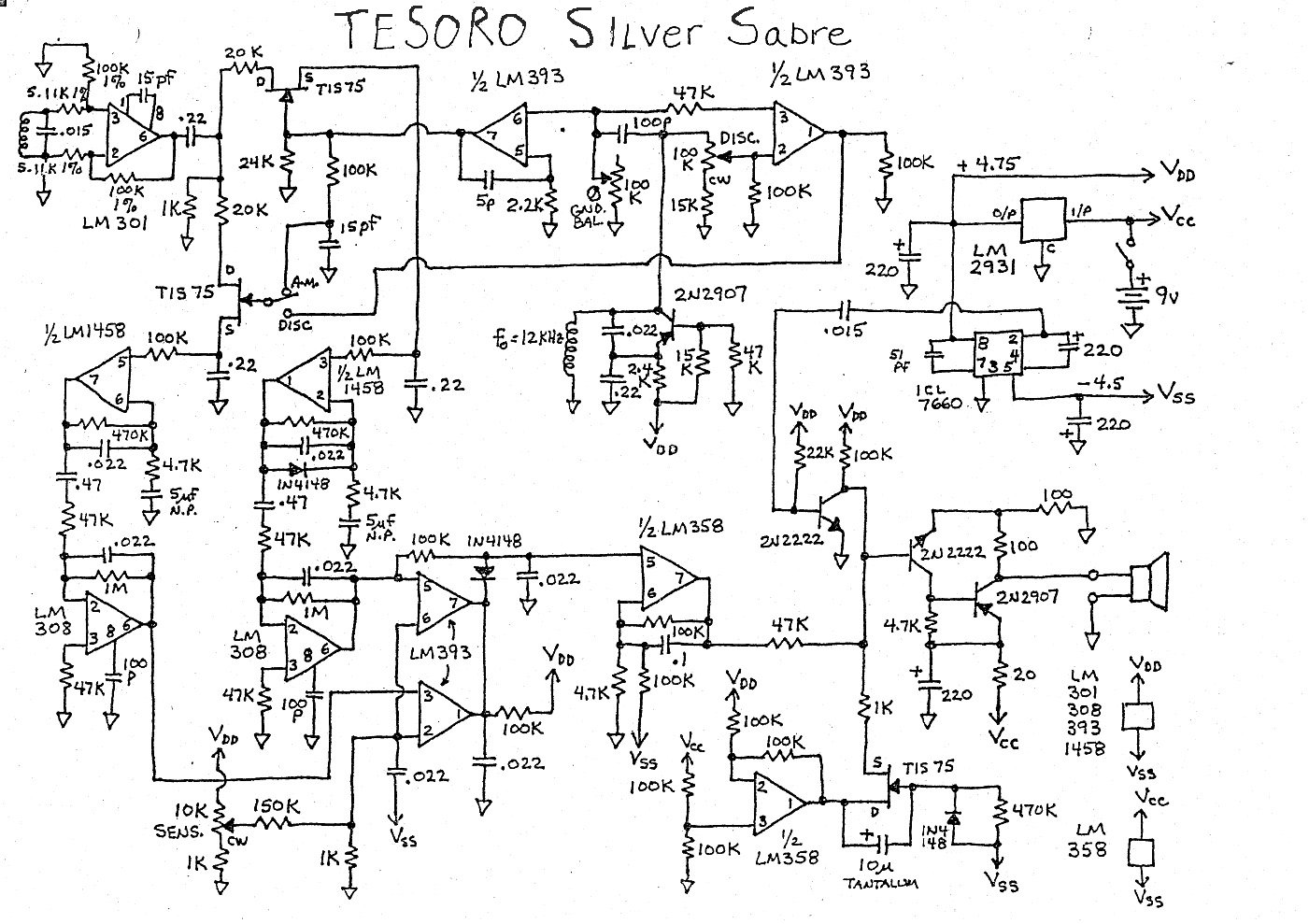

              • #52
                This looks like it may be the correct schematic for your board. Sorry, but I don't know where exactly to tell you to make connections without having
                access to the back of your board. (And NO, I don't have time for that anyway.)
                I've found a few likely areas to help you get started. You'll have to work out the details and also find DISC, AM/DISC, SENS and
                whatever else I may have overlooked.
